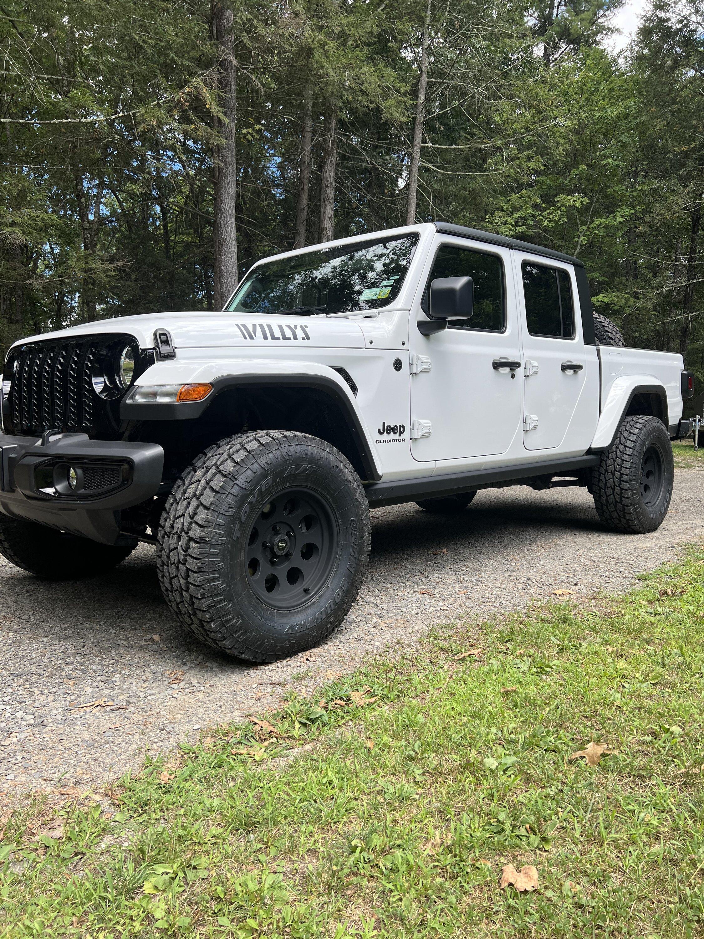

Picked up my gladiator with lift and 35s today. The ride is ever so slightly stiffer. 35s are actually quieter than the stock firestone destination MT. I don’t really notice much of a difference as far as acceleration and gas mileage on the 3.73 gears and only dropped between. 1-2 mpg. Drove 100 plus miles today and averaged 20mpg with a mix of highway and city.
