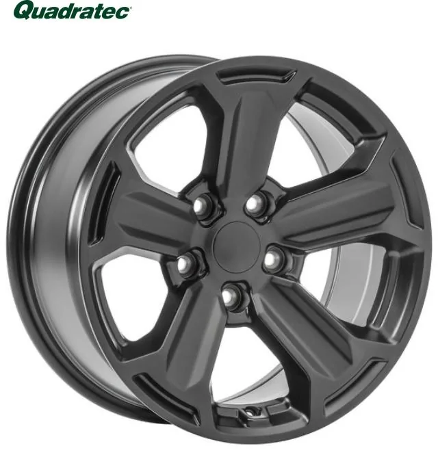

Anyone have experience with the 17x8.5 5.2" backspacing Mopar wheels? Part 77072470AB.
I'm between these or the Warn Moonsault wheels which are 4.75" backspacing.
Looking to slap some 315/70r17 tires on my inbound Mojave.
Thanks for any insight.

I cannot comment on fitting, but aesthetically I would choose the Warn wheels. I am bias however, I purchased a set of Jackhammer’s for my JT on order.

That Mopar wheel is identical in spec to the Quadratec Jeep copy wheels that a lot of people use, including me. It’s very similar in appearance to the Recon. They work well for up to a 35 on a Sport/Overland, and a 37 on a Rubicon/Mojave/Max Tow (as long as you haven’t switched to a straight control arm, and with appropriate lift). The QT wheel is quite a bit less expensive.
