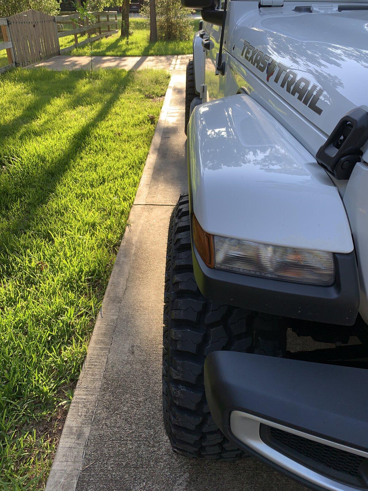

I have 5.2 bs wheels on my jt using a 35/12.50/17 tire
No rubbing at all
Jeep Gladiator 5.2” backspace with Lifts.  Does it rub? 85F69674-0977-4C5E-8B34-BF0A7C625835

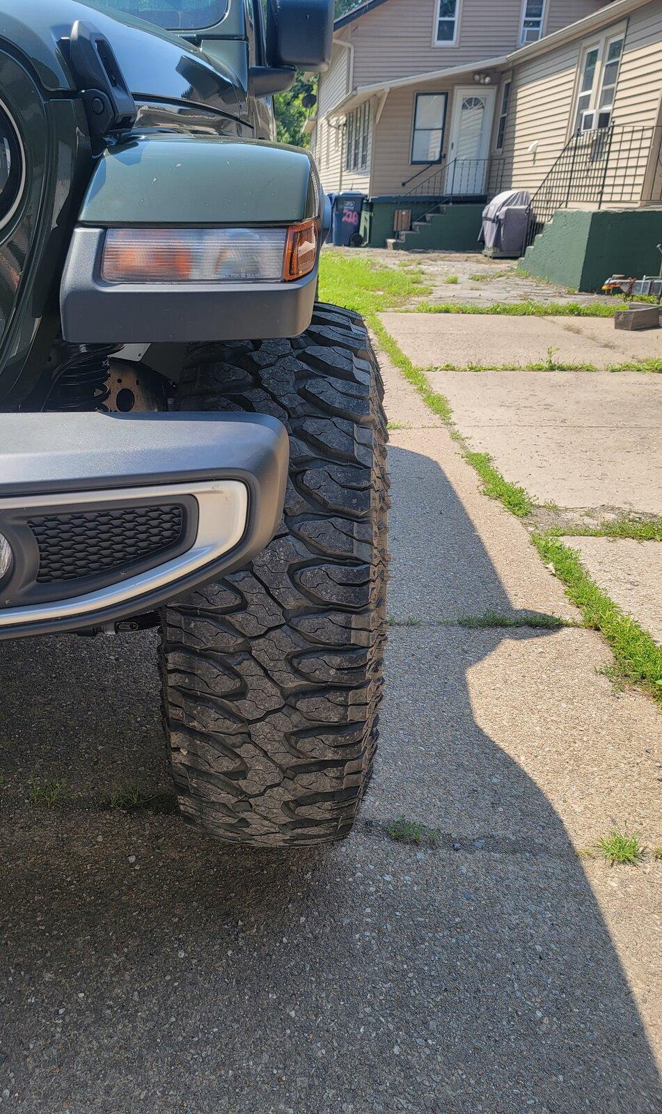

My AEV Pintlers (5.77" BS) rub on the lower control arms of my 3.5 Clayton Overland lift with 37x12.5 R17 Nitto Ridge Grapplers. I think a 35 with 5.2" would clear, but 37 may still rub.

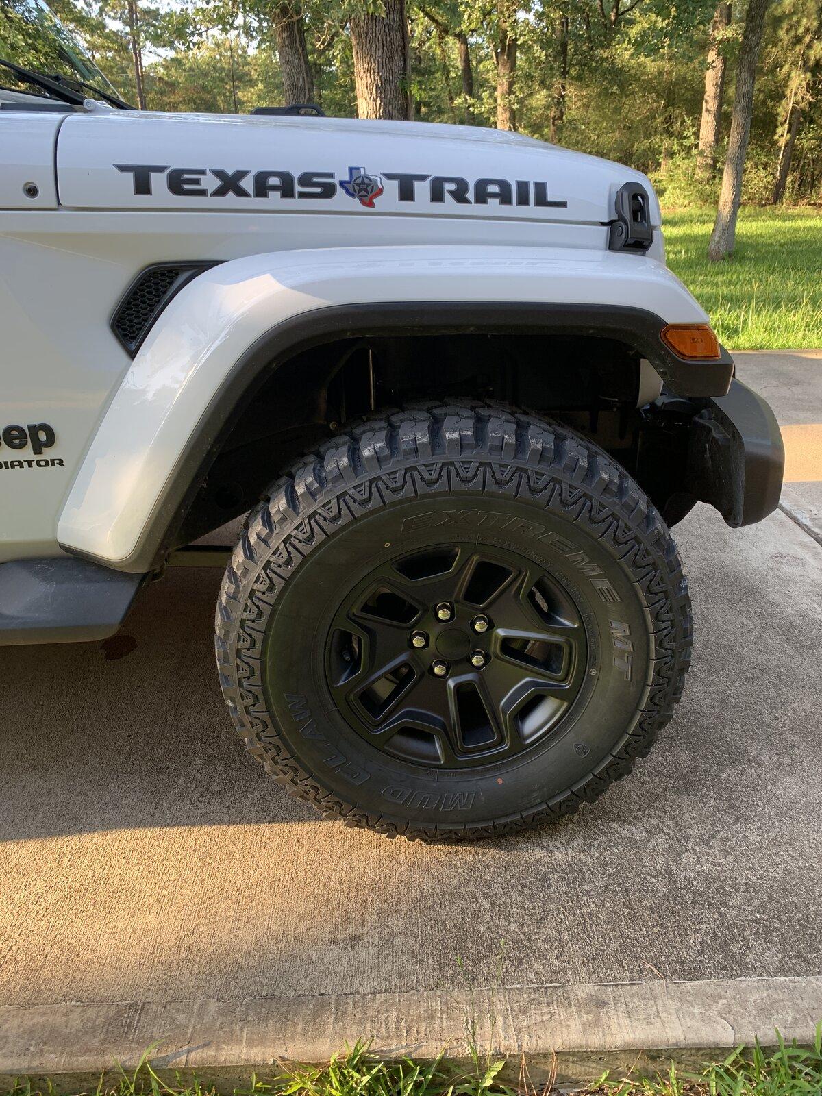

I have 3.96 or -20 8.5" wide wheels with 40x13.5 R17 and have zero rubbing lock to lock with a 4.5" inch lift
I wouldn't go less than 4.75
