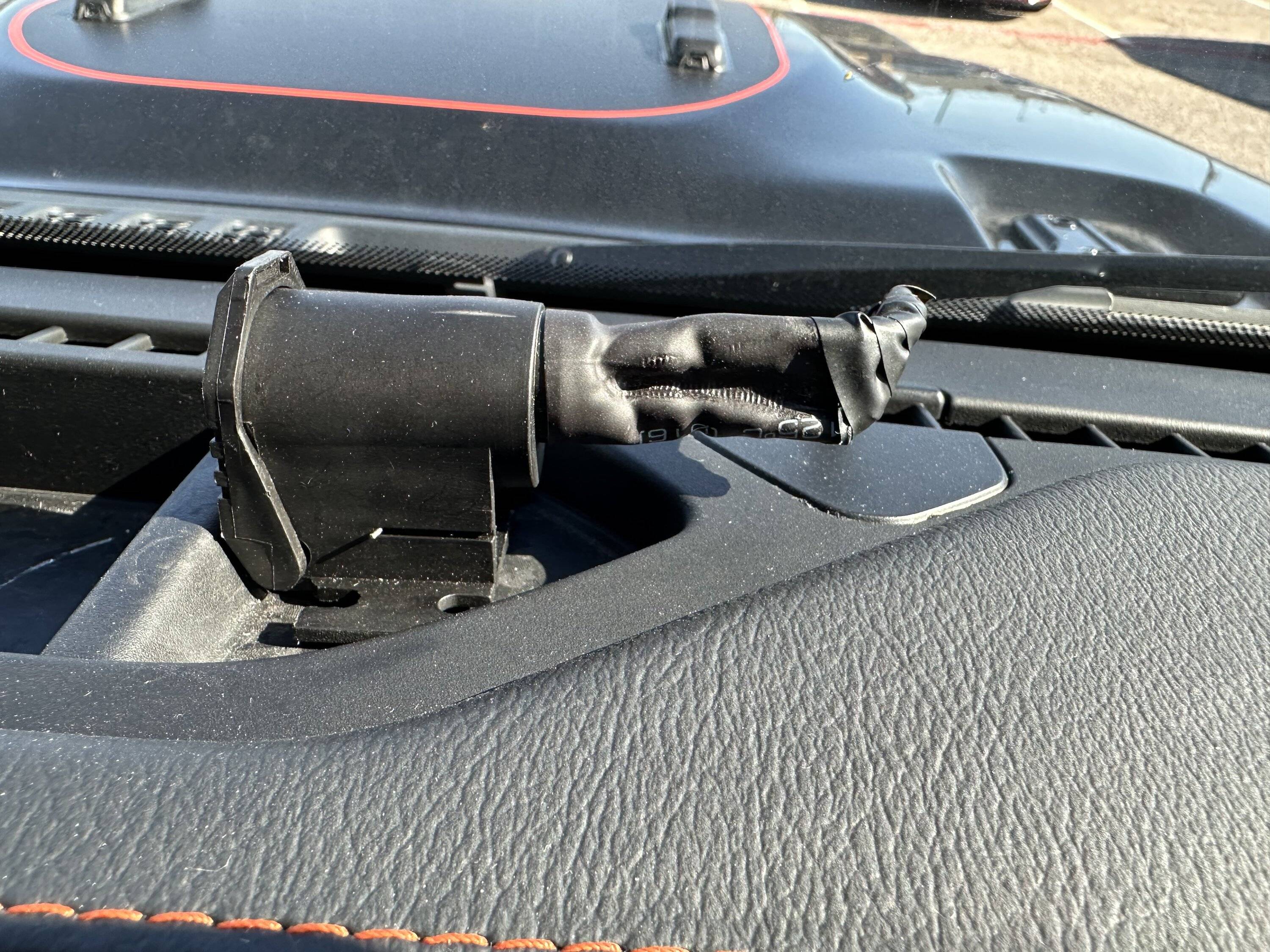

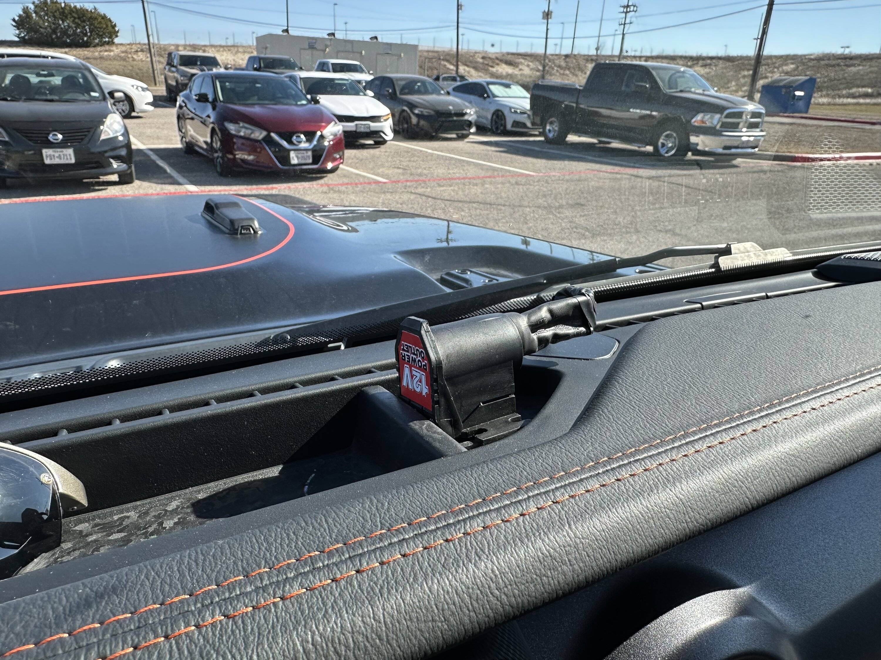

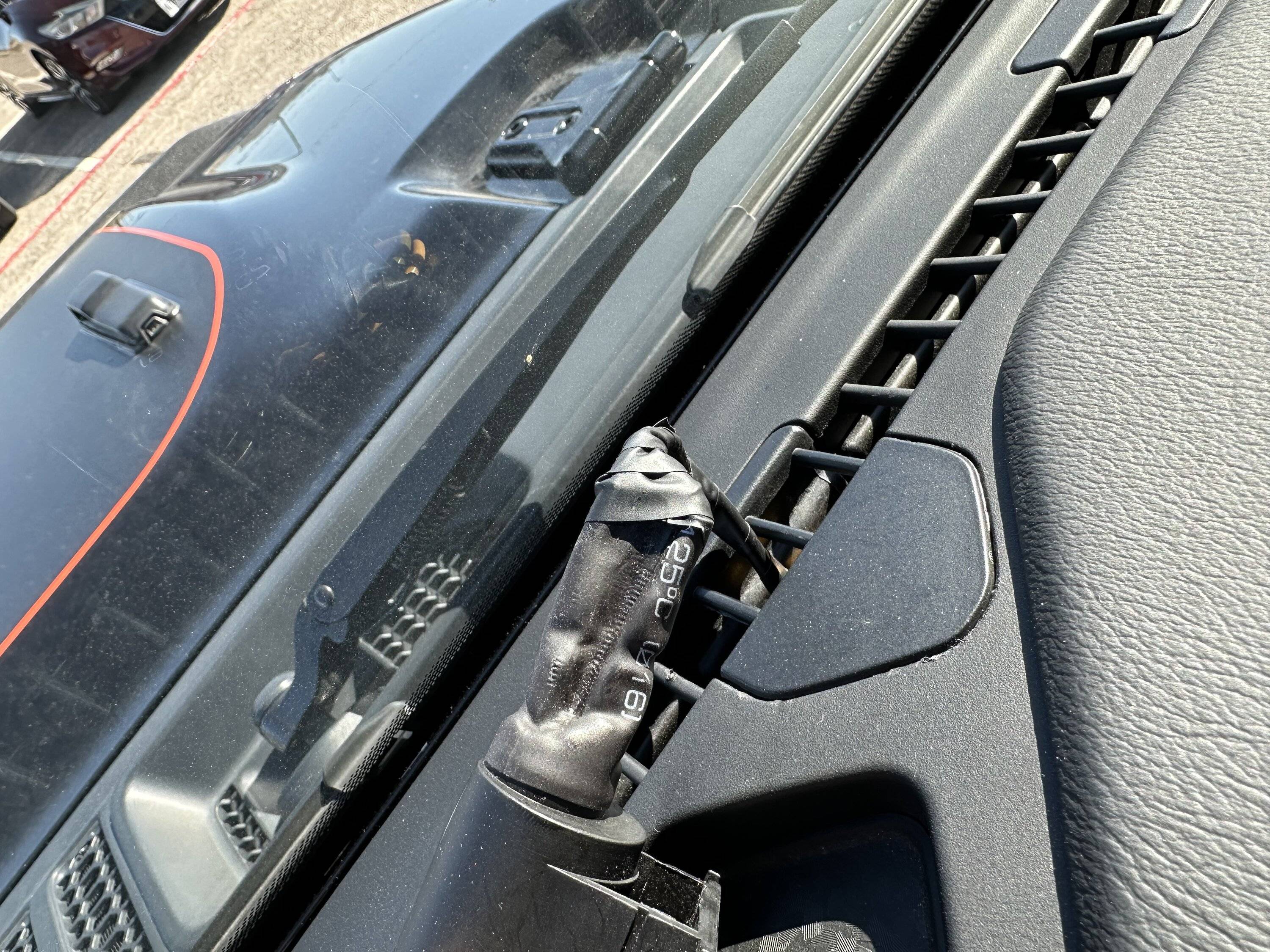

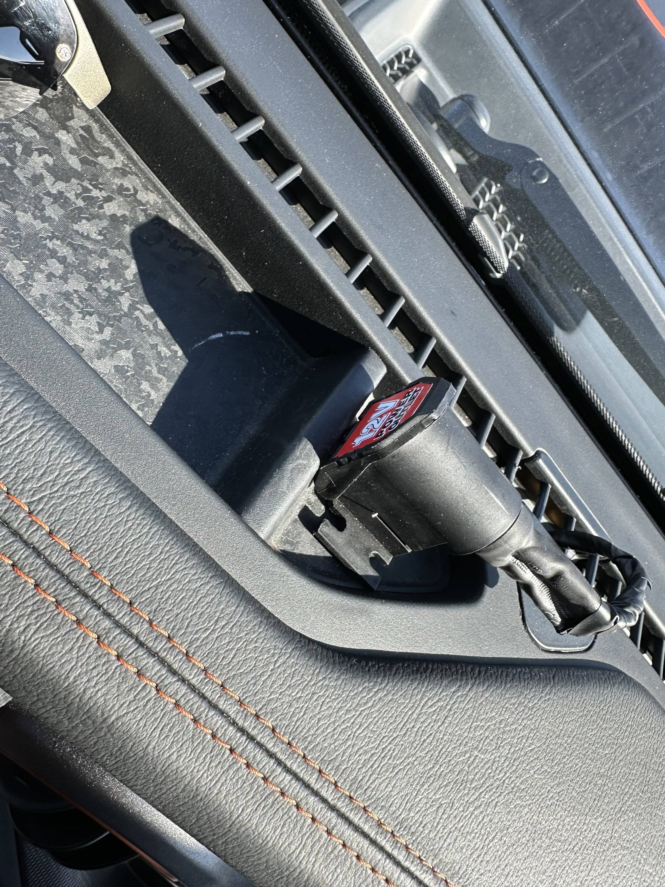

I wanted to maintain my factory warranty and the Jeep guys are like some Harley dealers, they want to install their parts or they can make it extremely difficult to get warranty work completed. After doing some things ShawdowPapa suggested it looks like the is the module but the knob. Nothing to do with the wiring either but in reality a poor design on the knob in my opinion. I did maintain my 12 volt plug capacity as I moved it to the top of my dash and I like there a lot better than where it was located previously. I found the 12 volt receptacle at Loves truck stop and wired into one of the aux switches using the wiring harness located on the passenger side. I will take a picture later and post.

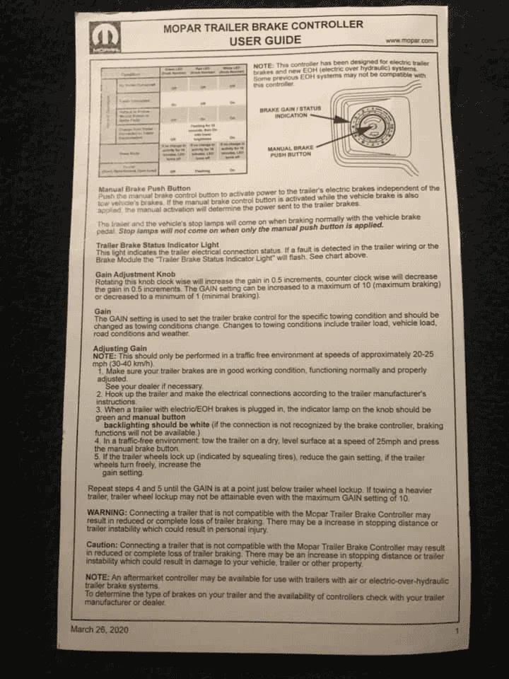

Wait, the button is not any kind of on off but is the emergency or trailer brake only button, when towing if you get into a trailer sway situation hitting that button will activate just the trailer brakes and straighten the trailer behind the tow….Jack

I did this from my phone the pictures are posted above, this was my 12 volt relocation I mentioned earlier.

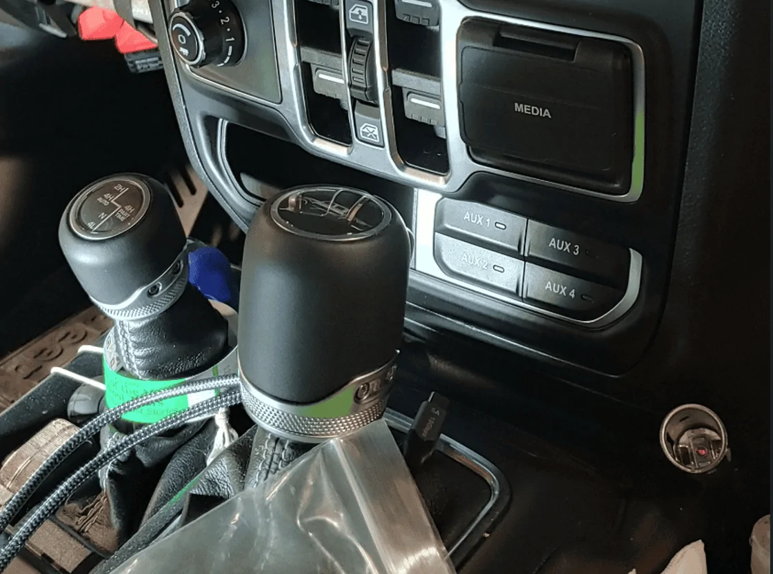

Just need some sort of small housing for it to mount it here........
