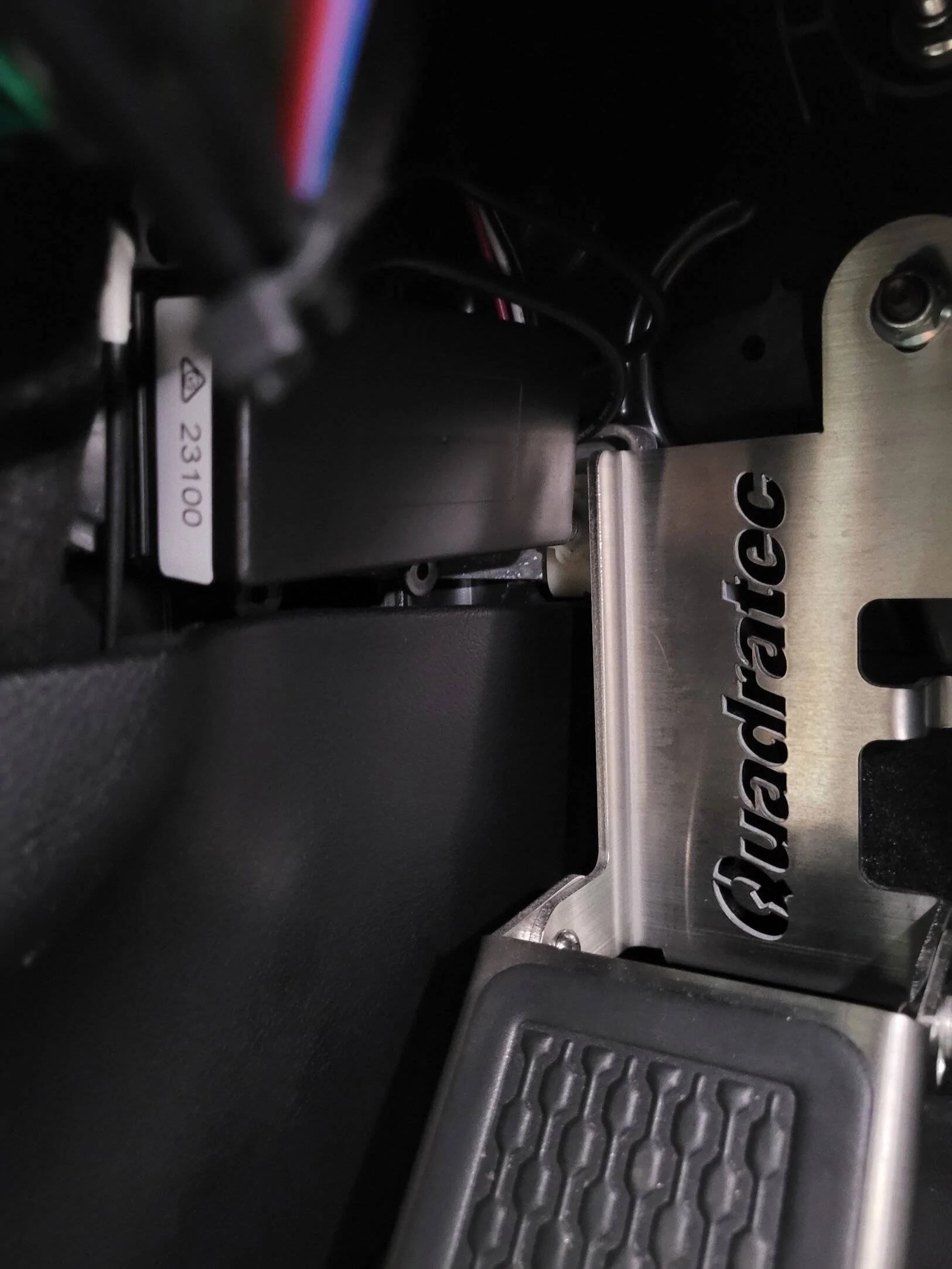

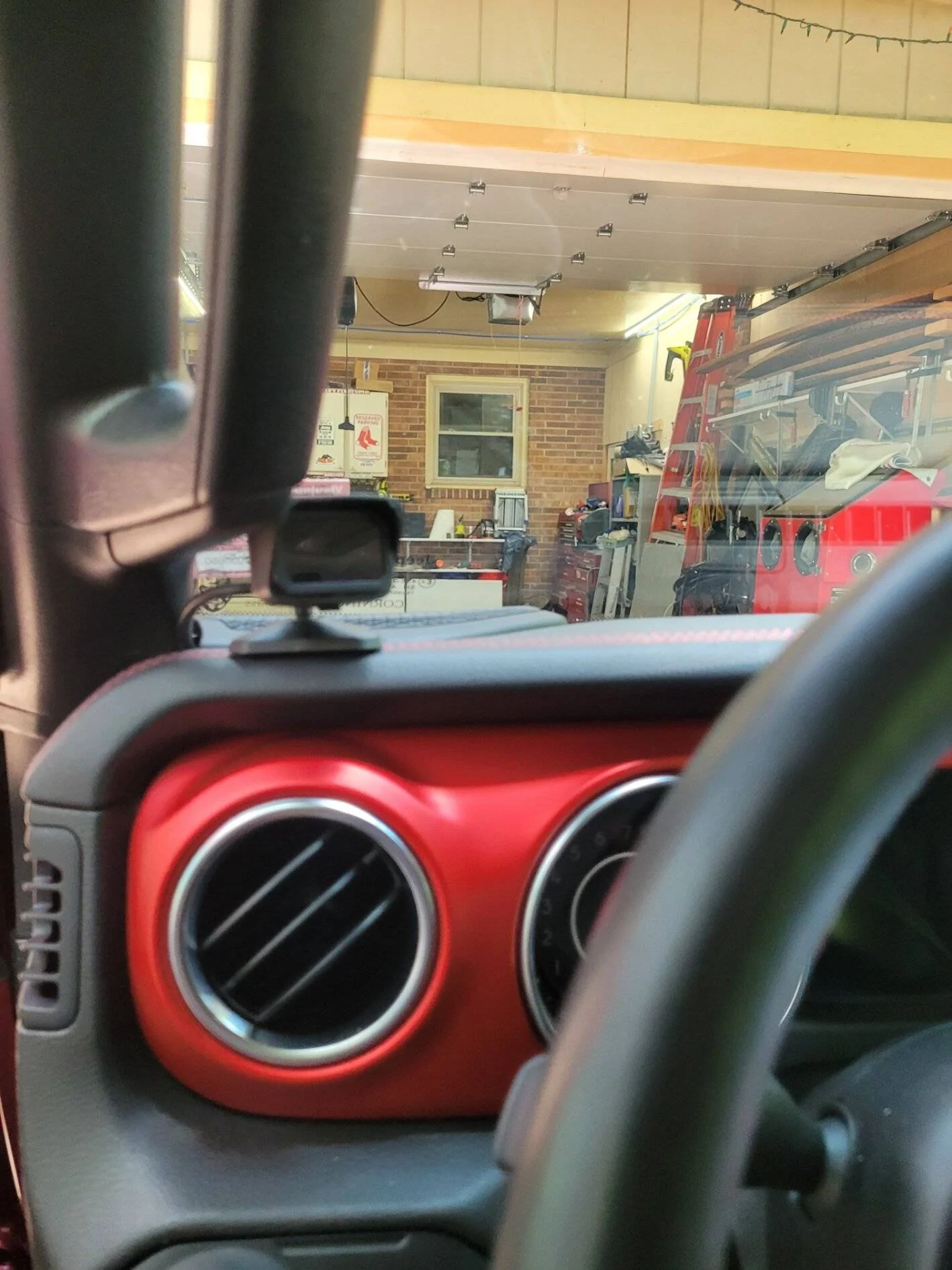

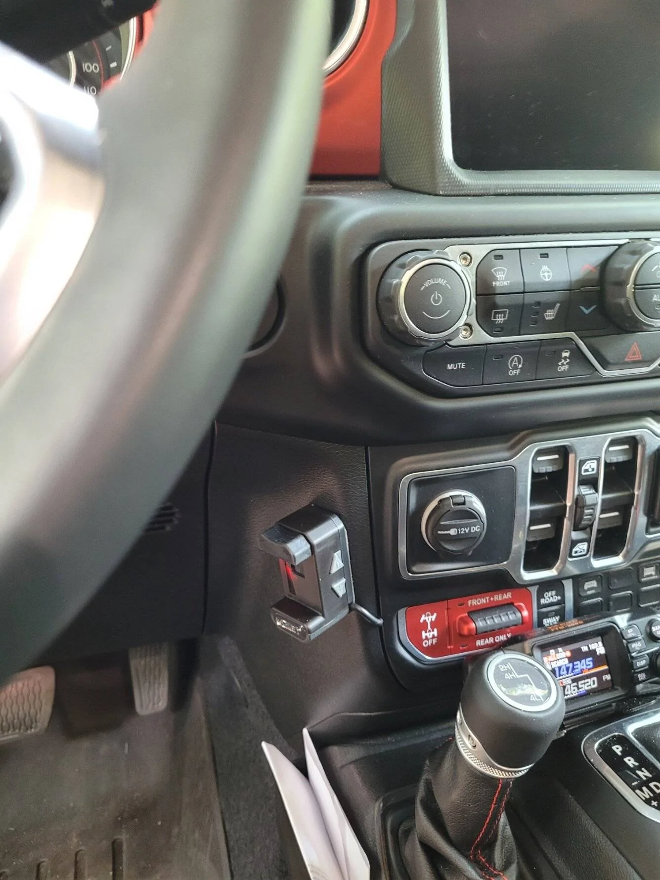

I went with the Hopkins Towing Solutions 47297 INSIGHT Plug-in Simple Brake Control , Black from Amazon along with the Tekonsha cable (I had to change the controller box end but Hopkins supplied that with the controller). I ran this one in my Grand Cherokee and it works well. I like the remote display that can be mounted anywhere and the manual brake and boost adjust is a separate box that can also be mounted anywhere. The actual box is mounted against the drivers kick panel up under the dash.
I put the display on the dash by the drivers A pillar and the controls under the start button next to the cigar lighter outlet.
Jeep Gladiator Mopar brake controller worth it? Hopkins Remote display
Jeep Gladiator Mopar brake controller worth it? Hopkins Manual box
Jeep Gladiator Mopar brake controller worth it? Hopkins control box

What radio is that you have mounted? Very clean.
Yaesu FTM200 and thank you. It needed to be someplace where my wife wouldn't object to and accessible. It worked out well.

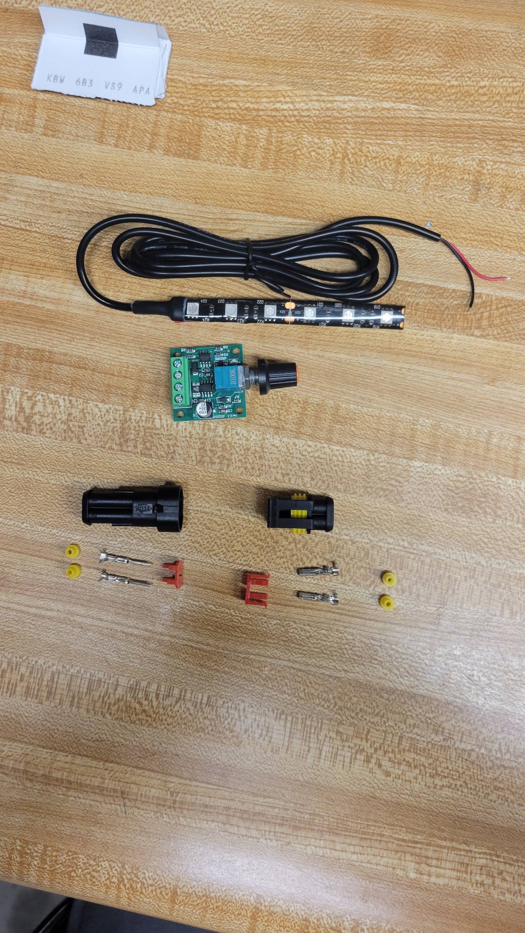

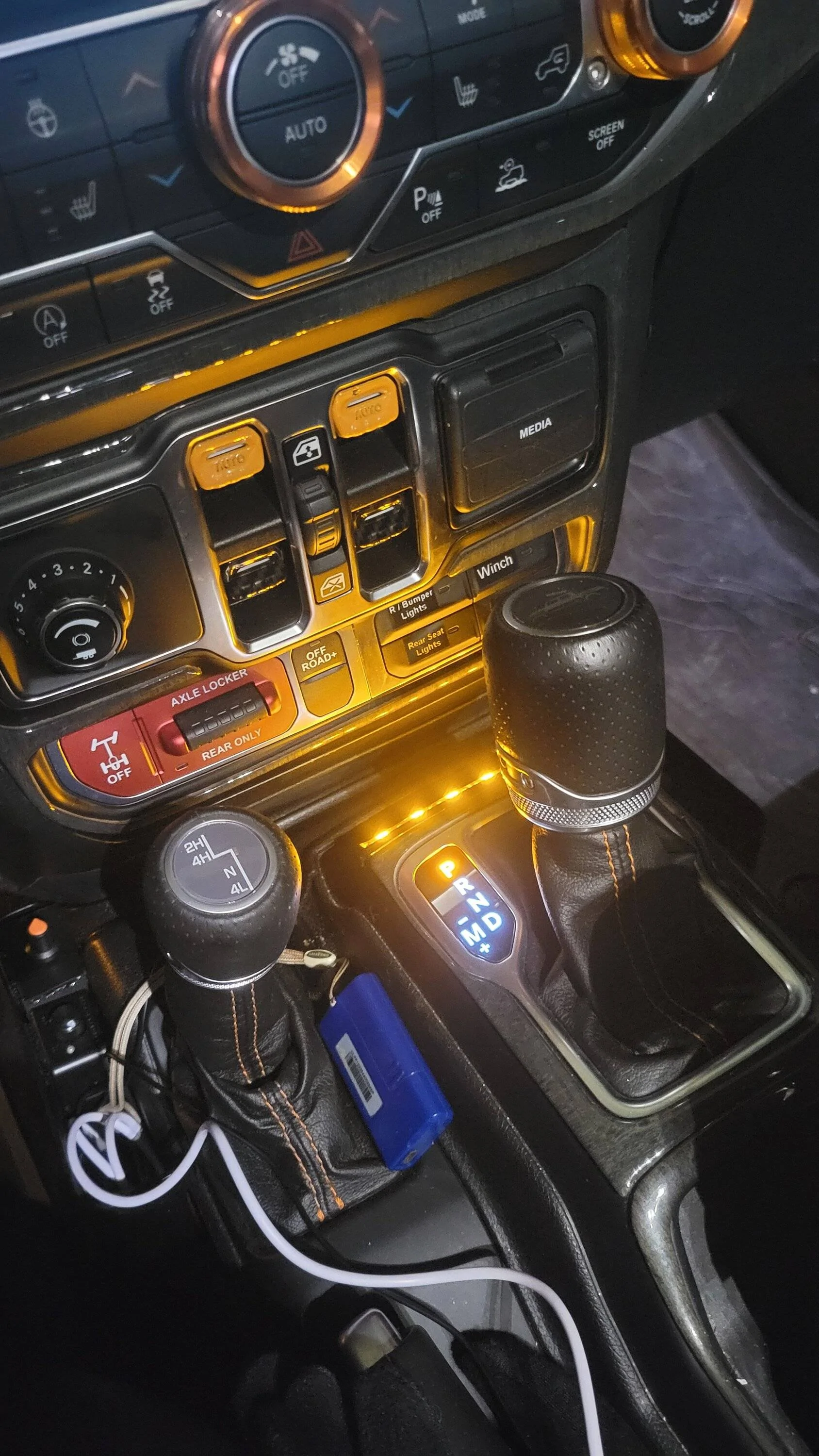

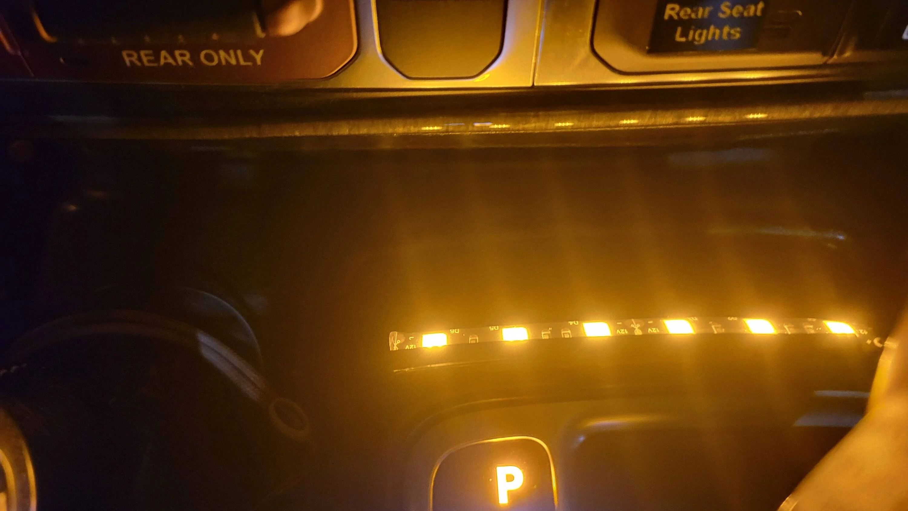

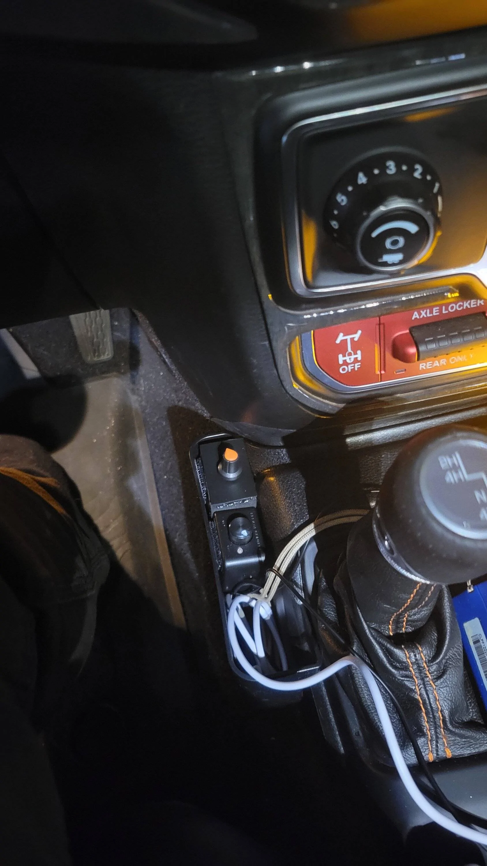

I’d love a picture of that setup.
Here you go . I wired everything with these connectors so if anything ends to be removed like the center console it can be unclipped and not having to cut wires . The top of the Pic is the 4" led (bought at Ebay same with the dimmer switch..they called it a variable motor speed controller) second item is the controller or dimmer switch and last is the connectors I used . I have the switch ( orange knob ) fitted in one of those front console pockets you can pick up anywhere and drilled a hole in the front to get the wires into the pocket. The other thing you see is my bass booster controller. The Pic with the light on is on the lowest setting so it can get very bright ! And you can still get to that trap door at the front of the shifter.
