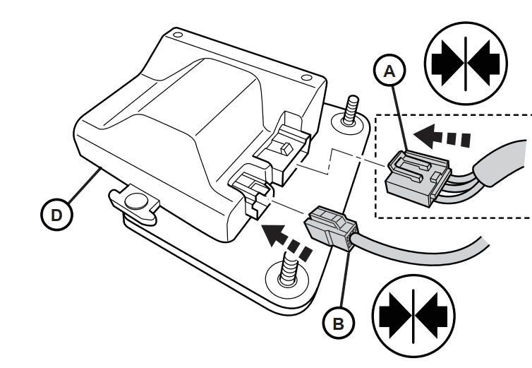

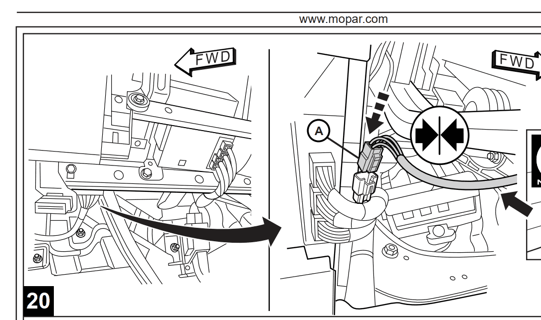

I have the installation document - there's one connector for the truck. The other goes from the "box" under the dash over to the control knob you install where the 12v outlet was removed.
Jeep Gladiator Mopar Brake Controller not compatible? 1716480621036-t5
In this - A goes to the truck harness and B goes to the knob in the dash. (A shows 3 wires but there's 4 in that cable)
Jeep Gladiator Mopar Brake Controller not compatible? 1716480824863-yk
I wonder sometimes if these dealer guys get stuck on installing things for RAM trucks and so on - and have no experience with the controller in a JEEP?!?
