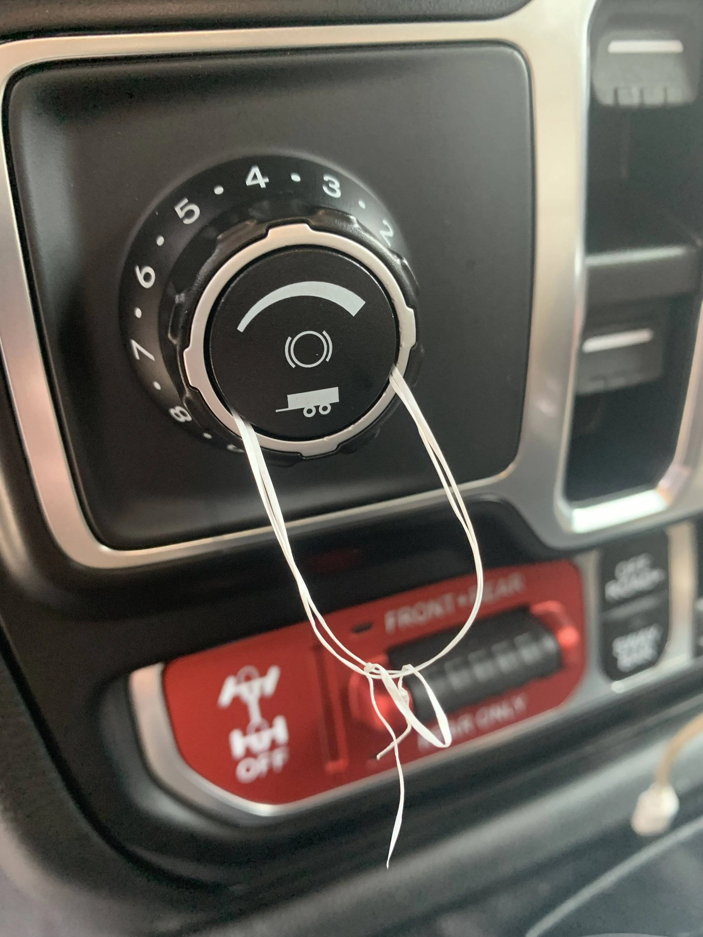

@tobyw you hit the nail on the head. The manual break button is sticking. I was able to remove it with 2 pick probes. With the button out everything functions perfectly. The part that sticks is the clear plastic cross when it is inserted into the control knob. It was a snug fit to start, so I spent some time with 220 grit paper sanding down the all sides of the cross. I had to remove it from the black knob so I could sand all the way to the base of the cross. I applied some dielectric grease and worked that in several times. It took me a little while to get it to the point that it would spring back on it's own. After I took it out the first time I slipped dental floss under the tabs that hold the black knob to the clear cross to create a loop so that I could pull the button back out easier while working on it!

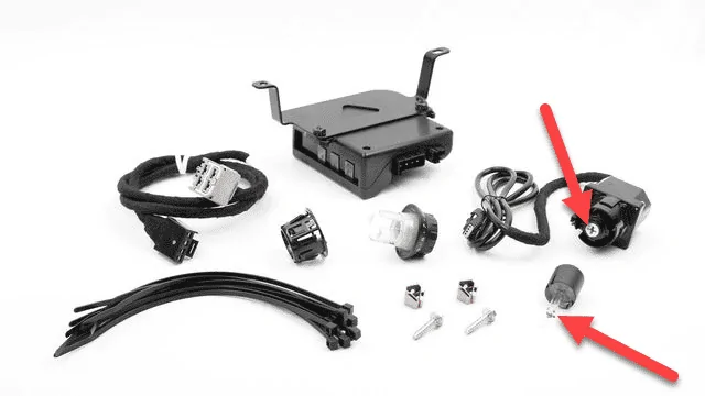

That's awesome!! Any chance you snapped a picture of what you sanded down exactly? Based on your description, I am envisioning that you were somehow able to remove the button with a couple of small pic tools, and then sanded down the edges of the clear "male" cross on the backside of the button that engages into the "female" cross on the unit that sits behind the dash bezel?
Sorry, I did not snap any pics. It was challenging to get the button back out. I have a set similar to this. I used two angled picks inserted between the dial and the button and worked my way around until it popped out far enough to grab. The piece I sanded is the male cross (lower right in your pic) on the backside of the button. I sanded the all the surfaces until it stopped hanging up, plus put the dielectric grease on it. I know the dental floss idea sounded crazy, but it was the only thing I could think of that would not bind and be able to be removed after I was happy with it. It really helped during the process because it continued to bind until I got it right. Figured this was a better method that constantly using the picks. If you look closely you can see where I was inserting the picks and it left minor blemishes.
