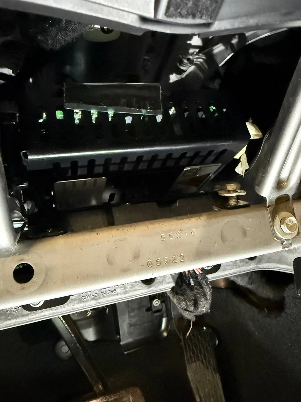

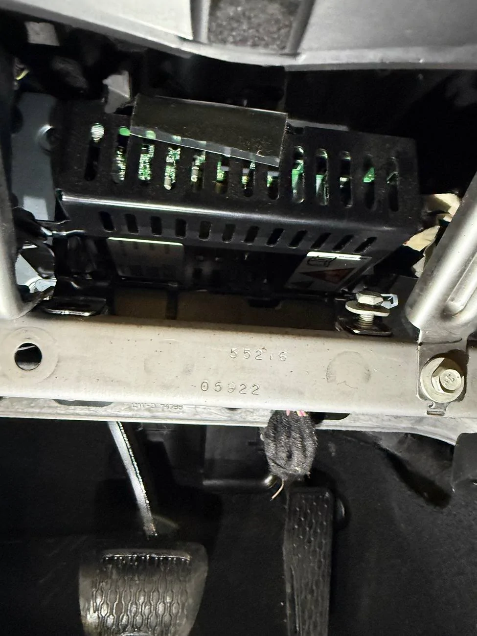

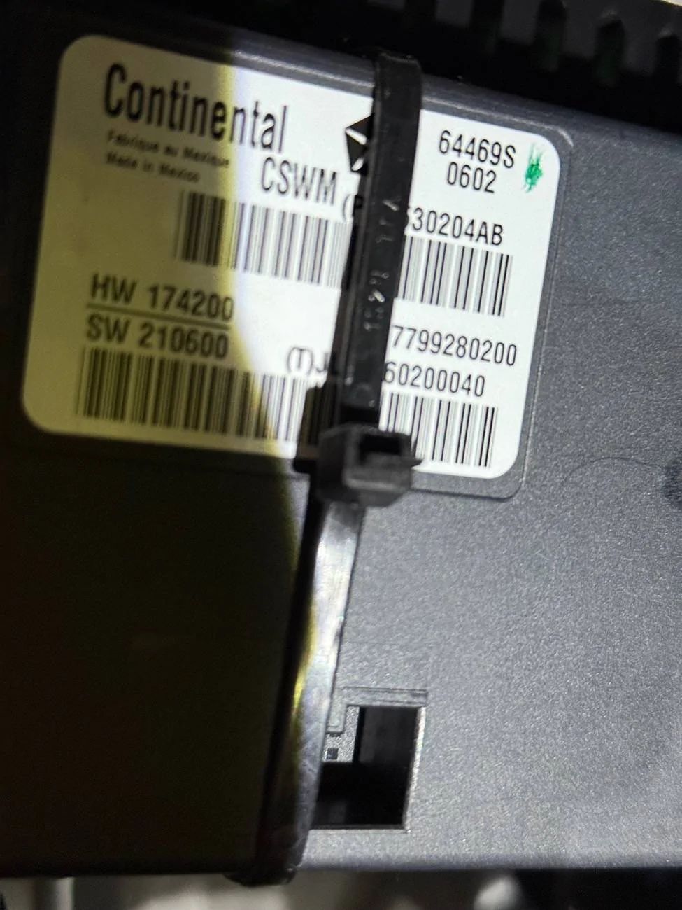

I installed my tazer tonight in my used Glady after removing it from my old two-door after purchase. While under the dash of my willy trim I noticed this device. At first I thought it was a tracker, but I google the info on the box and found it was a brake controller. I don't have the factory towing option on my window sticker, but its there. Is this entire two part Black box the brake controller? On the dash is there supposed to be a gain switch to control the current to trailer brakes? Oh so many Questions.

Power converter ah I see that makes since beings it is vented so well.

This is where I got the brake controller idea, numbers are the Same I believe
The 64469S on the label seems to be common on numerous modules made by Continental which would explain why it comes up in a search, but it's not the part number. The actual part number is the one above the upper bar code, partially concealed by the zip tie in your picture, ending in 30204AB.
