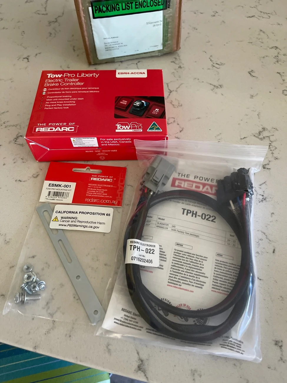

Just got this in. About where is the plug for it?
Thanks
Jeep Gladiator Trailer brake controller imag
rharr
May 6, 2021
29
2,119
2,898
Tucson, AZ
up and left of the steering wheel shaft when you pop the cover

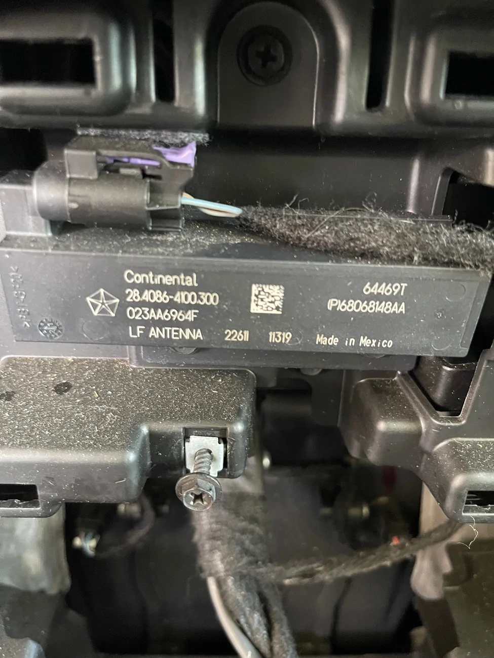

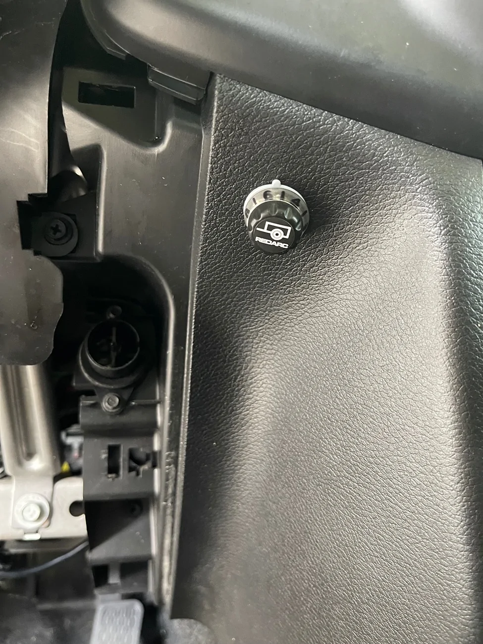

Installed. Other than not a lot of room under the dash. It was plug and play
Jeep Gladiator Trailer brake controller IMG_0300
Jeep Gladiator Trailer brake controller IMG_0299
FC1
FC1
Donald
Oct 26, 2025
167
145
florida
2015 jeep
welder
Sorry about the last pic.
What is that
DylanM
Dylan
Sep 1, 2023
1,148
2,816
'21 JTRD
USAF Retired
What is that
It's an LF antenna, part of the system that detects your key fob and its location inside or just outside the truck.

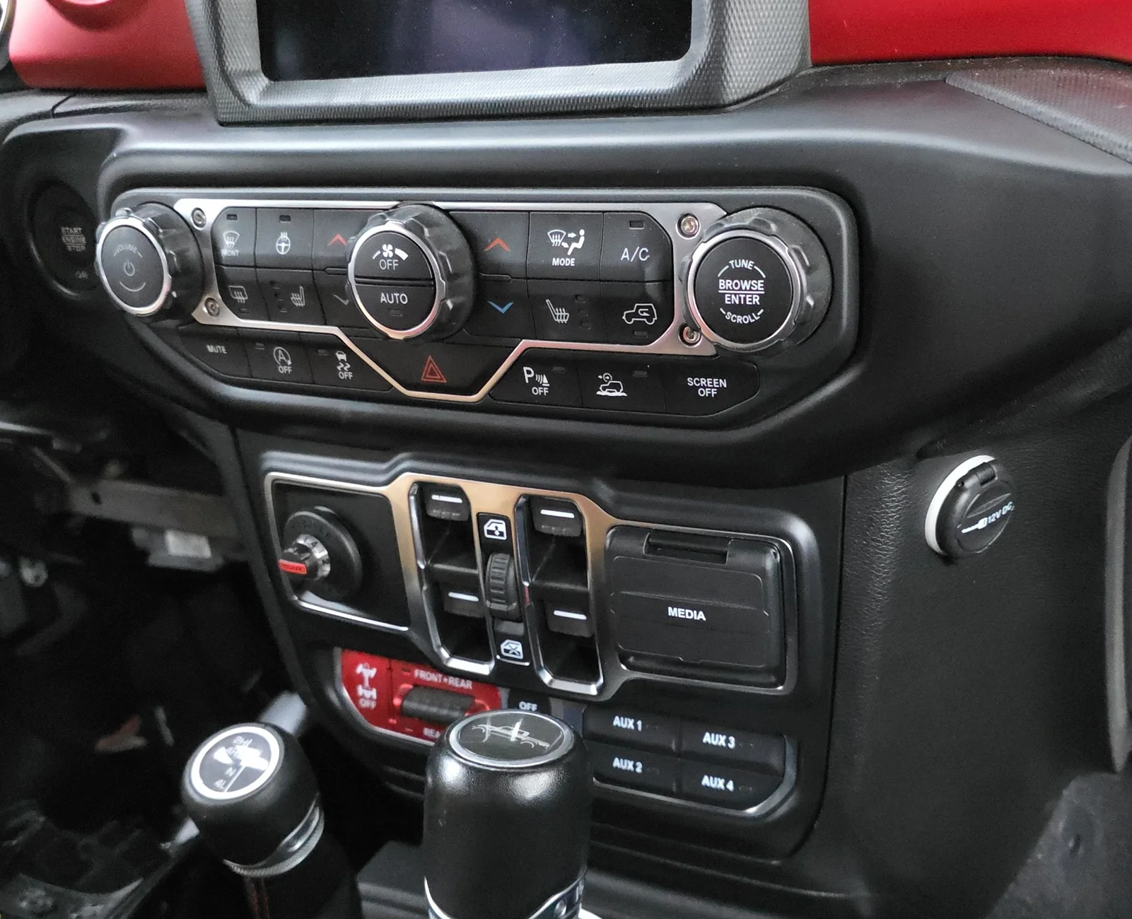

I took @FC1 lead and went with the redarc system. I found a model made for the JT that utilizes the factory position and plan on relocating the 12v to the passenger side of the center console. Excited to get it installed. Been installing brakes on my trailer while waiting for Amazon to get necessary items to me. Also will install the missing aux buttons that the factory forgot to put in my JTRD.
