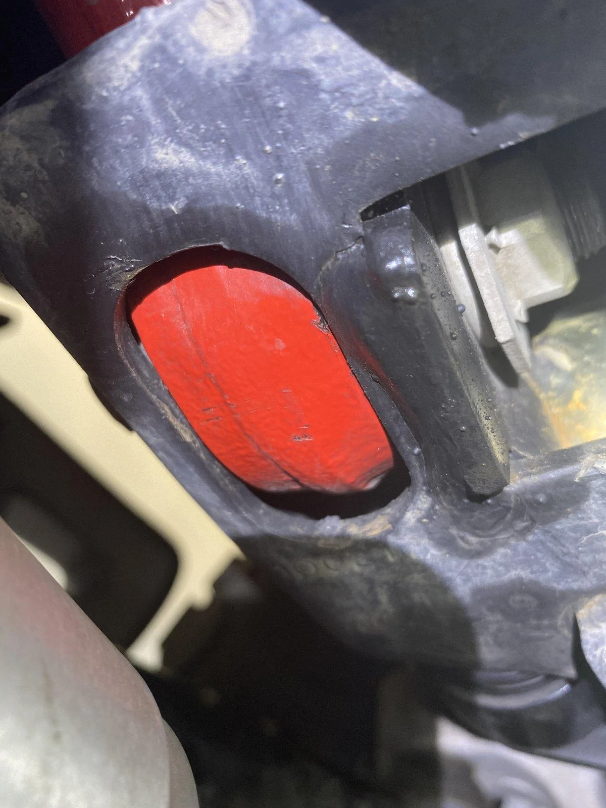

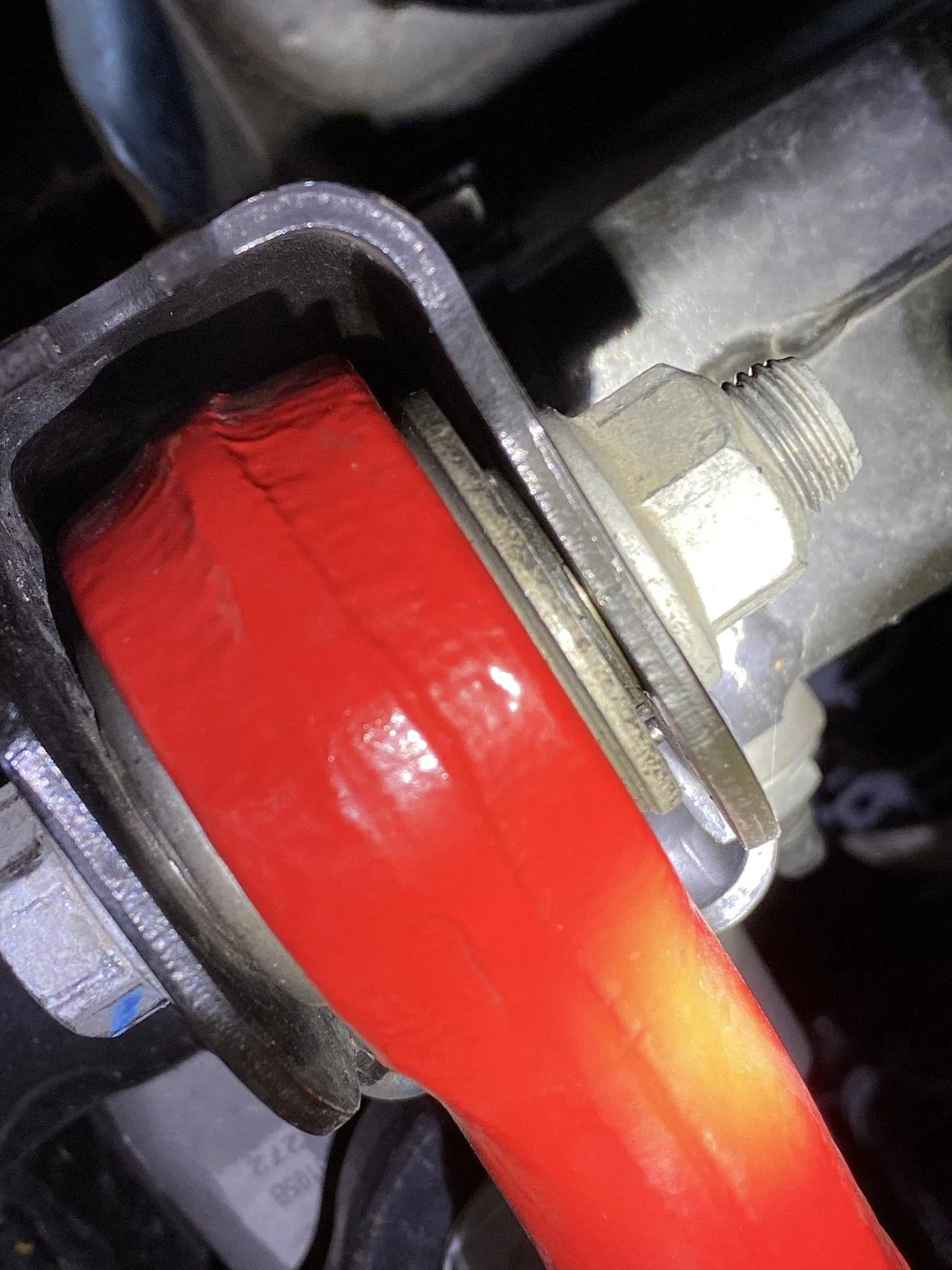

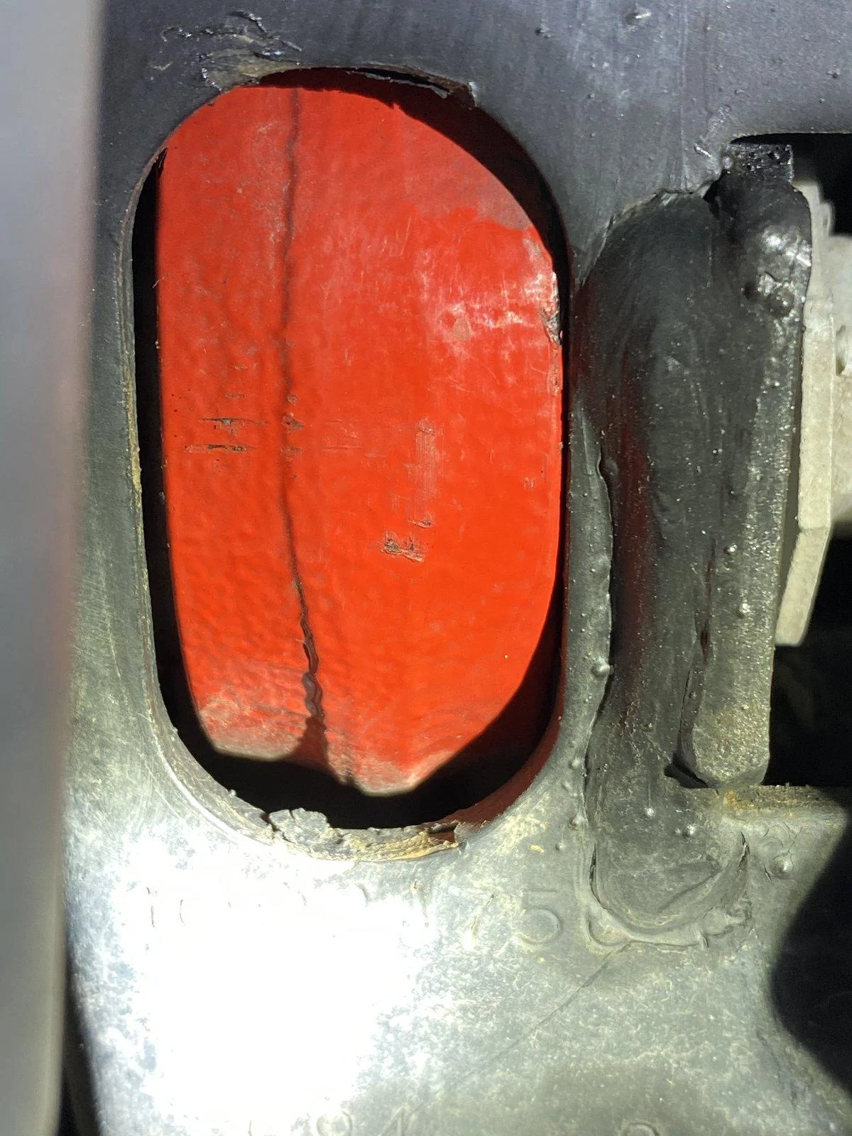

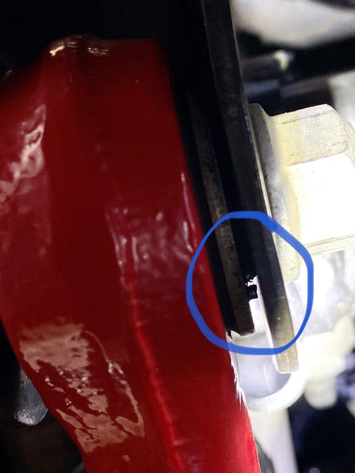

I’m actually contemplating when I go in to get my LCA torqued on Monday having the shop take out my Steersmarts trackbar and put back in the stock one to test if that’s the culprit.
That’s how the bottom of the trackbar sits on the passenger side. Dunno if that’s normal or is the cause of the chirp due to potential rubbing.
Jeep Gladiator Mopar lift chirping A805E81F-4421-4BC1-861C-A3C986B23F54
Jeep Gladiator Mopar lift chirping 7F8474AB-19ED-458D-BB07-F0661B6A6E72
Then IDK if this is poor machining or what but there are these pins or whatever sticking out of the top bushing by the driver side.
