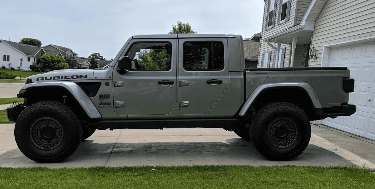

Love the tires and rims! What size rims are those they don't look like stock Jeep wheels?
