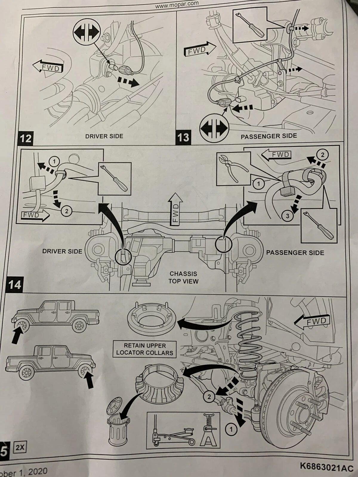

Looking for help on steps 12 and 14. Step 12 shows a line disconnect on the driver side which my vehicle does not have or I just can’t locate it. (sport s).
Also can’t find what step 14 is referring to.
Any help is appreciated!

Is your's Rubicon? 12 & 13 are showing you where to disconnect the plugs for the lockers.

Thanks. Not rubicon. The line disconnect was there on step 13 just not step 12.

Okay. I think 14 upper right is the view to snip zip ties on locker wires, but could be wrong. Think same for upper left view but someone more experienced than me may respond soon. Just lower slowly and watch for any line including brakes to run out of slack. Good luck to you
