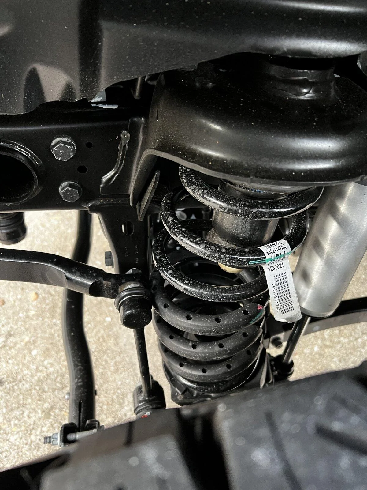

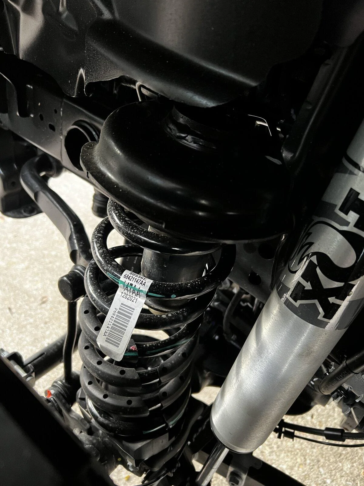

Hi. Need advice from the forum. I have a brand new JTRD. I had a shop install the diesel specific mopar lift + the teraflex leveling kit. I’m getting a really bad forward bow on the drivers front spring. I asked the shop and they said to bring it by and they will look. They also said it’s generally not a good idea to stack the spring lift with the leveling kits. Better to just buy a spring with the height you want. I’m trying to figure out the best way forward. I’ll stop by the shop and they will check if seated properly. Any advice?

Looks like the spring is not "Clocked" in the correct position. You maybe able to fix it yourself.

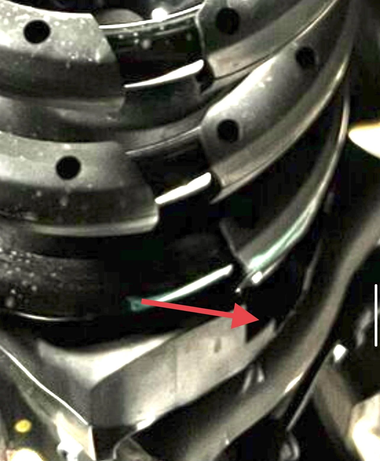

Hard to tell from the photo, but looks like it’s not clocked. It’s something you can look at and immediately see if it’s not.

Just wanted to stop back in and thank @XraytecH and @USMC-SSGT for the helpful tips. Based on your feedback I took it back to the stop today. They were nice and pulled it right in to check it out. Turns out they had reversed the left & right pads. They changed them out and the forward bow is gone. It also seems to drive better. Thanks for your help.

My second thought would have been swapping positions between the spring isolators. Good to hear the issue has resolved.

Nice, that’s a good resolution. A little easier to handle than a shop simply not clocking the spring correctly. Throw some isolators on the bench and it’s an easy mistake to mix them up.
