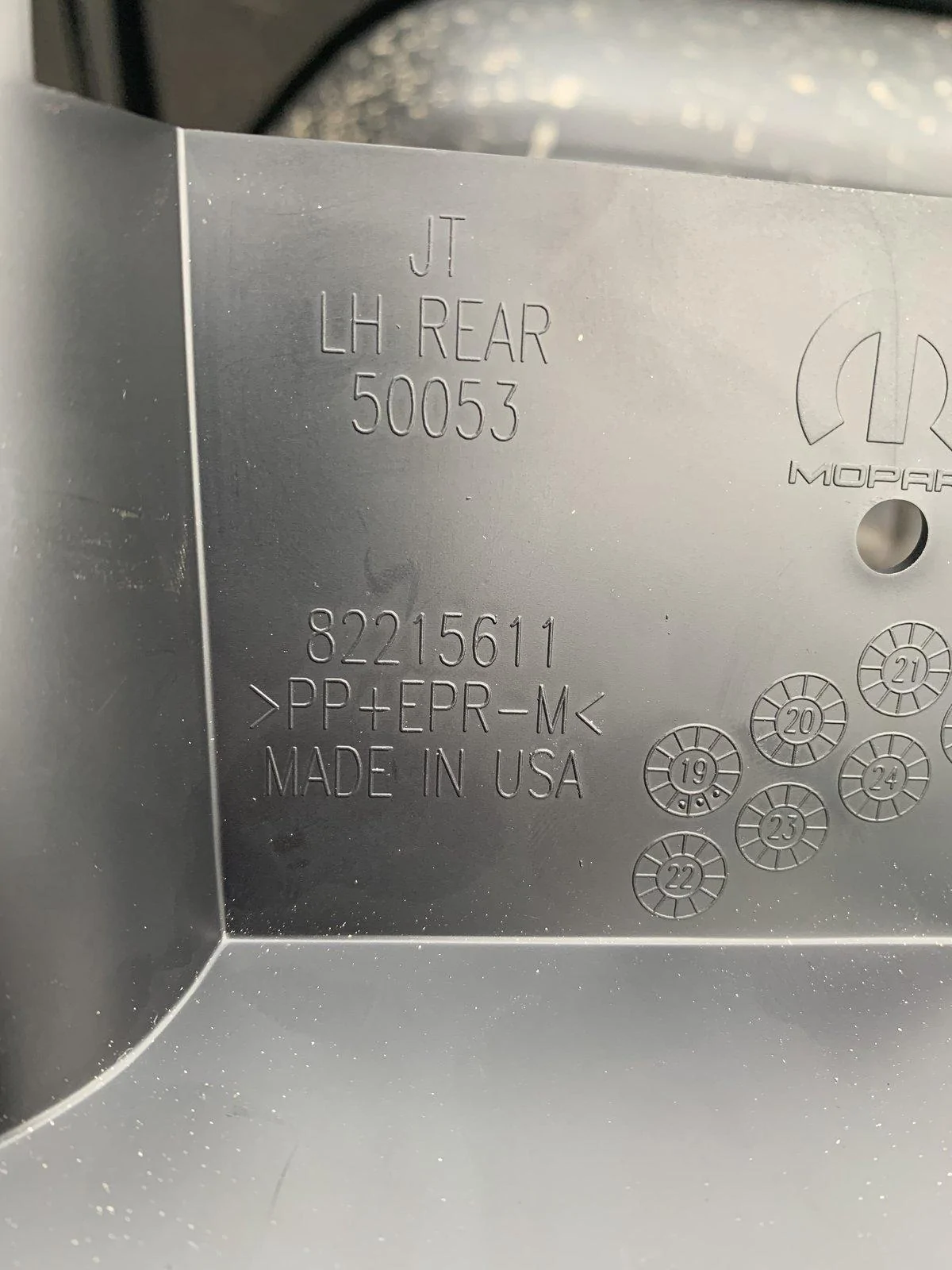

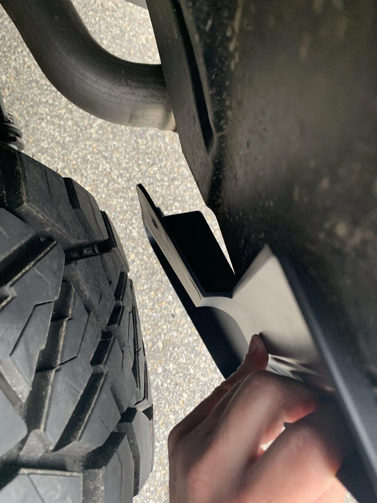

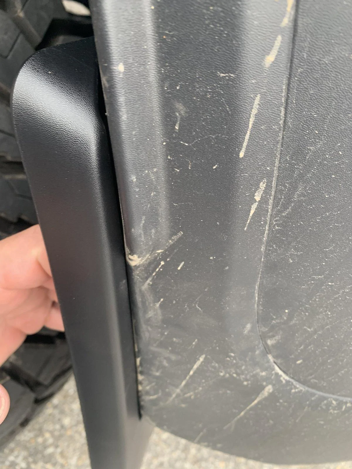

I ordered some mudflaps for my Max tow. Fronts fit perfect. Rears won't line up correctly.. not sure what I am missing but they simply won't line up at inside edge. Are they all the same? They are Mopar and say JT right on them

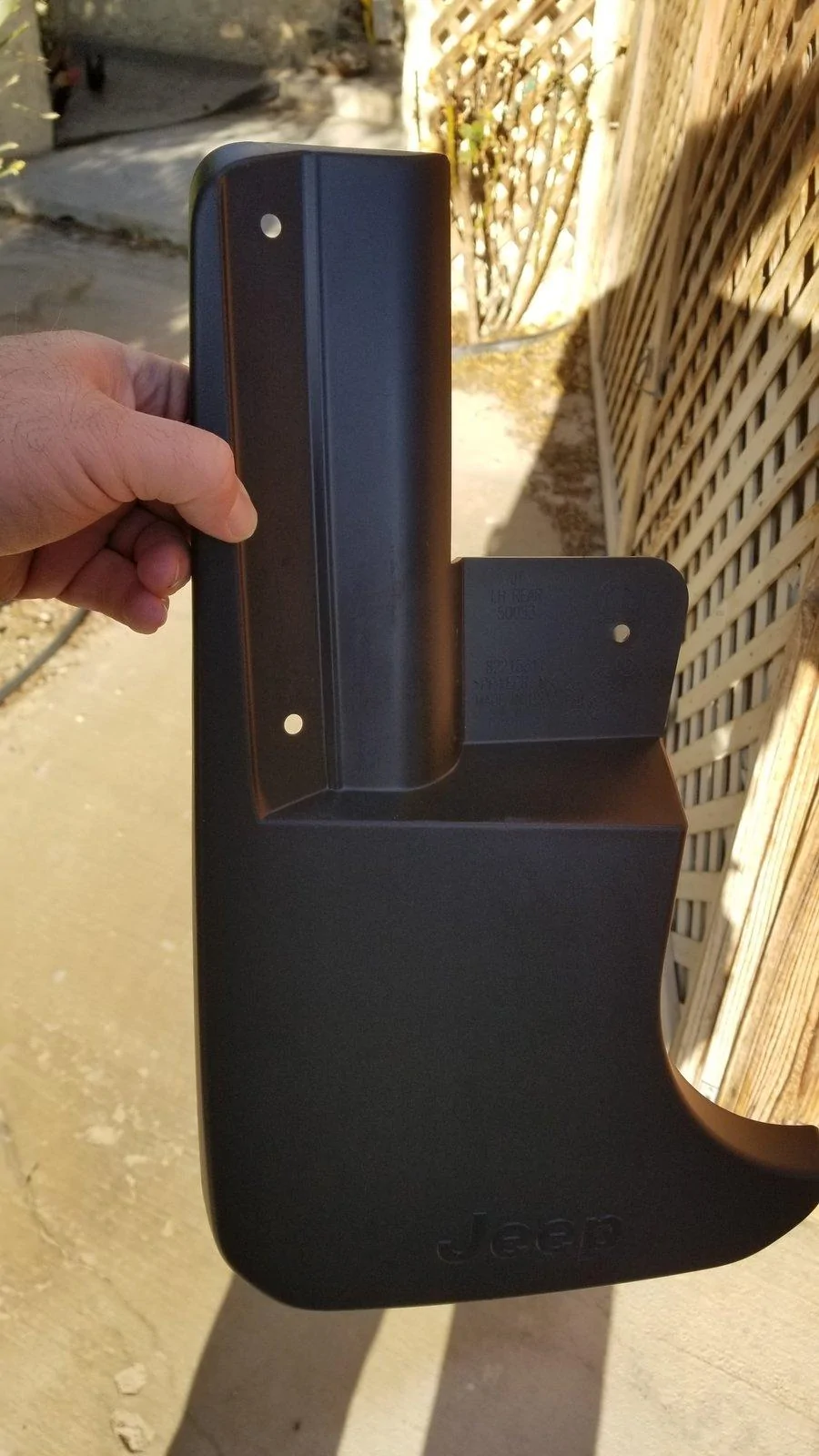

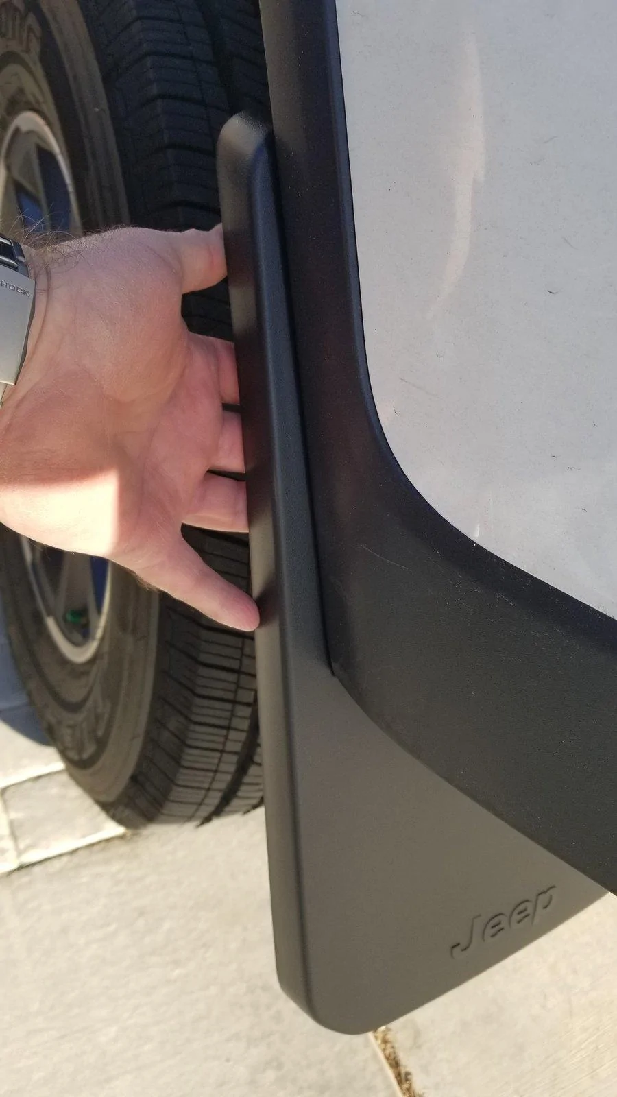

Since I haven't put mine on yet, I had to pull them out and look. The numbers are the same as mine. This is what the LR flap looks like and how it should fit.
After comparing the pictures, it looks like your fender might be different.

I ended up drilling out the push pin right inside lip and just using a stainless nut and bolt. Secured lip and that with stainless bolt and plastic rivet on inside. It's on now!

I ended up using 1/4" nut and bolts and just secured that way. Right inside the lip had a small brace so I used same there and drilled hole
