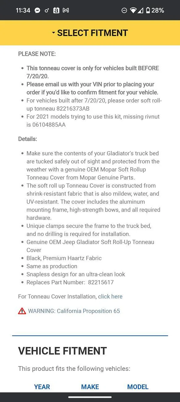

Jeep Gladiator Mopar roll-up tonneau compatibility help 2024 Screenshot_20250119-233459

4TH bullet point down........ rivnut is the difference.
Thanks. But does that mean it'll work with my 2024 if I order that rivnut piece (06104885AA)?

Yes it should.
