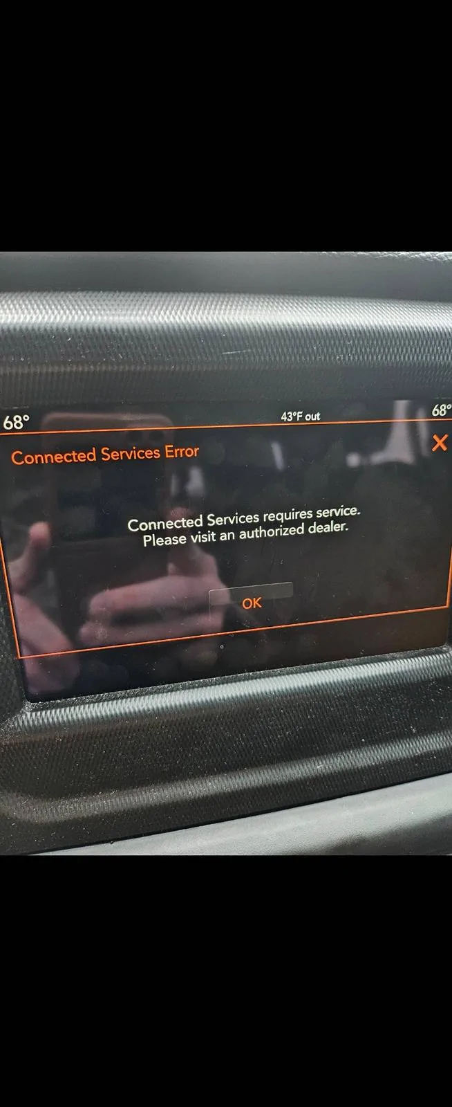

Hey appreciate the reply on my venting post!
#4 (connected services) has probably been the most frustrating as I have had it for months and went through so many "fixes". I have a Jeep Wave and STAR case open so hopefully it gets resolved.
#5 (rear window leak) has just been the latest issue, but was shocked to find out it wasn't covered under warranty. I don't know how they can say there are cracks in the glass causing the leak but there are no visible cracks to see. Hoping the Jeep Wave case will help.
