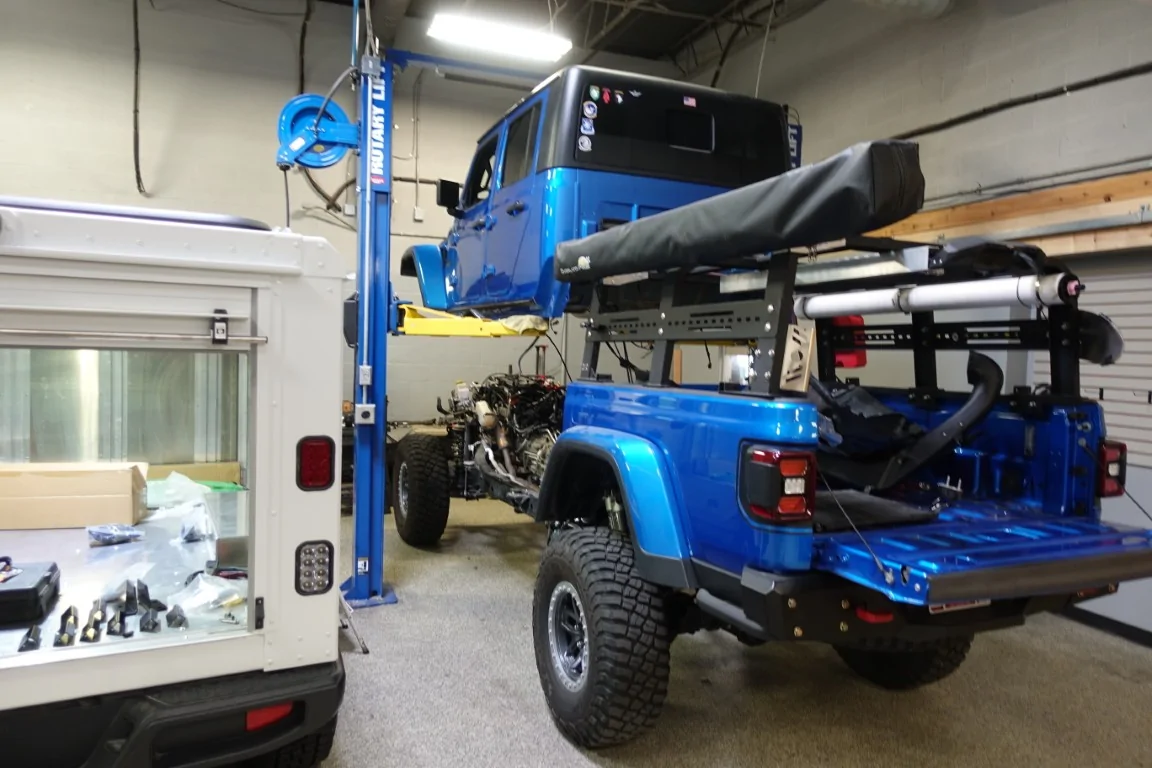

That brings me to today. Last week, the teardown began. He has multiple buildings and the Glady's current location is a shop that "preps" the truck for the major surgery. Over in that remote building, the truck lost its front bumper and winch, the RSE rock sliders, the roof tent, and I think the rack. That finished up today. From here, it will be taken into the main facility where the body will be separated and the old powerplant removed.

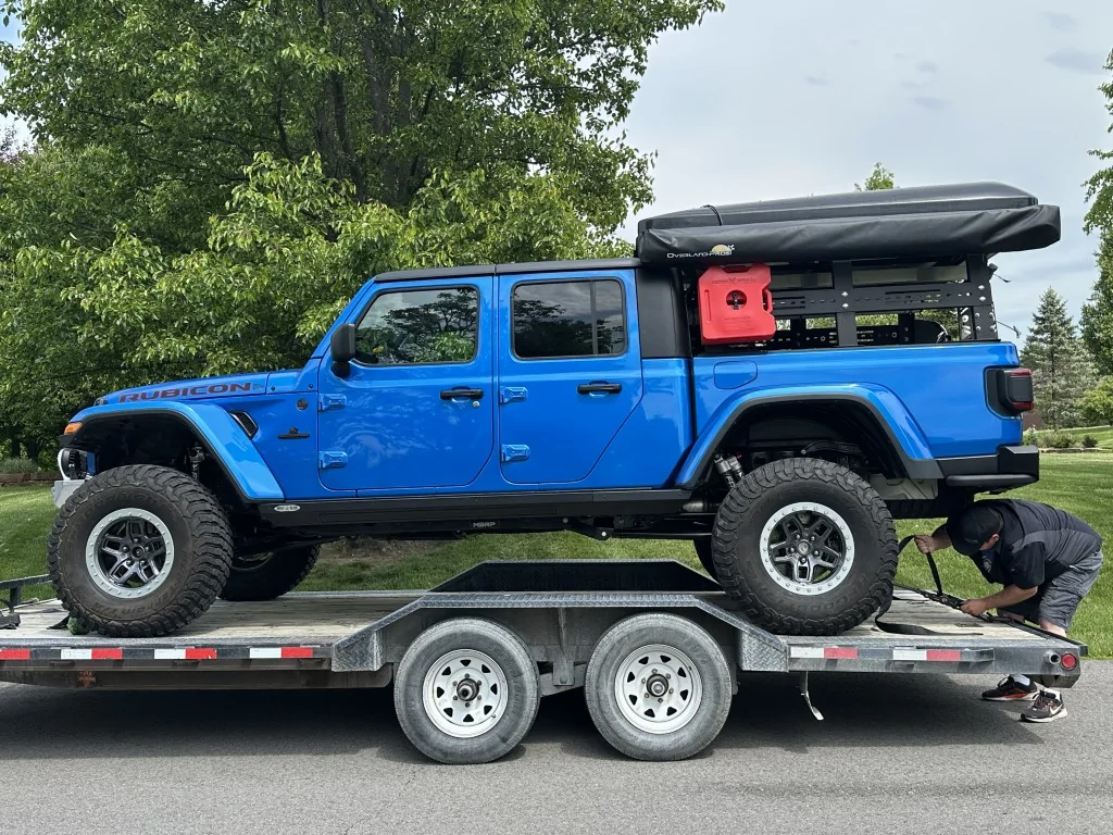

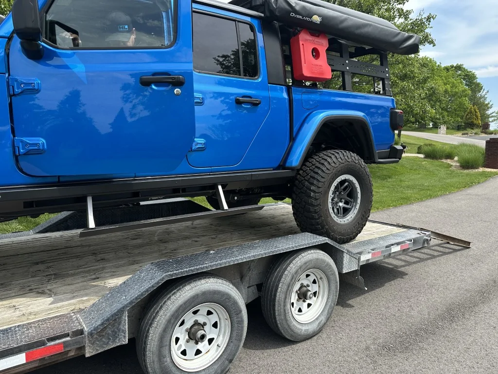

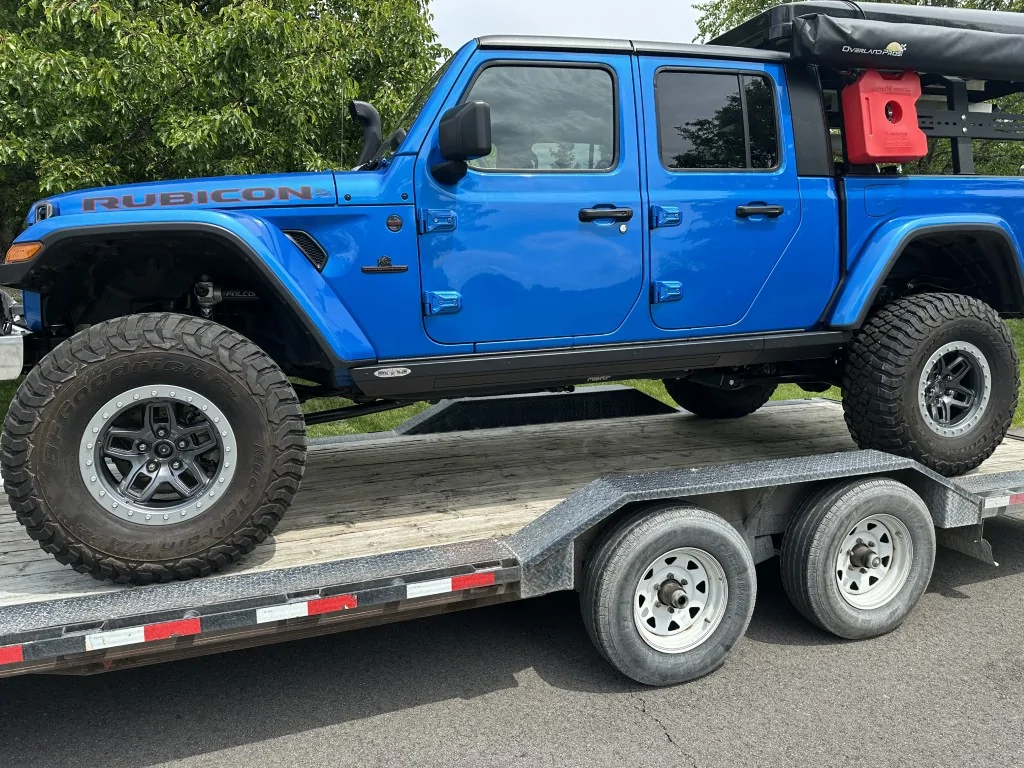

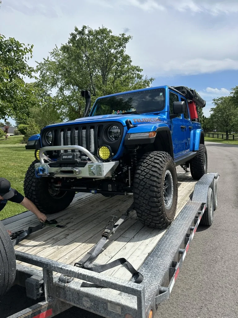

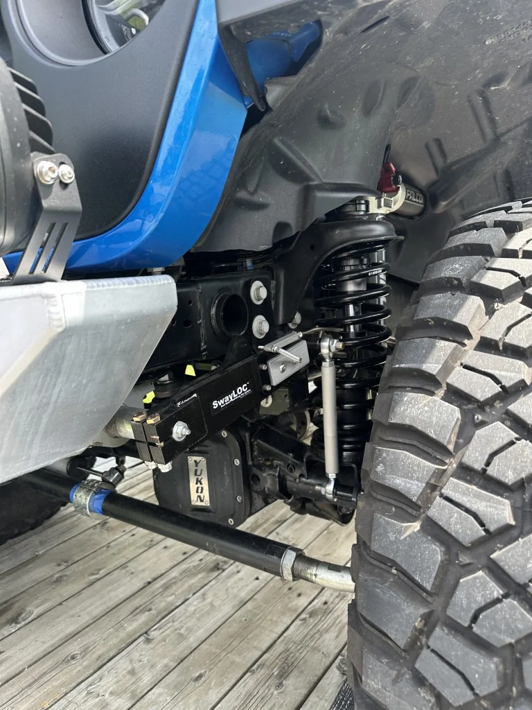

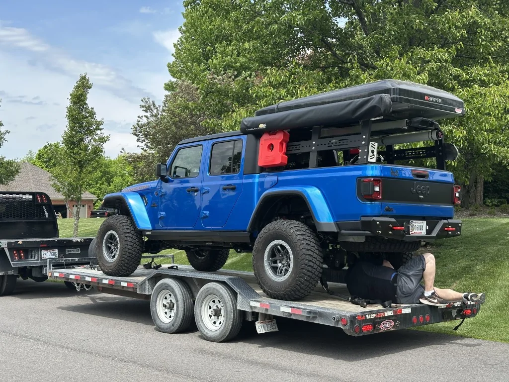

Pics are from the day they came to pick the Gladiator up
Jeep Gladiator My "actual" 392 swap thread IMG_1177 (Medium)
Jeep Gladiator My "actual" 392 swap thread IMG_1176 (Medium)
Jeep Gladiator My "actual" 392 swap thread IMG_1186 (Medium)
Jeep Gladiator My "actual" 392 swap thread IMG_1180 (Medium)
Jeep Gladiator My "actual" 392 swap thread IMG_1183 (Medium)
Jeep Gladiator My "actual" 392 swap thread IMG_1185 (Medium)

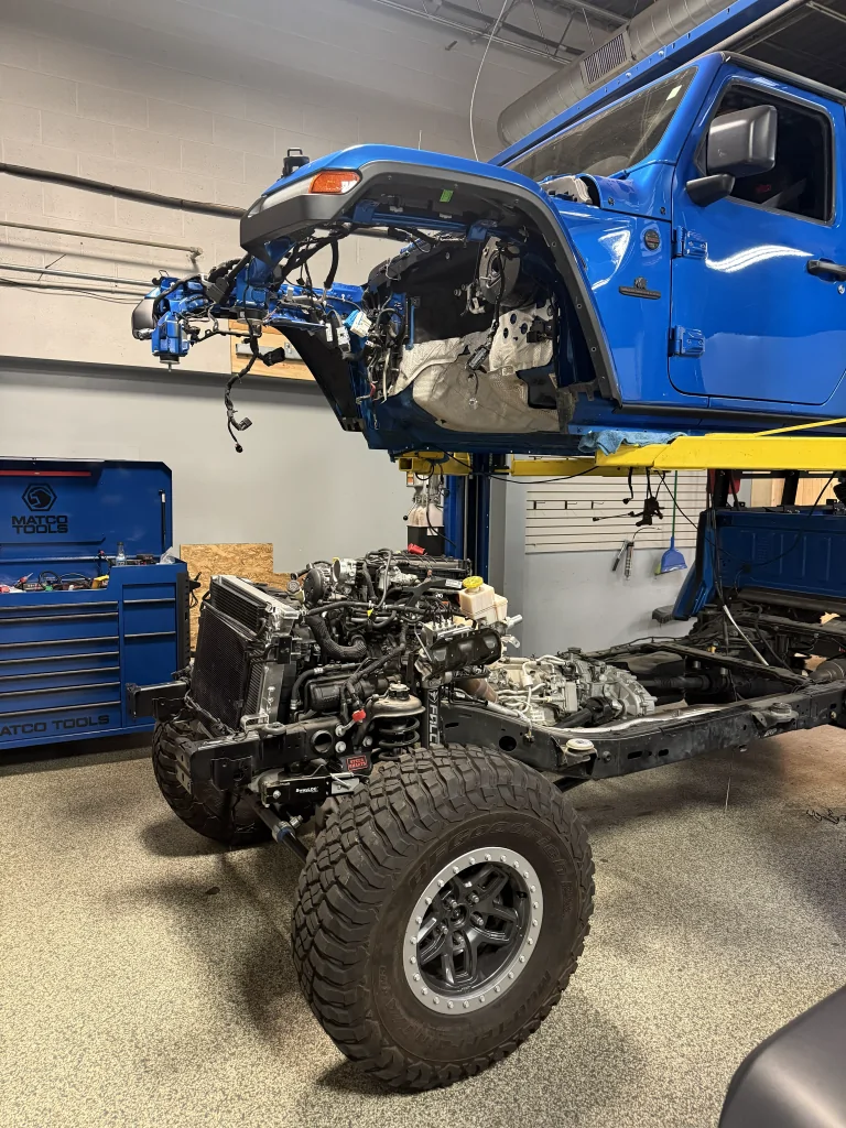

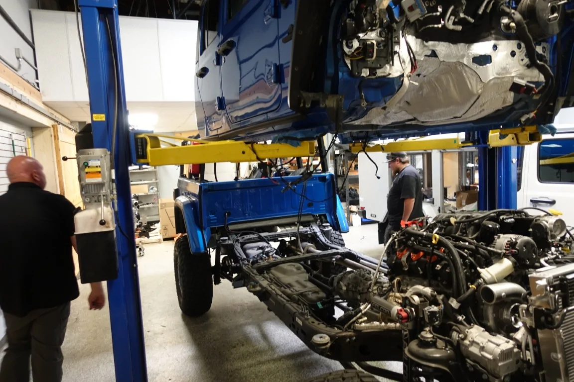

This photo showed up in one of my messages today. Looks like they already have the body off, but the Pentastar is still sitting there.

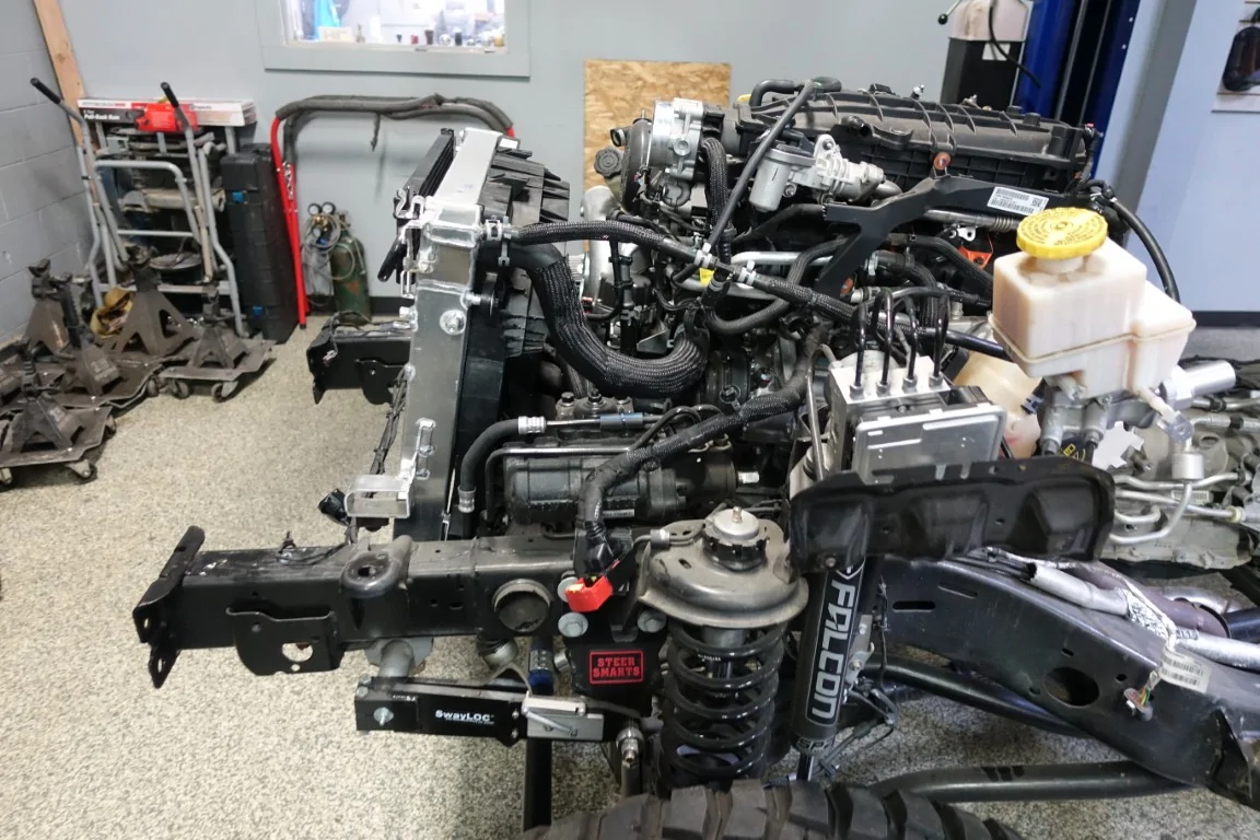

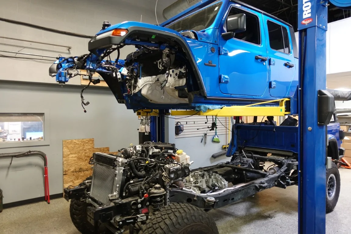

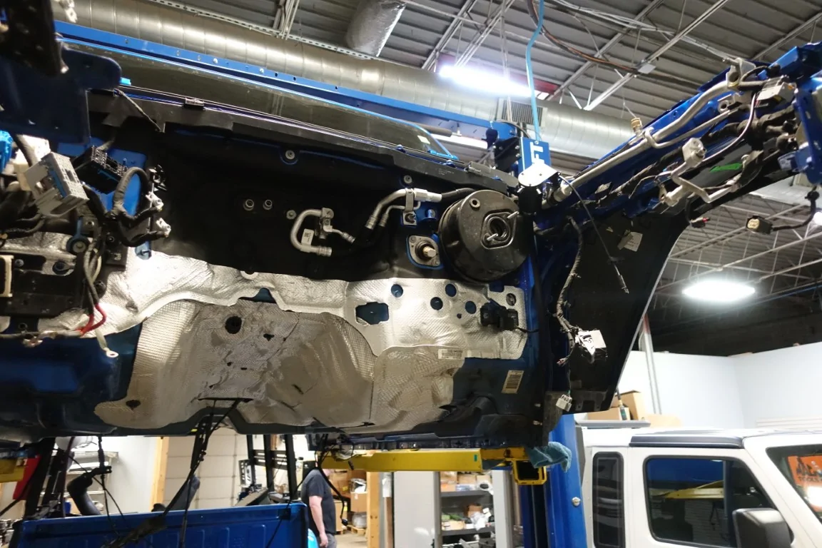

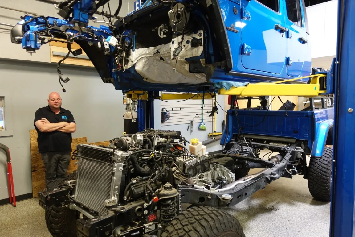

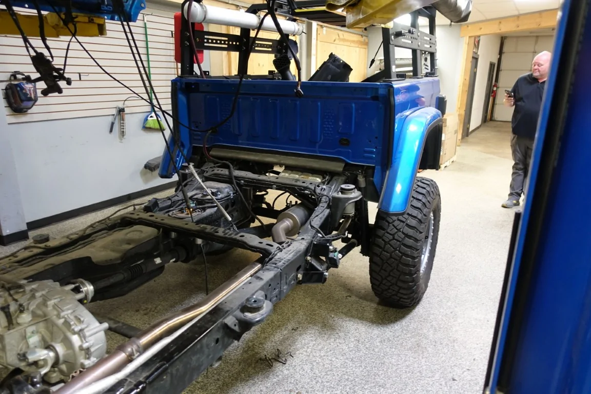

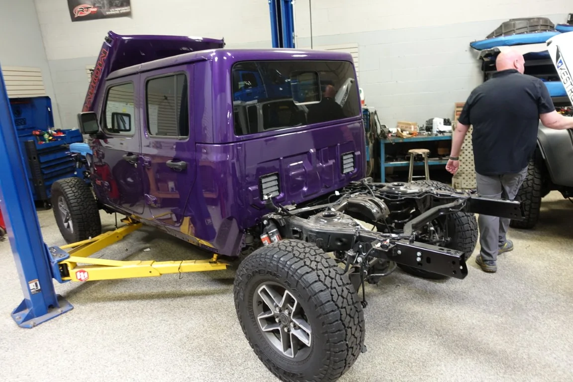

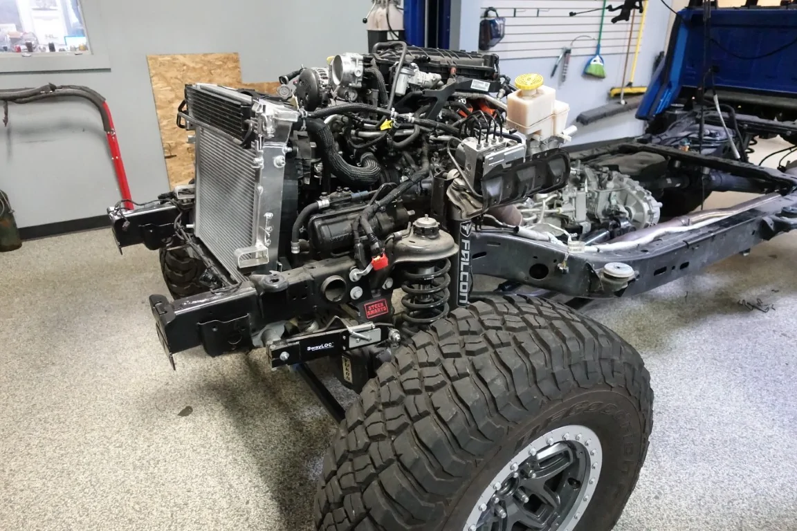

Had a visit with the folks doing this swap for me today. We discussed what was going on, including electric/hydraulic steering, stock or aftermarket rear driveshaft, and the cost when it gets released. I got some good answers, which I can finally share with you.
First, let's look at what's going on with the swap so far:
Jeep Gladiator My "actual" 392 swap thread DSC02039 (Medium)
Jeep Gladiator My "actual" 392 swap thread DSC02040 (Medium)
Jeep Gladiator My "actual" 392 swap thread DSC02044 (Medium)
Jeep Gladiator My "actual" 392 swap thread DSC02051 (Medium)
Jeep Gladiator My "actual" 392 swap thread DSC02052 (Medium)
Jeep Gladiator My "actual" 392 swap thread DSC02053 (Medium)
Jeep Gladiator My "actual" 392 swap thread DSC02054 (Medium)
Jeep Gladiator My "actual" 392 swap thread DSC02055 (Medium)

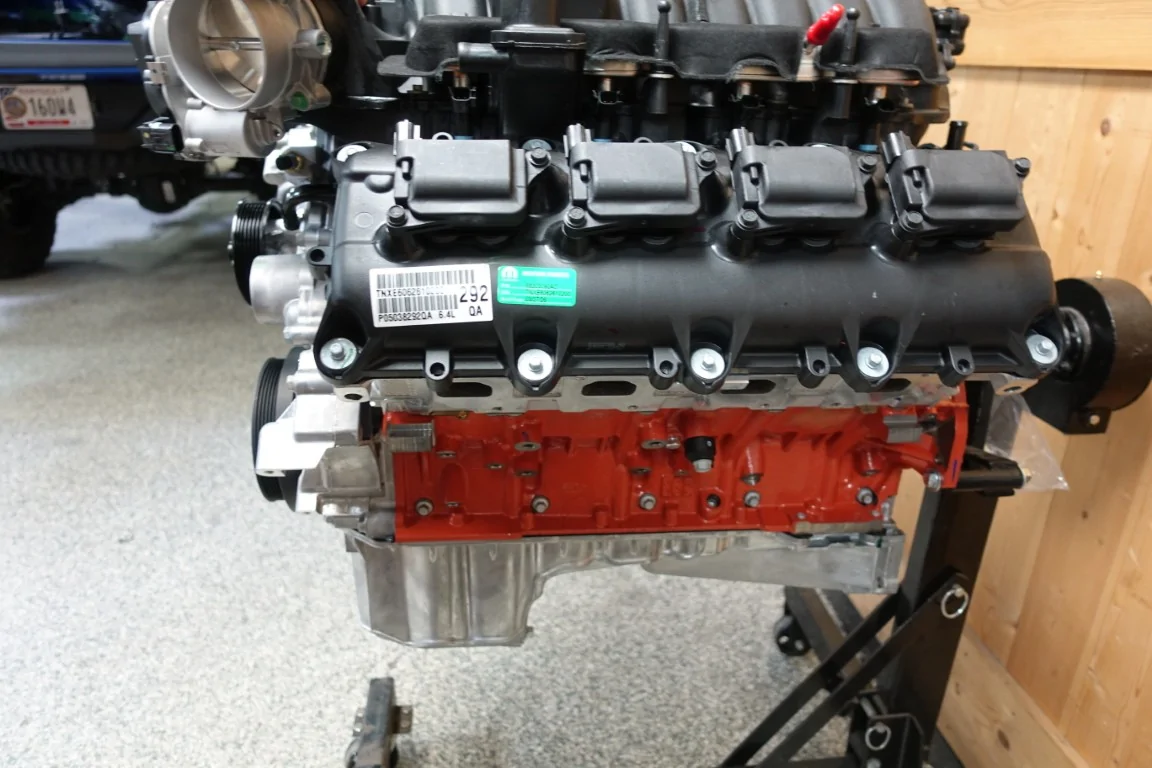

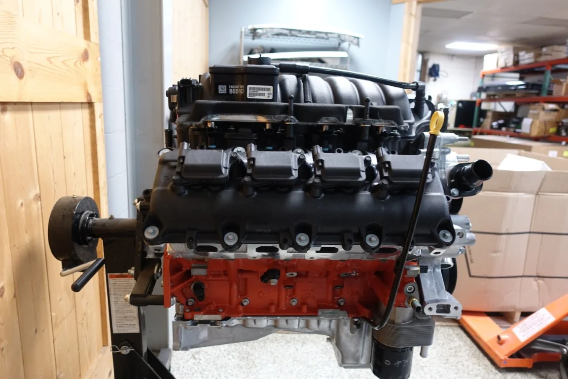

Here is my 6.4 SRT Hemi
It gets dressed on Monday
Jeep Gladiator My "actual" 392 swap thread DSC02058 (Medium)
Jeep Gladiator My "actual" 392 swap thread DSC02059 (Medium)

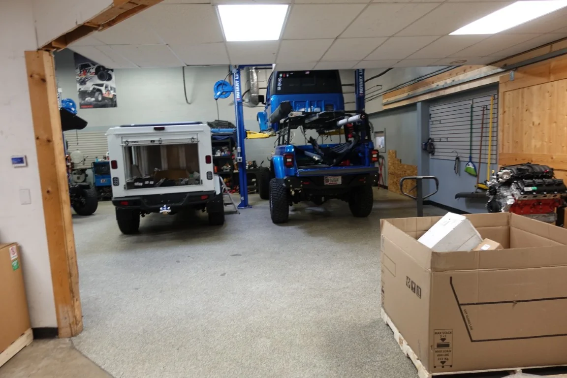

The large box on the right is full of the parts going into my truck. Mike would not let me photo the actual boxes, he does not want the part numbers getting out. Like I said before, this swap will be more "stock" than some of the other kits out there.
Jeep Gladiator My "actual" 392 swap thread DSC02069 (Medium)

He can also offer a bobbed bed. Here's one a few feet away from my JT
Jeep Gladiator My "actual" 392 swap thread DSC02048 (Medium)

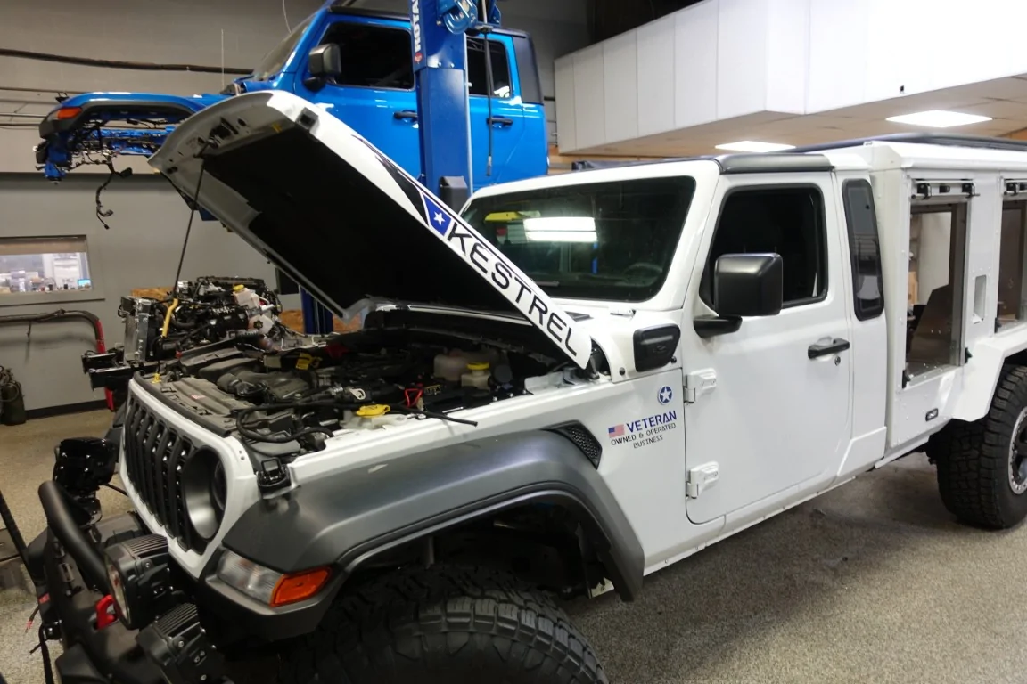

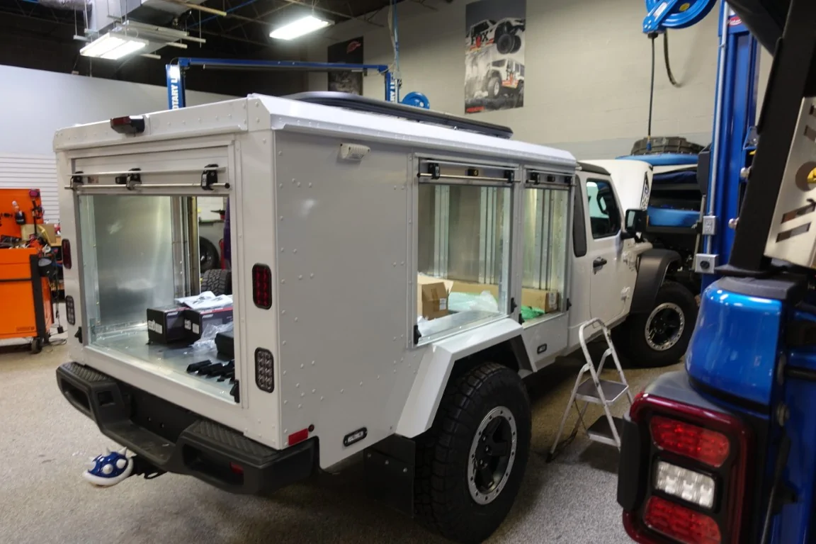

He is also offering some cool 2-door Gladiators! Yes, a two-door!
Jeep Gladiator My "actual" 392 swap thread DSC02046 (Medium)
Jeep Gladiator My "actual" 392 swap thread DSC02047 (Medium)
Jeep Gladiator My "actual" 392 swap thread DSC02049 (Medium)

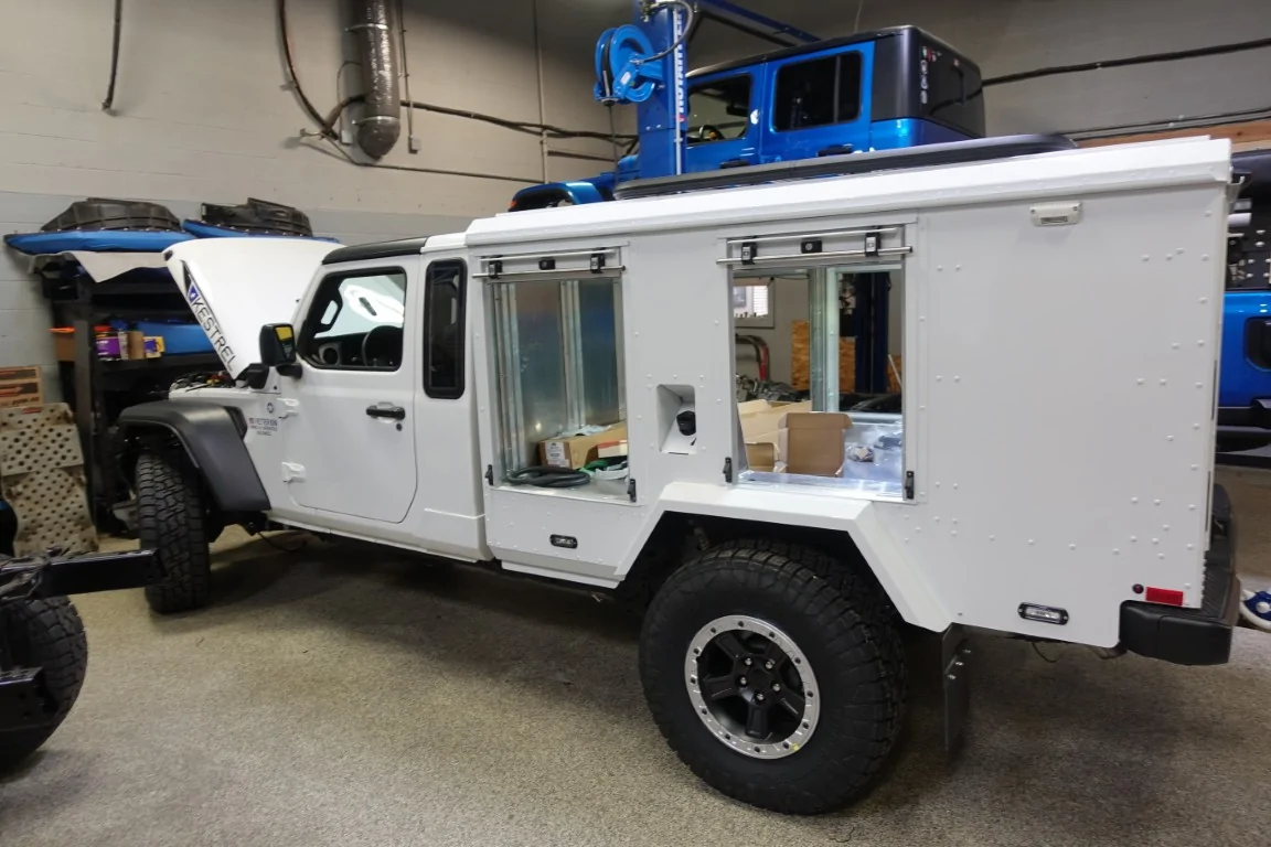

He is also building a unique JT for a guy we all know well from his YouTube adventures. I just missed meeting him by a day, darn!
