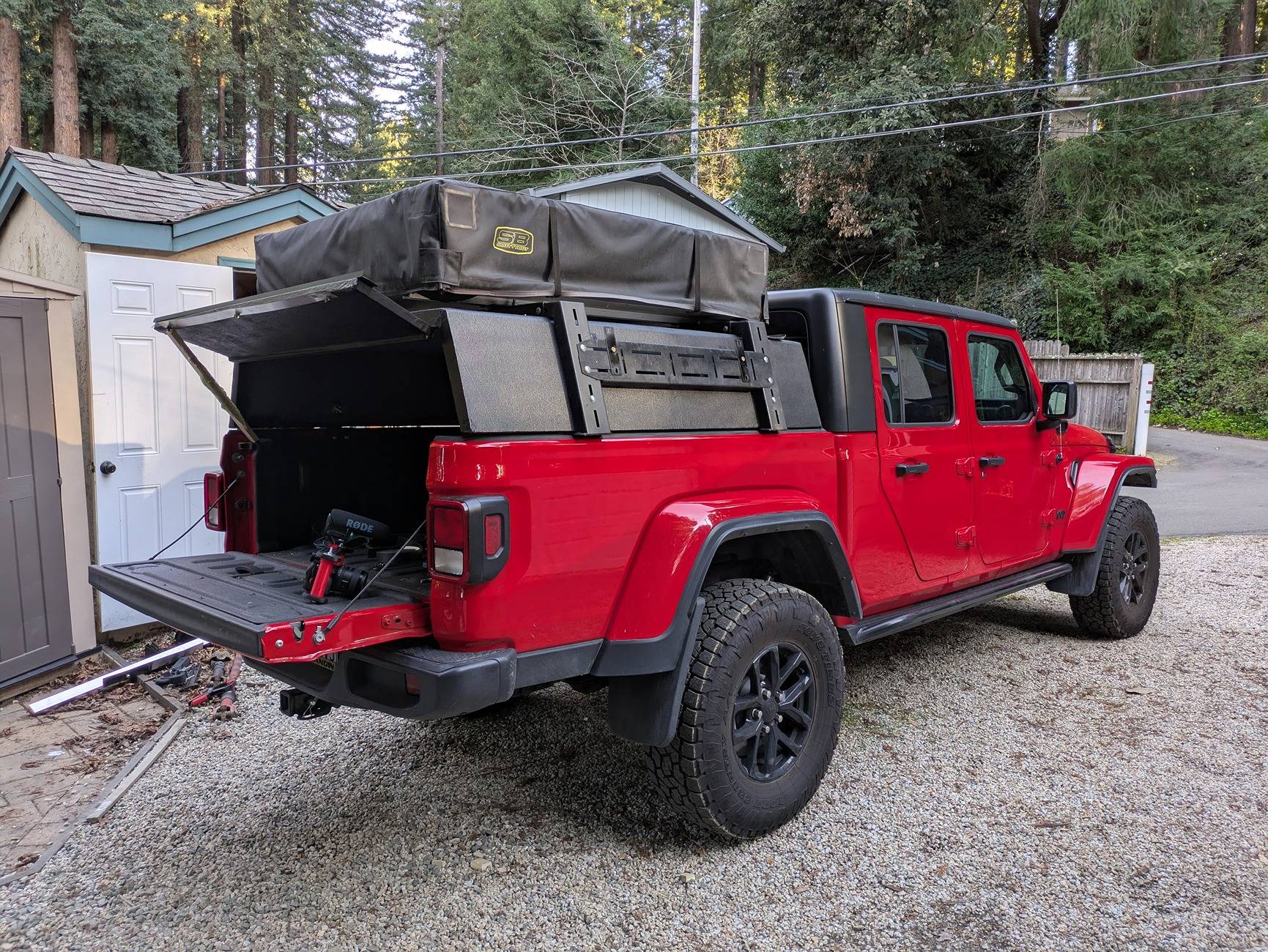

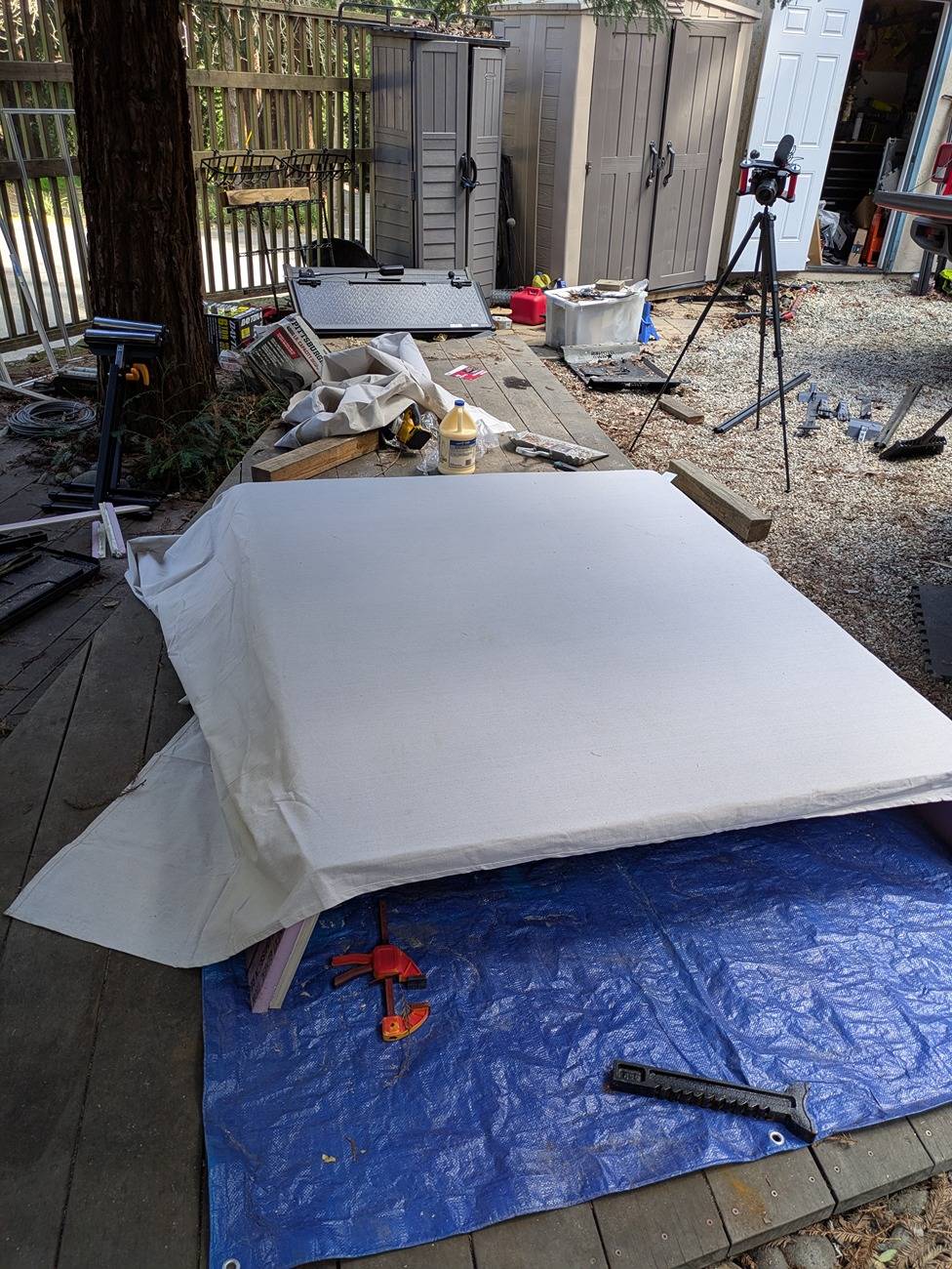

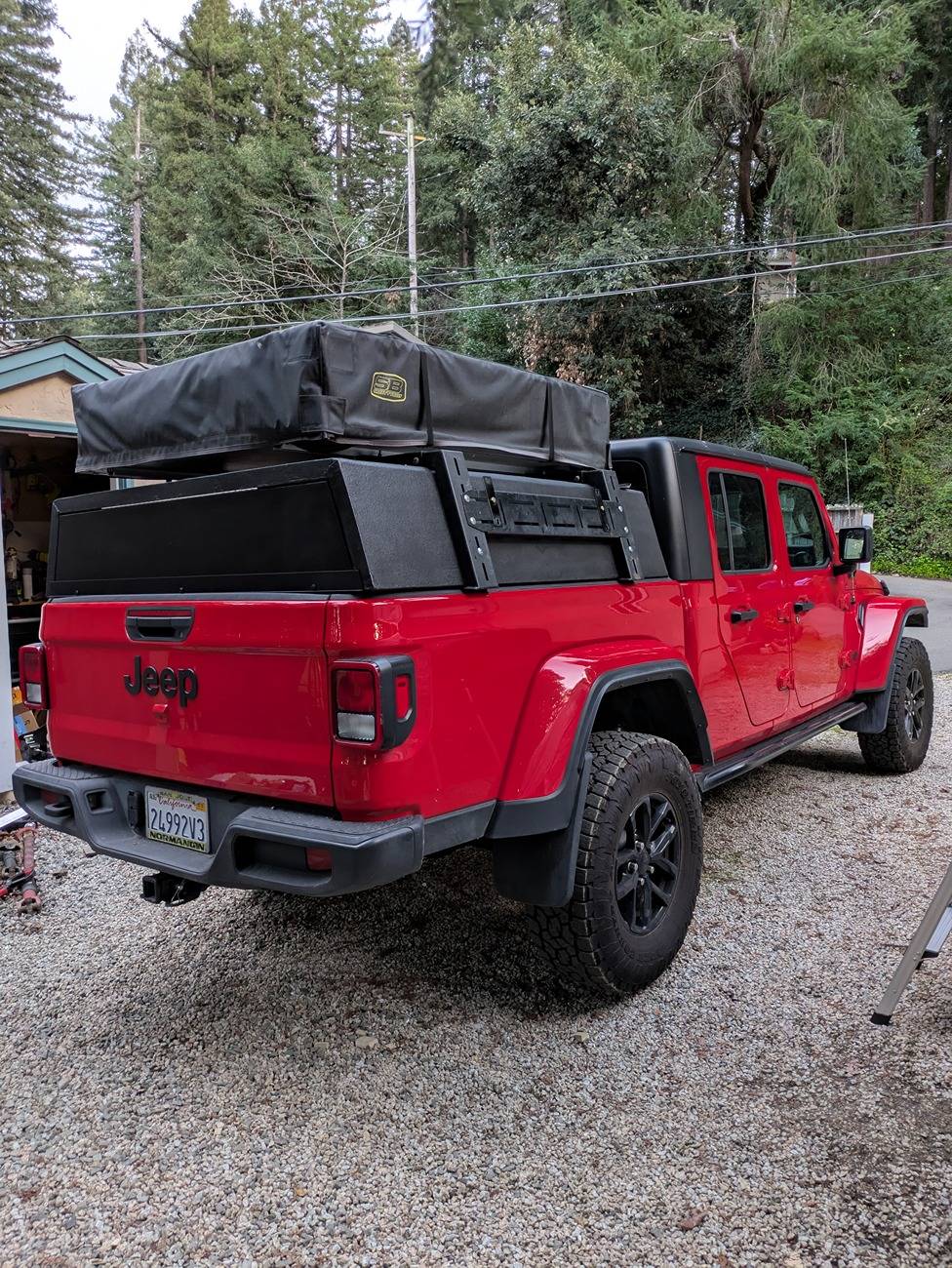

I realized it may be helpful to others so I'll post here! I posted about it in my build thread. This is my DIY camper shell. The shell itself is around $250 and weighs so little one person can pick it up and take it off. The outer metal shell is heavier but still manageable by one person.
Jeep Gladiator My DIY camper shell - Poor man's fiberglas, light and cheap 414789-f67977b385e6109ffb107697e1f66328
The intent was to build an overland shell to more easily fit gear and keep grubby hands off my stuff. But when I'm not camping I use my truck as a truck and so it can't be so hard to take off like a typical fiberglass shell.

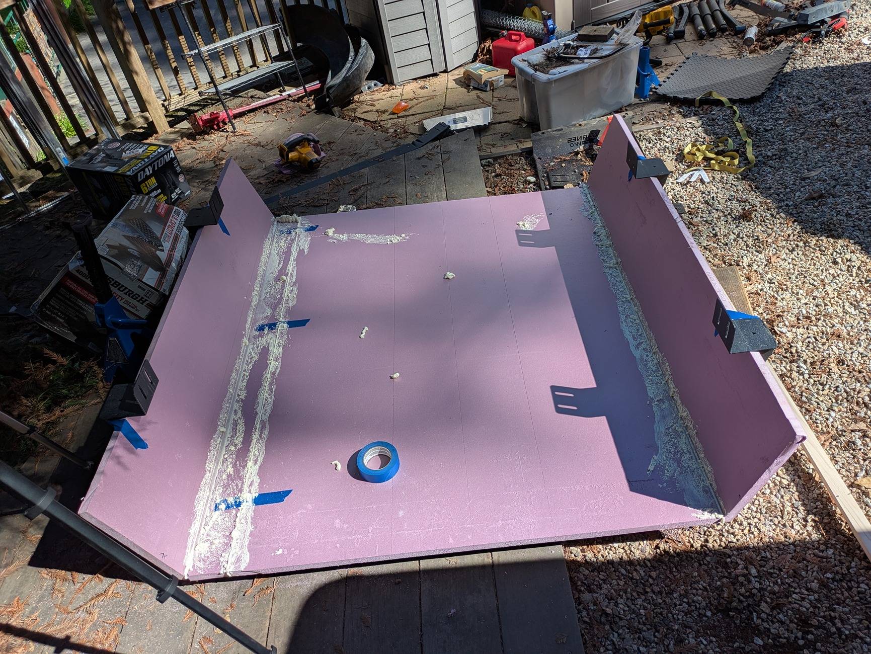

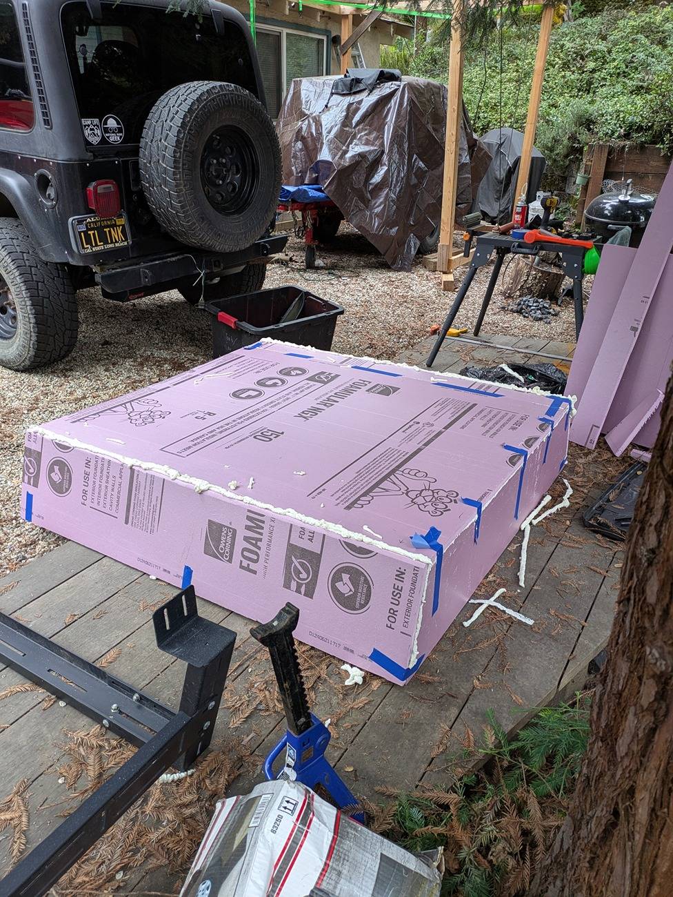

The base of the shell is made with XPS home insulation. I used expanding foam as "glue" to tie the insulation pieces together and fill the cracks.

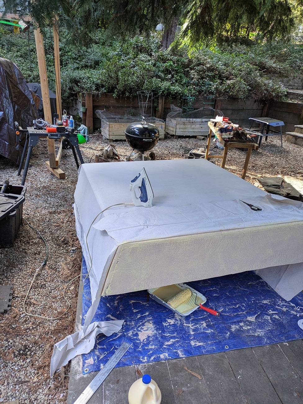

After you have the main body complete you use some canvas and type 2 wood glue. While type 3 wood glue is fully water proof, type 2 can be reshaped with heat and critically, glues to itself. Titebond ii is type 2 wood glue.
Anyway, you roll on wood glue and lay the canvas over top. You can use and iron to set the glue quickly and iron out wrinkles in one go.
Jeep Gladiator My DIY camper shell - Poor man's fiberglas, light and cheap 413615-ca6dda9b425decef5fbd79d05d60b2ce
Jeep Gladiator My DIY camper shell - Poor man's fiberglas, light and cheap 413613-a7cccec77d9218f1d7b781de6c9f34be
Once dry you cover it in watered down exterior paint. The reason for watering it down is so that the paint itself seeps into the canvas and makes a full waterproof layer. I did 2 watered down layers and gave it a sanding to smooth out the fabric texture. Then one more layer of paint but this time it wasn't watered down. Then I hit it with spray on bed liner.
For the bed liner it was CRITICAL to make sure the foam was completely sealed or covered since the bed liner spray actually dissolves the foam!
For the hinge section I used a wooden frame on the inside of the camper shell and had the canvas cover the wood as well to give a solid screw in point. In a follow on post I'll get a picture of the door prop I finally installed and lights!
The shell was made to fit within the JCR adventure rack and has a couple of through bolts to hold it in. This way the shell is only there to keep my gear safe and dry. The metal frame carries the weight of the RTT.

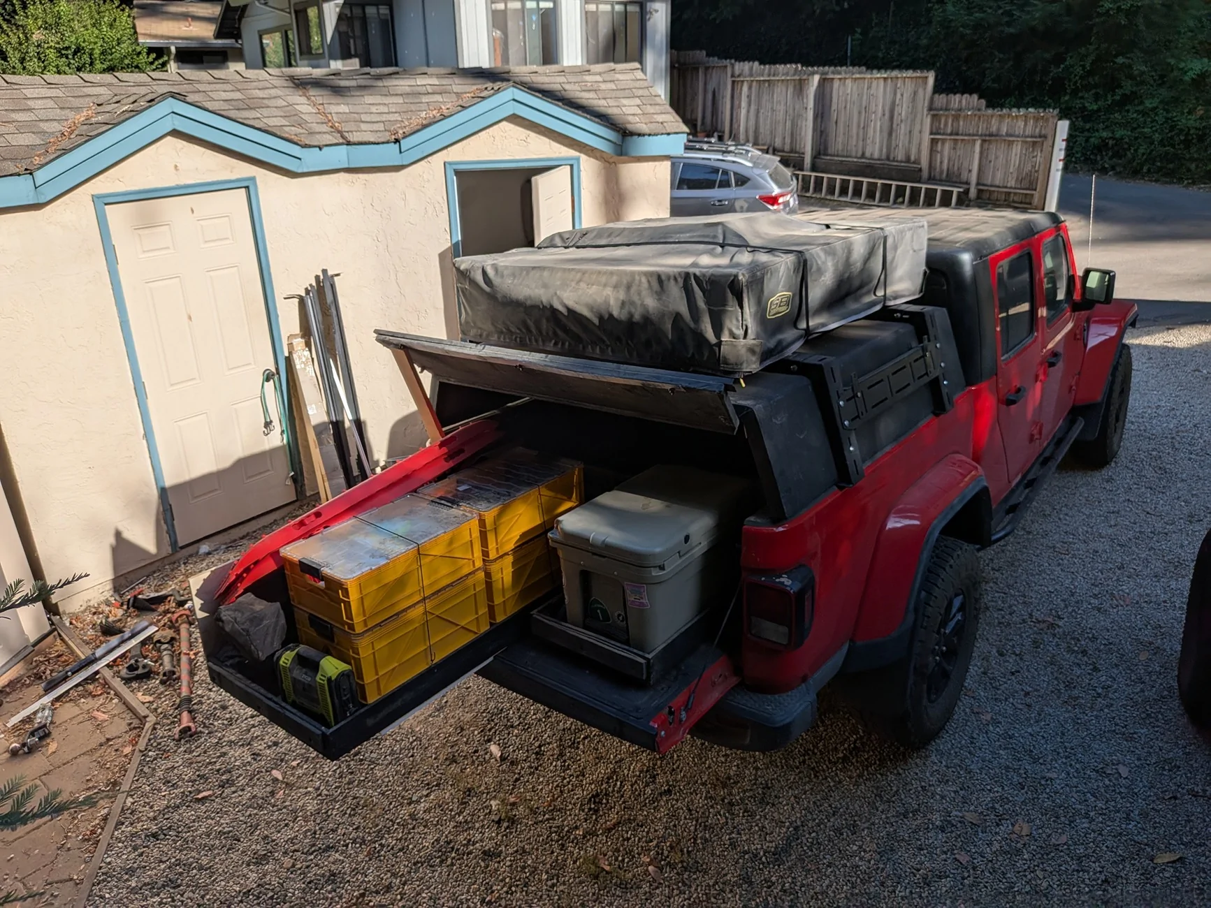

This is about 6 months in and still going strong. Plus my pull out drawers.
Jeep Gladiator My DIY camper shell - Poor man's fiberglas, light and cheap PXL_20250730_002852410
Feel free to ask any questions if you have them! It was a good learning experience and I would impart a lot of knowledge to a future builder of one I wish I had.

Things that haven't held up:
The hinge I got was "waterproof" but it's rusted to hell. I have an aluminum one to go in. Just need to swap it out.
I originally used gas struts to hold the door open. They failed quick in the elements and were really hard on the foam.
The main flat top area has a bit of a bow. If I did it again I would build more of a frame first and have a crossbar in the middle.
What's held up well:
The paint and shape. It's taken a few tree branches and I've dropped and and things on it and it keeps on trucking.
The door. I totally expected the door to wear or break over time. It hasn't. It kind of just works still. And it's set up like old jeep hard tops where closing the gate holds the door shut.

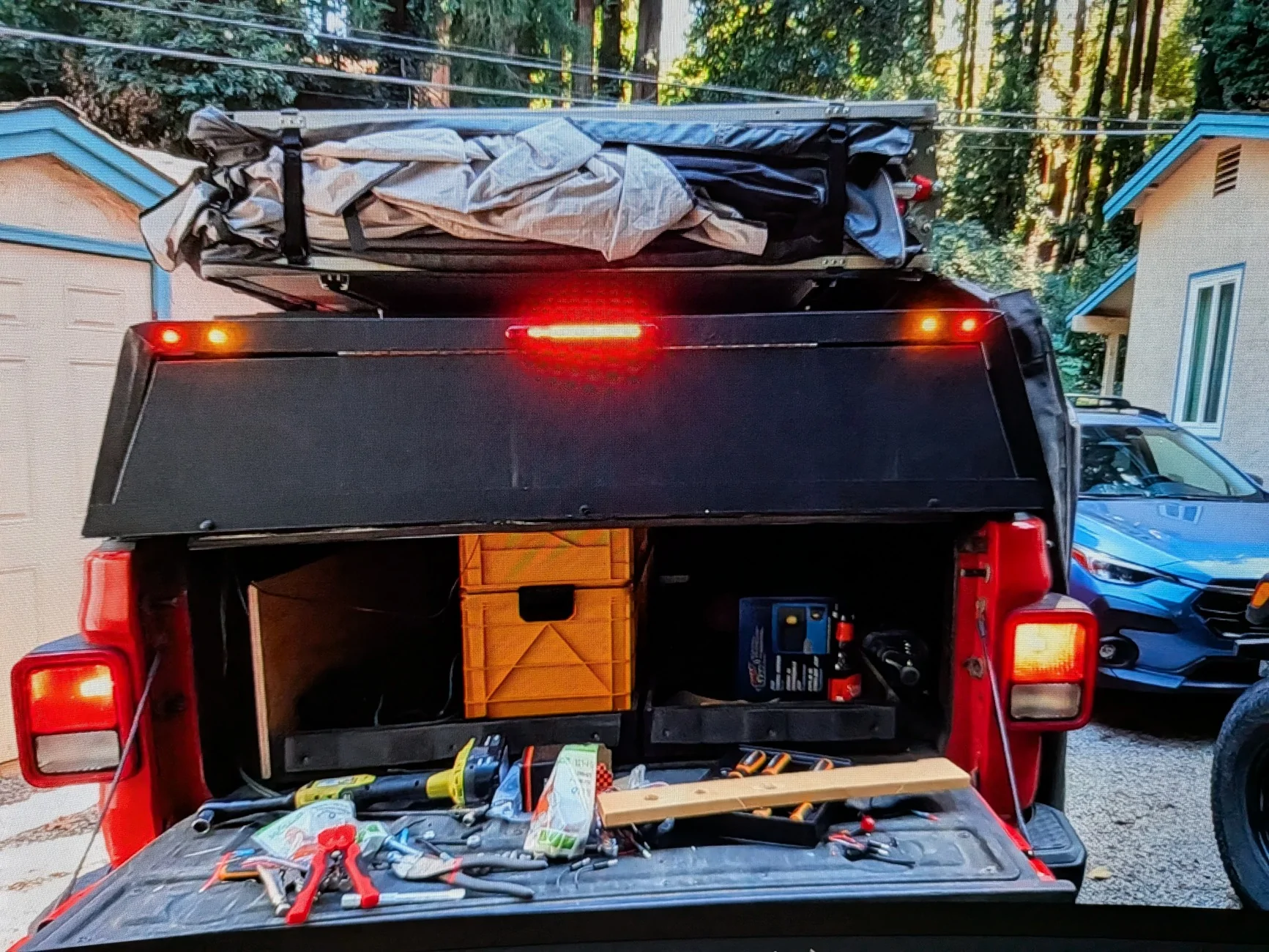

I wanted to get a new photo to post but I haven't been home since I started this thread. So screenshot it is!
This is the lights setup I have.
The middle brake light is controlled by a single relay. The amber lights are used for turn signals but I intend to plug a flasher in for dusty chase lighting setups.
Let me know if you want the wiring drawn out for the relay setup. The whole thing just plugs into the 4 pin trailer plug.
