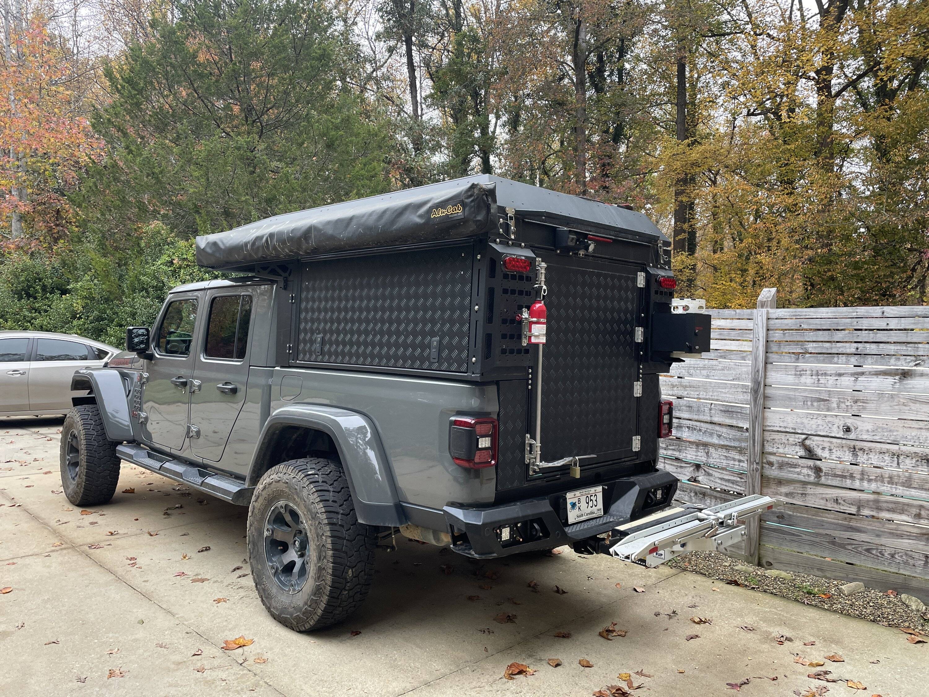

When I had my canopy camper, I bought the trailer plug extender and wired extra lights to the camper. They were very visible. Now that I have a contour canopy, I am looking for a smaller version light so I can do the same.
For now, I run a 1Up USA rack and they offer a light that attaches to the rack. Running light, turn signals, and brakes.
