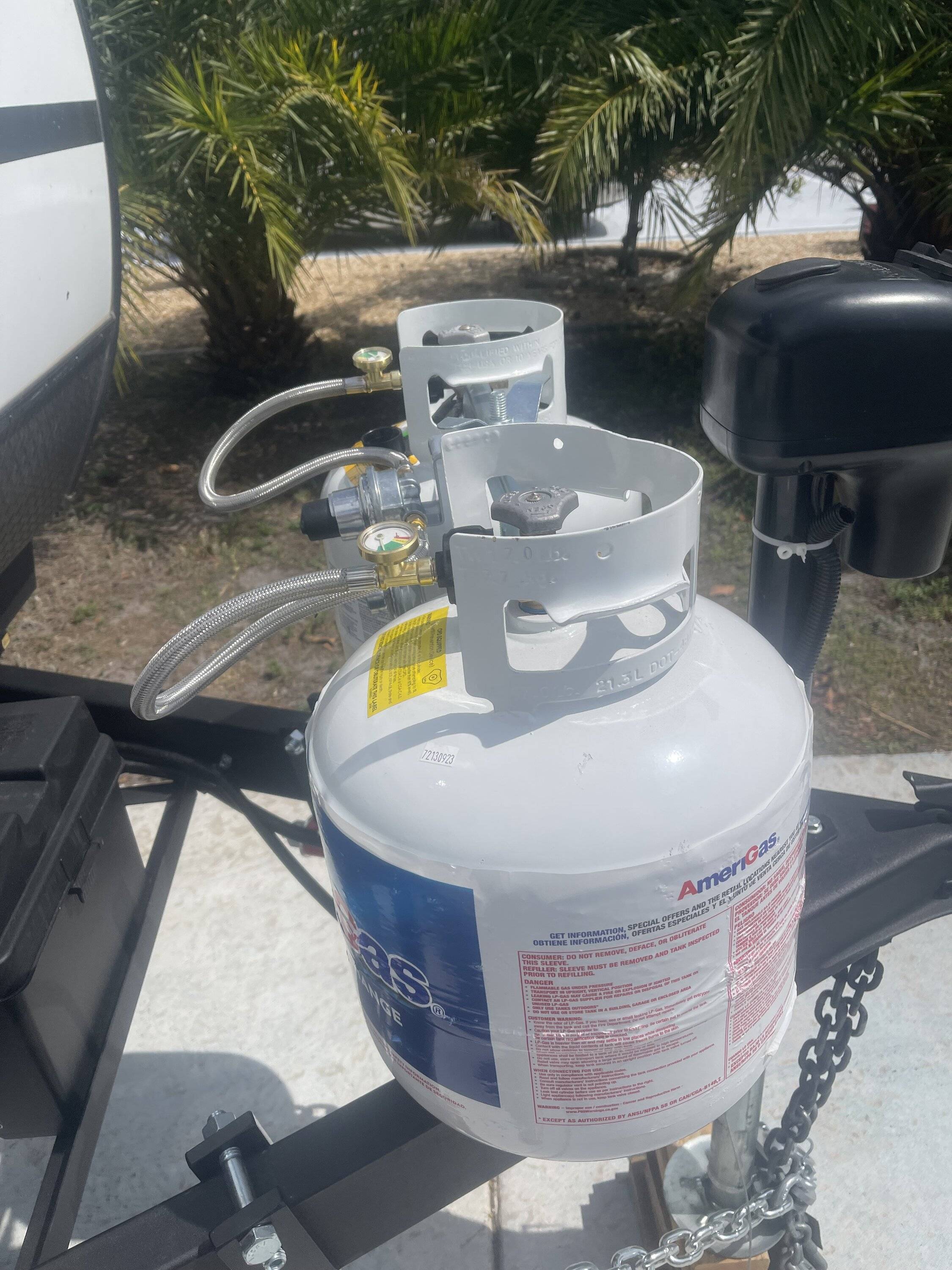

it took me three months to get every thing working, awning had a loose connection ( I never did locate the fuse) and would not extend (worked great at acceptance), propane for water heater wouldn’t kick in, hot & cold water valves were reversed in shower, and a tiny leak coming out of water heater.I did add a second propane tank. I also added temperature monitor so I could see. Fridge and freezer temps in the Jeep as i drove. I do have a cover for the tanks.
