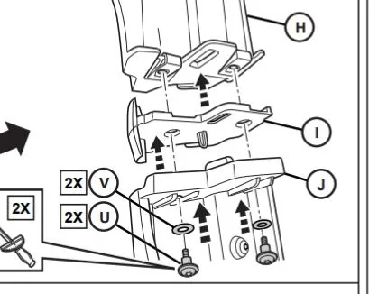

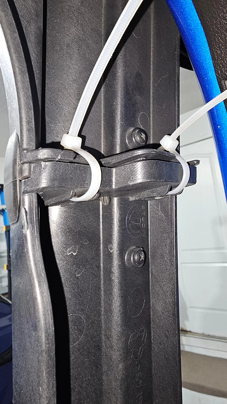

I just purchased a used soft top that came with everything except the 2 bolts for each sides of the rear door surrounds that hold the 2 piece design together. It doesn't seem I can purchase just that hardware alone. I currently have them held together with zip ties. Any ideas on where to source or maybe a similar bolt I can purchase?

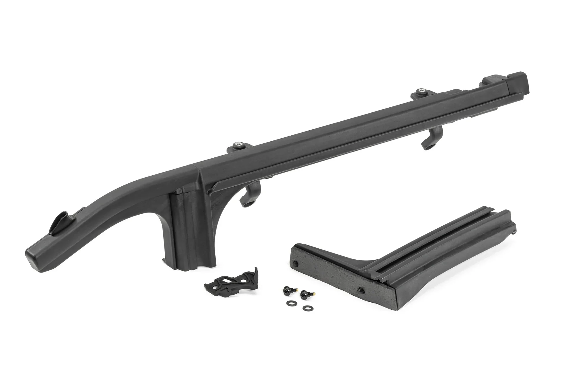

Unfortunately Mopar sells these as one complete assembly with hardware, They do not show any separate components.
Youll need some shoulder bolts, Probably a M6 size based on what I can tell

Try Lowe’s, Ace, or Home Depot, in the bolt bins. Hardware section. Measure the thickness of the plastic it goes through, and add about 1/4” for the threads to stick through and put a nut on.
