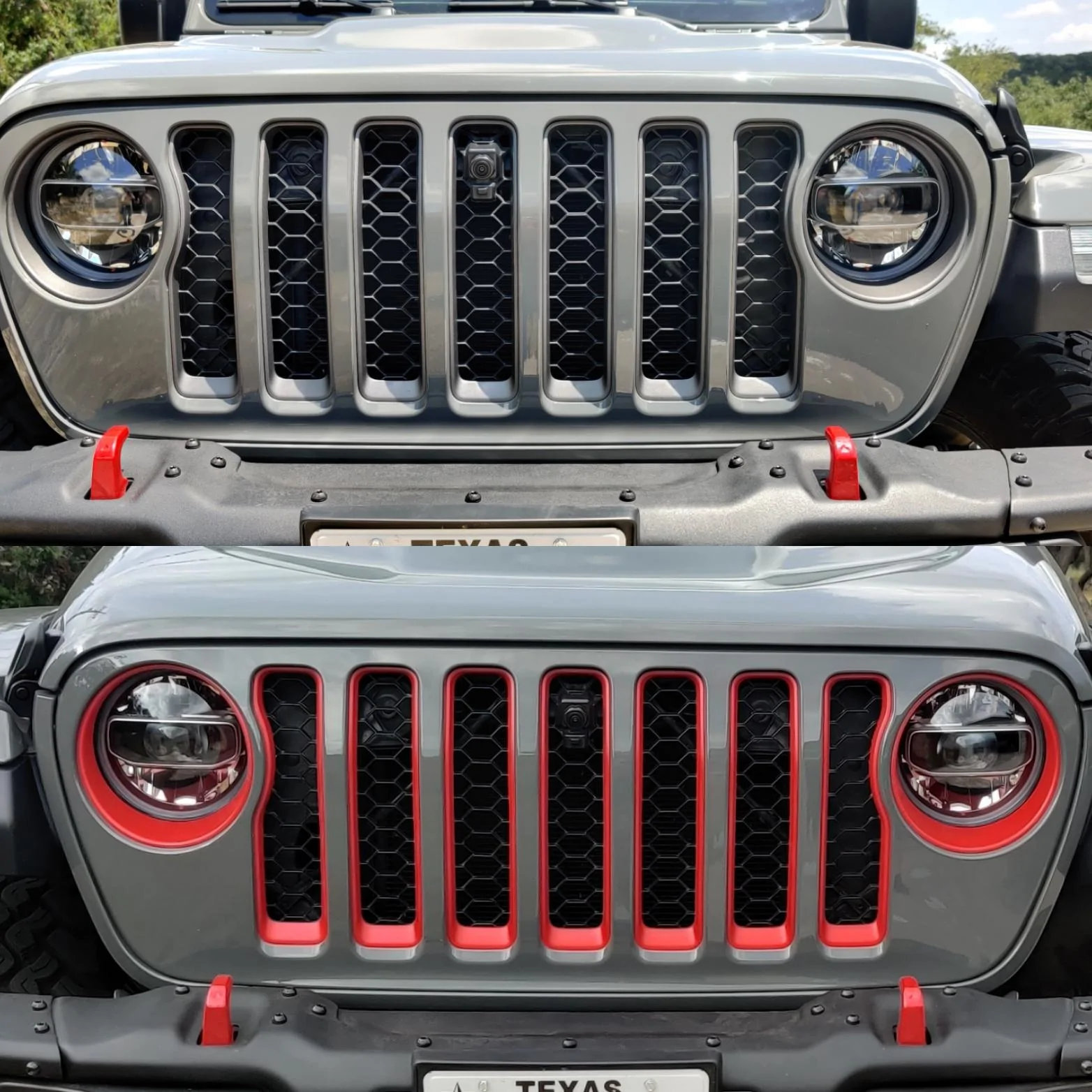

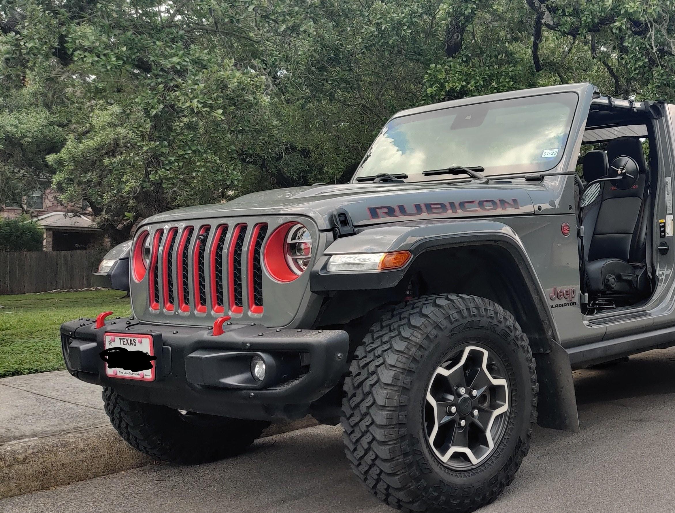

I used Rustoleum "Gloss Red" to do this. I started with actual Plasti-dip brand, and the red was very orangey and pale--almost salmon-like. The Rustoleum is much closer to the factory red on the hood decals and tow hooks. Taking the front end apart is extremely easy--just be sure you have a set of coated or plastic panel tools because screwdrivers can scratch. It's really pretty idiot-proof; put down several coats to get a nice thick finish and if you don't like it, peel it off and try something else. This is what you see in the "side by side" picture--the peelable Rustoleum.
You can also take the insert to a paint shop and have it done for about $80-100 with a proper multi-step process finished with clear coat. That's what you see in the 3/4 view with the doors off; I got tired of the peelable paint needing to be redone and had it done professionally. The look is similar either way; this way has proven to be more durable.
You can also take the insert to a paint shop and have it done for about $80-100 with a proper multi-step process finished with clear coat. That's what you see in the 3/4 view with the doors off; I got tired of the peelable paint needing to be redone and had it done professionally. The look is similar either way; this way has proven to be more durable. View attachment 246993

The Rustoleum I used is designed to be peelable; it's just their version of Plastidip with a deeper red. It is supposed to be good for about 6 months; I started to notice some little blemishes from stones and thin spots from trying to clean smashed bugs.
I thought Plastidip's red was a poor match for the factory red--it was too orangey and pale.
Any peelable paint will look good for several months, and it's something you can redo in a couple hours. I even thought about changing the color seasonally but ultimately decided to go with the permanent paint--so red it is.

I didn't answer part of your original question about paint prep. I did not sand the grill insert. I only cleaned it well with soap and water and then wiped it with rubbing alcohol to remove any residue. The peelable paint adhered fine. I'm not sure what the body shop did when they painted it professionally.
The trick with peelable paint is to apply a lot of thin coats in fairly rapid succession--you eventually want a thick film on there. I recall using the better part of two full cans to do the whole piece. If you do it right, when you peel it off it will come off easily and completely and the peeled paint will look and feel like a popped balloon (I know this because I did the red Plastidip first and disliked the color and took it off the next day to try the Rustoleum). If you go too thin, it will not come off as easily and you may have to use a solvent to get the residue off. Seeing as this residue/overspray was only on the areas that would be covered when I put it back together, I just left it there.
