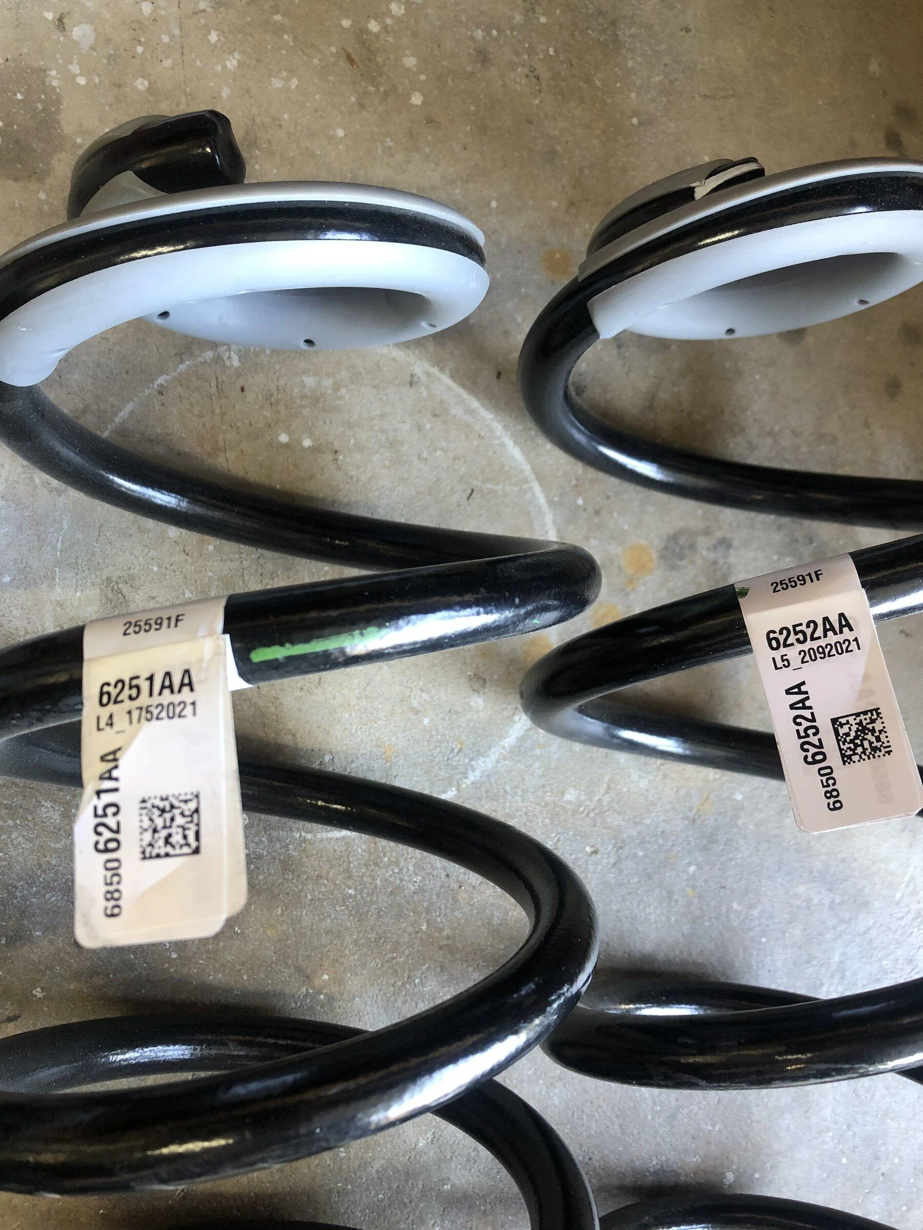

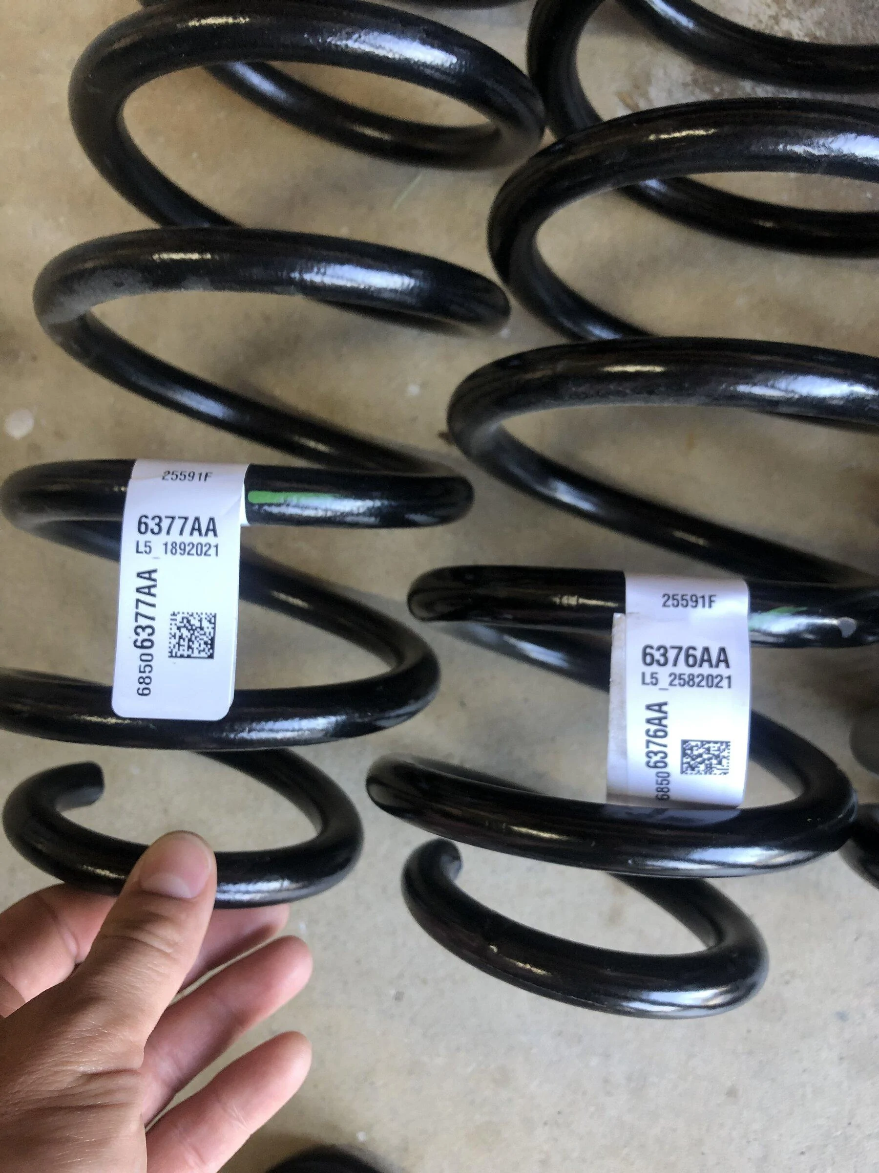

Got some take-off rubicon springs and shocks. I’ve done some searching but have been finding conflicting info on the part numbers. Need some help determining which springs go where.

I'm pretty sure those are diesel springs. And higher numbers go on the passenger side.
6377AA - Front right
6376AA - Front left
6252AA - Rear right
6251AA - Rear left

Yes, they are off a diesel going on my diesel sport. Thanks!

Turned out both my front springs were 6376AA already so I didn't even bother installing the Rubicon springs.
