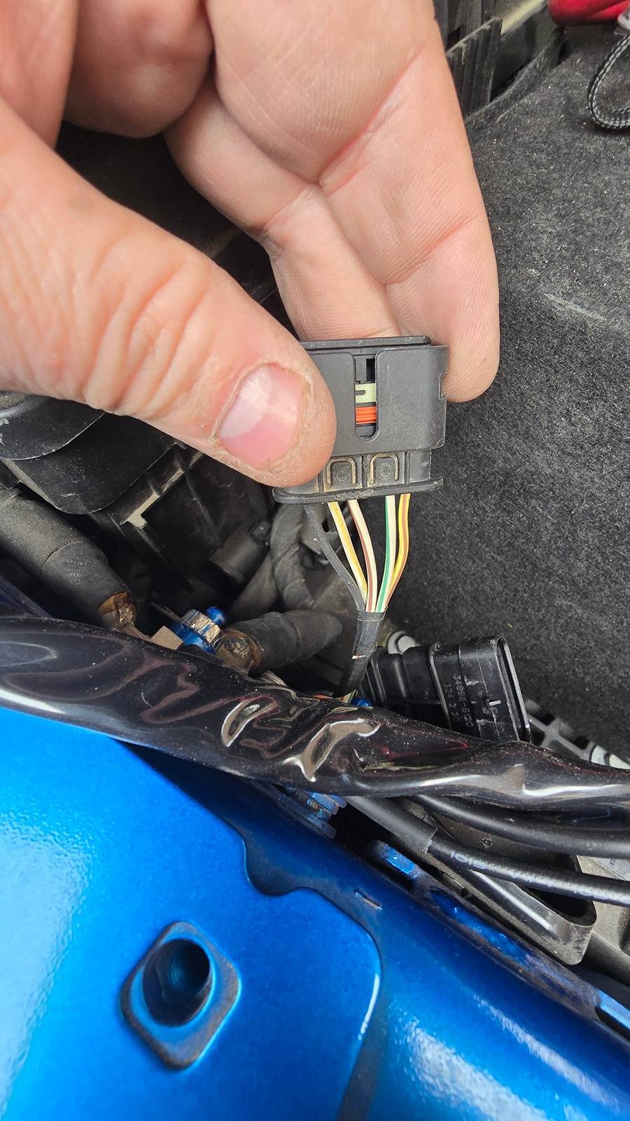

My colors were different verified pinout with volt meter
This is the right side (US passenger)
Forgot to take a pic but the left side is also white green
Jeep Gladiator Need park/turn wire colors for 2022 JT with LED lights 20240407_092205
