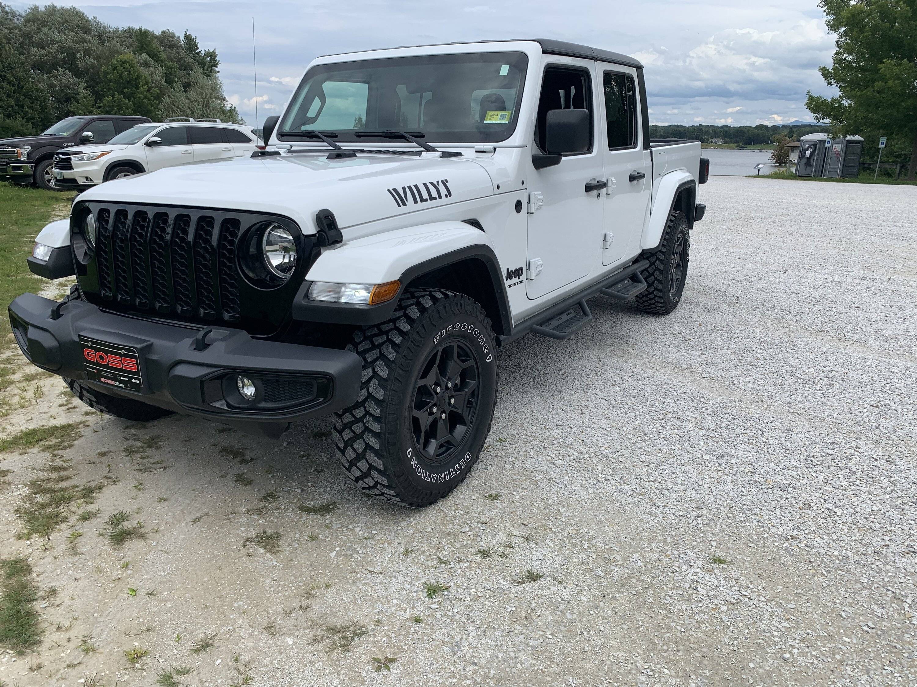

Just picked up a 2021 gladiator sport willys Automatic with Tow package. I am planning on towing a travel trailer weighing 4800lbs dry. I plan on towing this dry and empty at least on my first run. It’s an 80 mile fairly flat trip. Gladiator is rated for 6000lbs I will be installing a brake controller beforehand. Any advice or concerns would be greatly appreciated to this gladiator newbie.

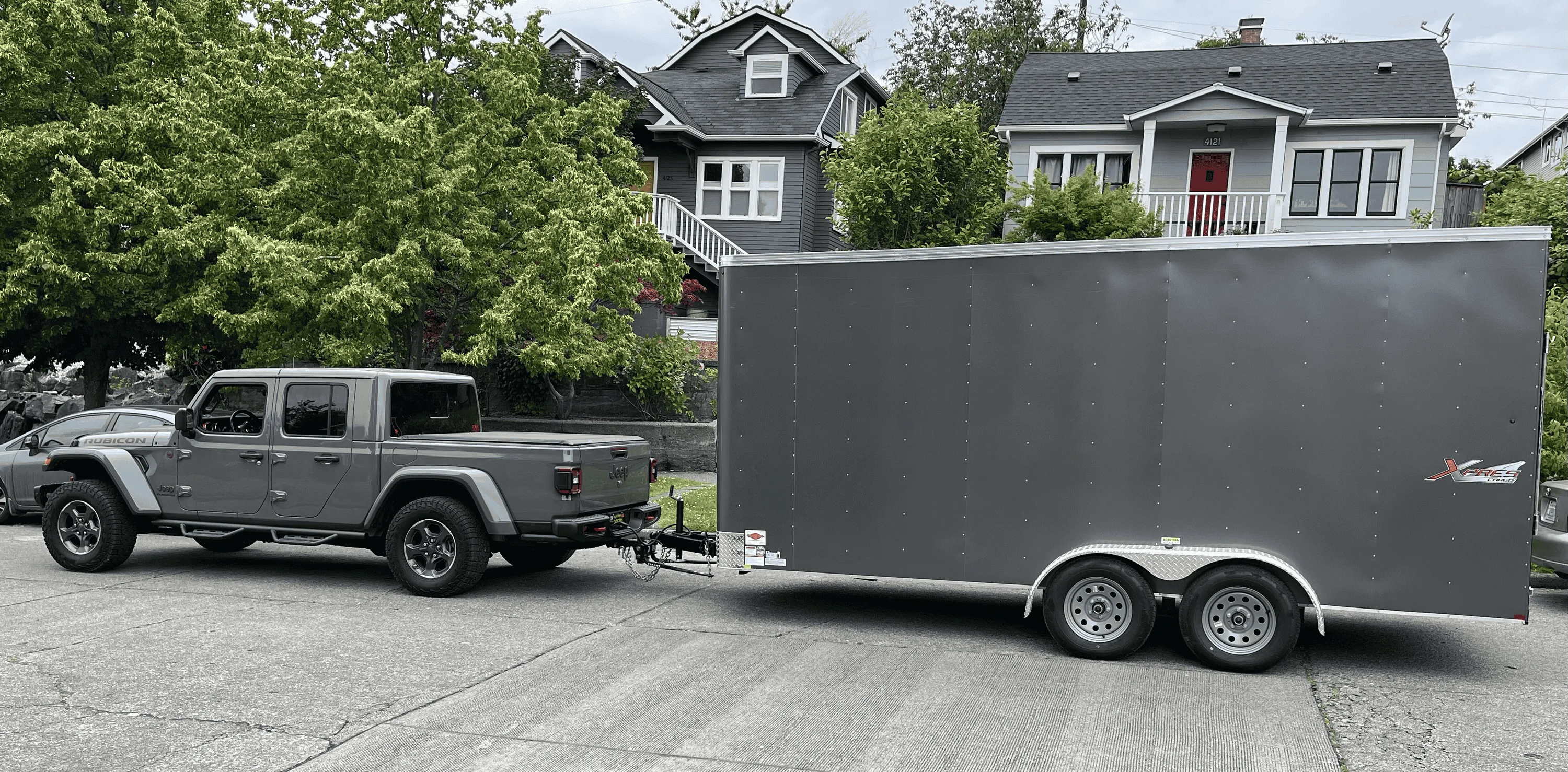

THIS trailer was almost exactly 4800 lbs loaded with a house full of furniture. Towed it last June from Seattle, WA to Atascadero, CA so well over 1000m miles. Not a single problem. My truck is A 2020 JT Rubicon. It's
Jeep Gladiator New 2021 Gladiator owner tempImageU5CYaT
totally stock.
I bought a Curt blue tooth brake controller and it worked flawlessly. Pricey for as small a unit as it is and I no long have a use for it but I didn't have time to install a hardwired brake controller before I left.
PS: I bought airbags for the rear of my truck but ran out of time to install them. They're still under my bench in the garage. I'll probably end up installing them at some time in the future before I sell it, ha ha.
