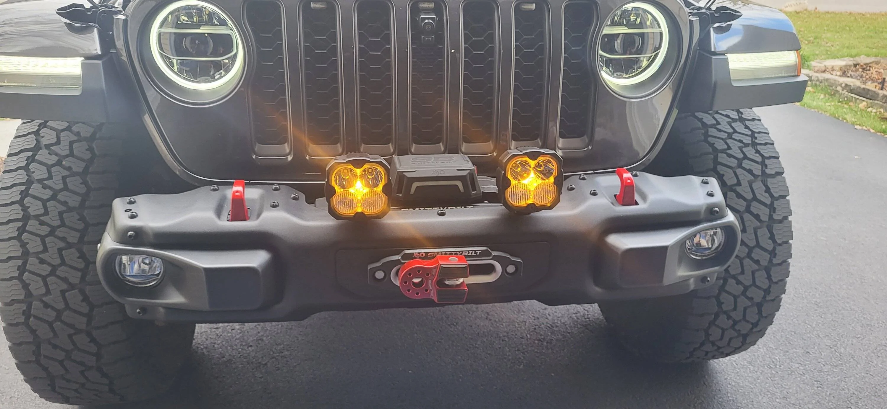

Thanks , this not what I'm wanting to do. I'm wanting an after market winch bumper. Most don't have skid plates. Wondering if a OEM mohave skid or a Rubicon skid that goes with a plastic bumper will work with these after market bumpers? Thanks for your reply.
I just notched my Rubicon skid plate to fit the new metal oem bumper
Jeep Gladiator New bumper 20231208_122443
Jeep Gladiator New bumper 20220410_133208

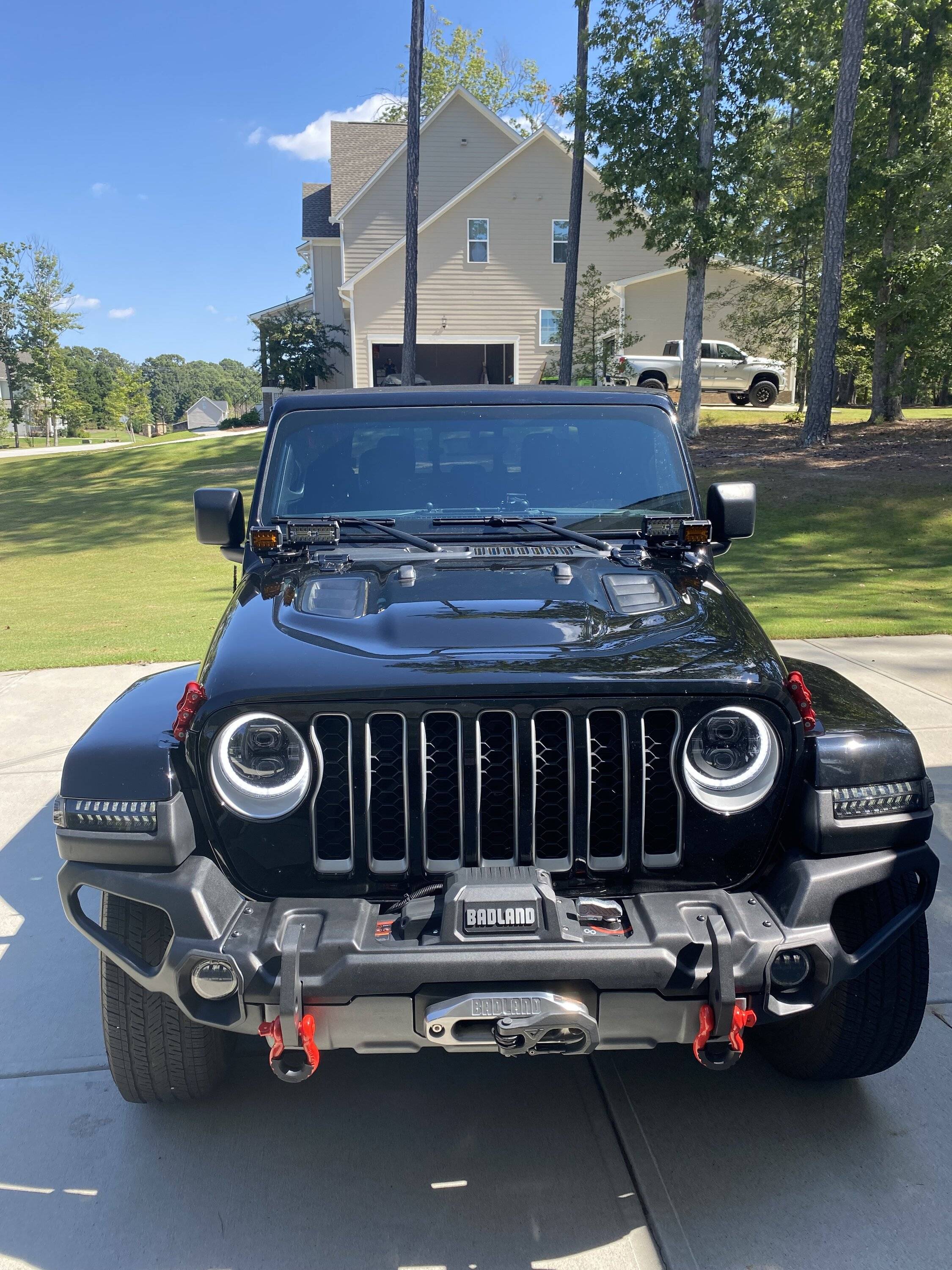

Manufacturing
My Rubicon came with plastic bumper and metal skid plate. When I installed my LOD bumper I had cut off about 1/2" off the front of the skid with grinder and cutoff wheel but it fits and looks fine
