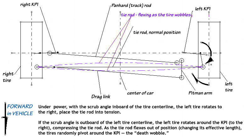

Here is one explanation (there can be multiple causes or reasons) - when things flex, geometry is changed, etc. -

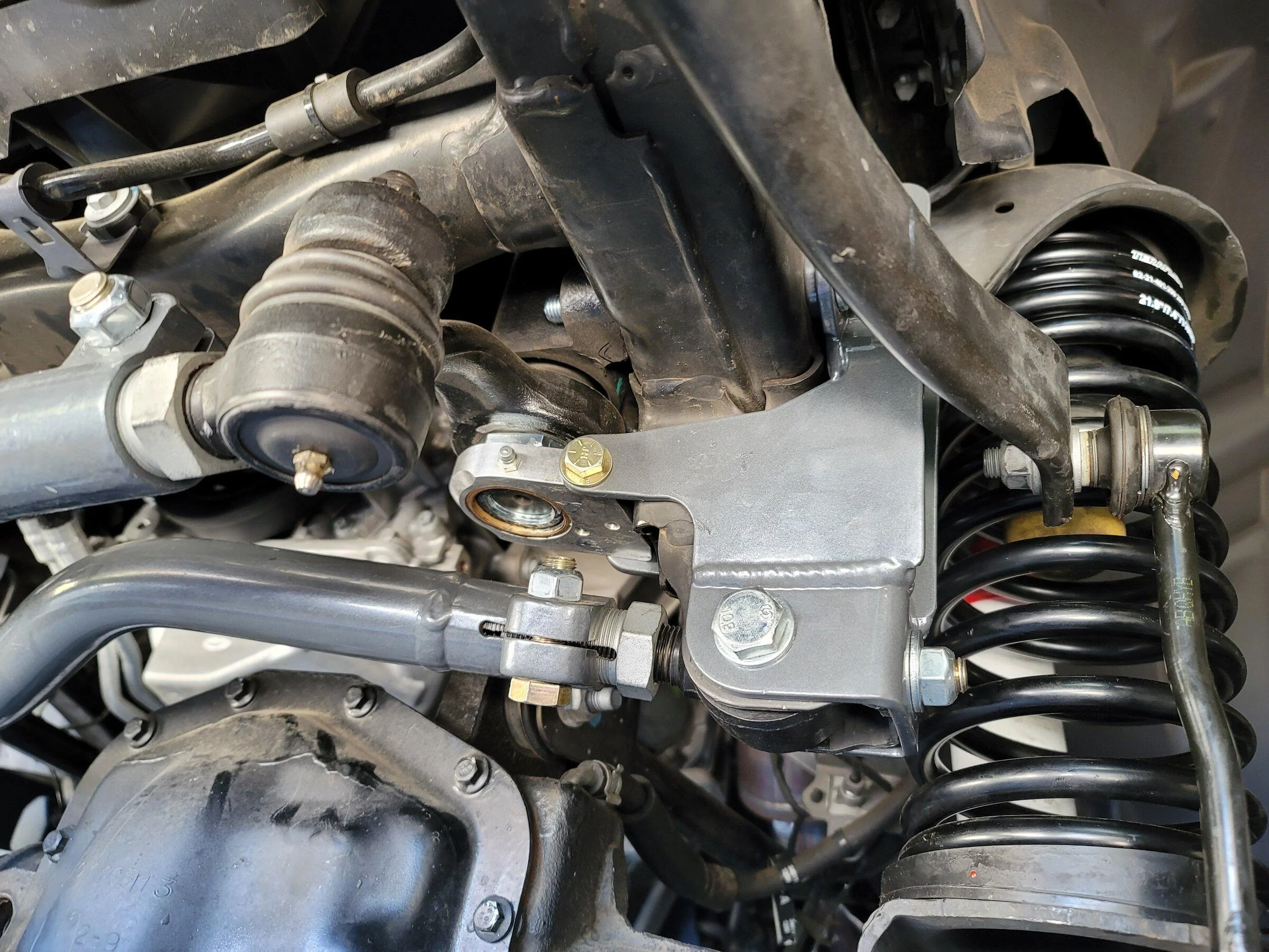

So.....OK. Got this Bad Boy mounted in there last night along with retorquing all the ball joints and TRE's, and going to the next slot on the castle nuts. Work is getting in the way, so no opportunity to see if these have done anything for the DW. I'll let you guys know........
I look forward to your results.
