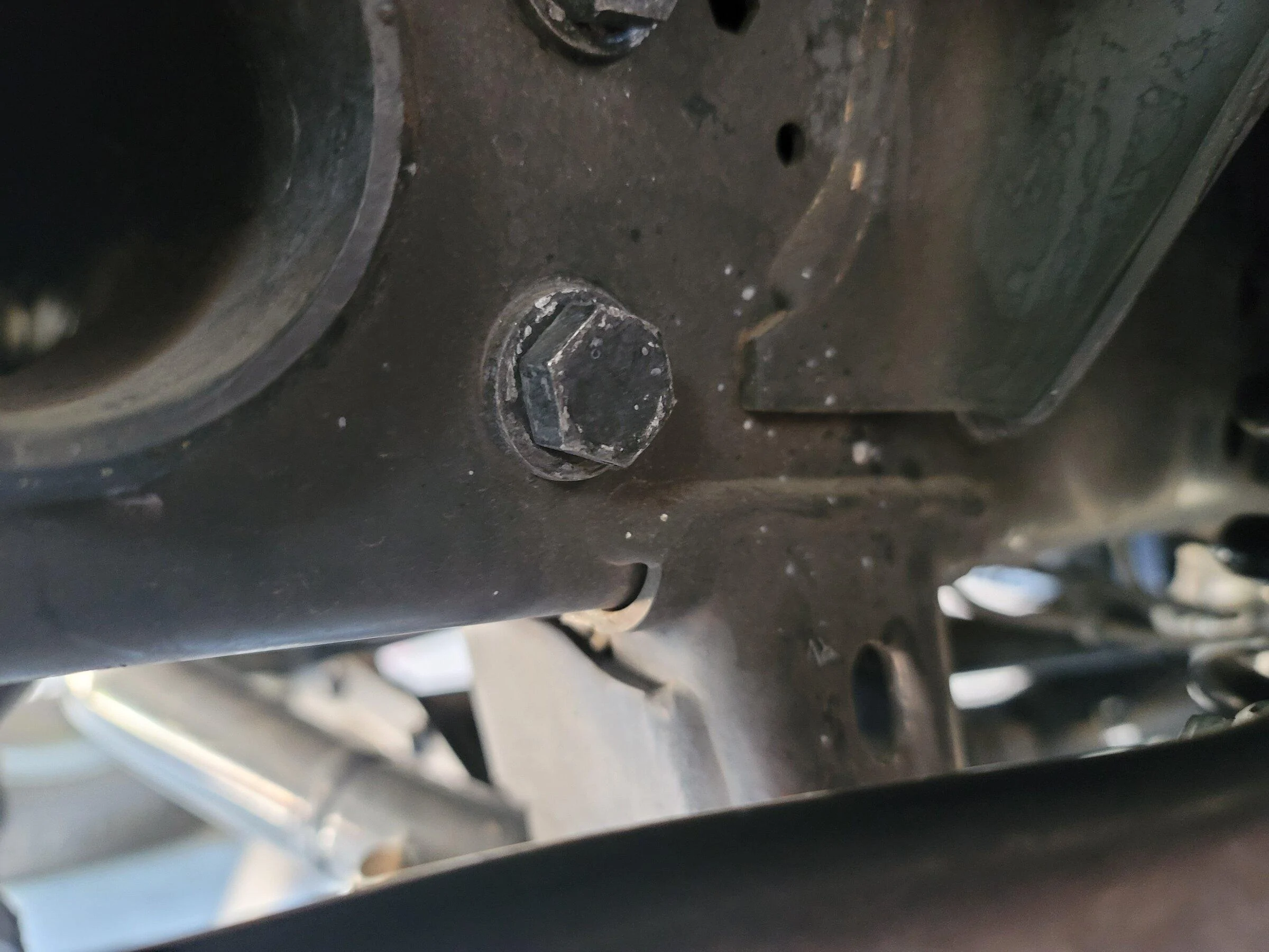

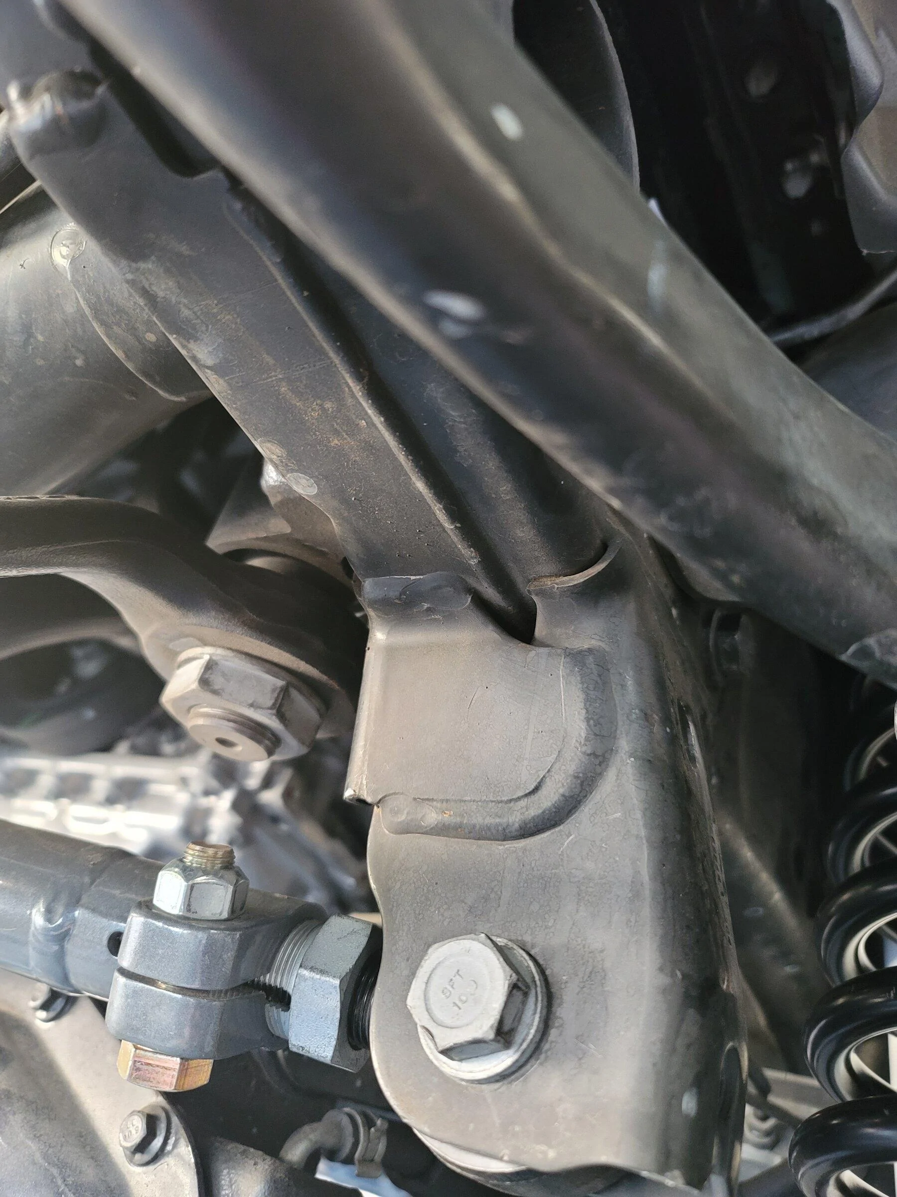

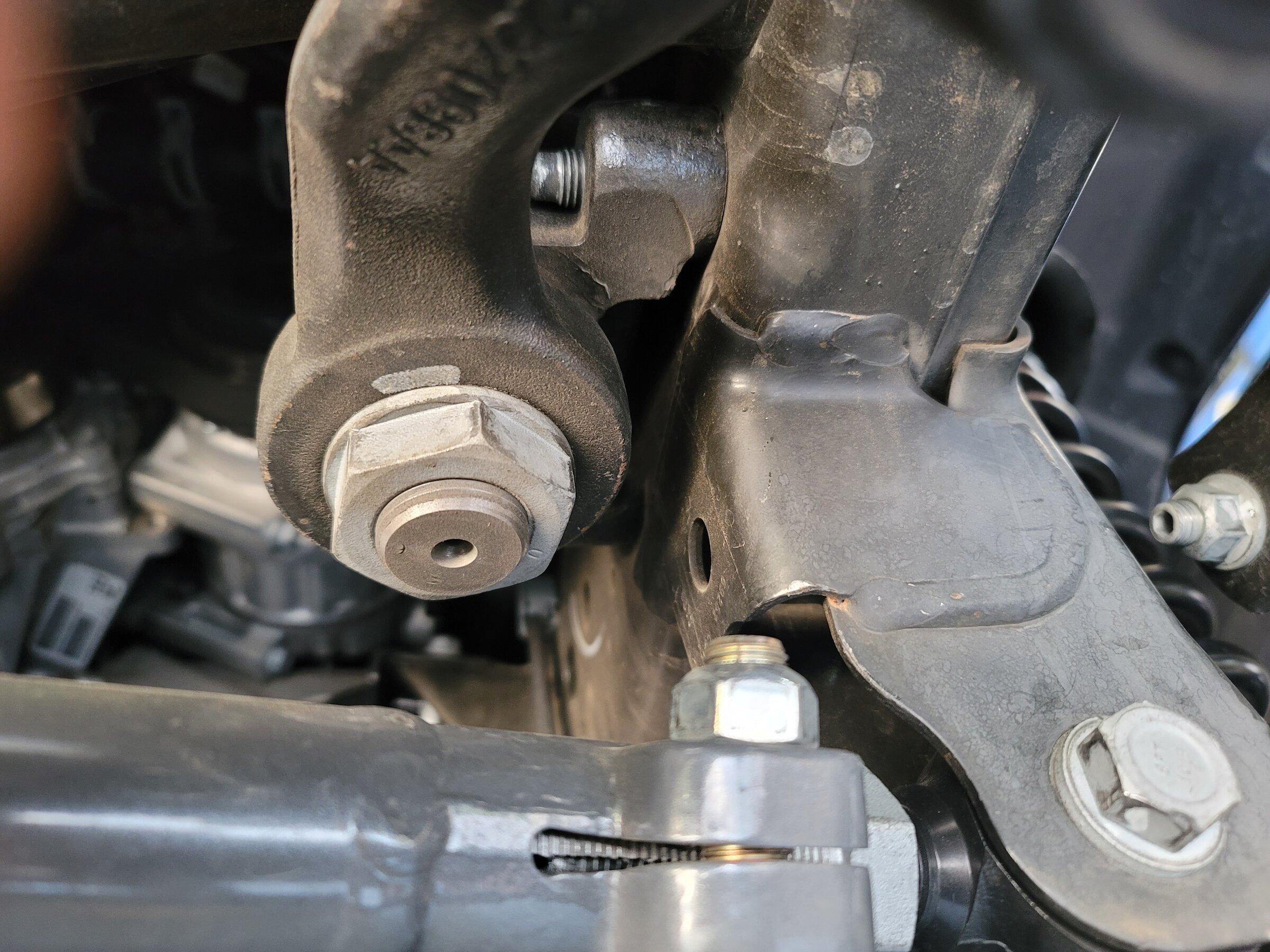

So......I've conversed with several of my old wheeling buddies at the Arizona Virtual Jeep Club. I sent out a bunch of pictures and we did our online analysis. 99% of the time DW can be attributed to the Track Bar. These guys have the experience to prove it. The stock tires don't help, but neither does the anglular changes that occur when lifting. The track bar and drag link stayed aligned due to using the same manufacturers products, so something else is moving. I'm going to try the Synergy Track Bar and sector Shaft Brace Kit (8869-01) and see if that helps.........It makes sense. I'll update this thread once I have it installed and tested. Look at the pics attached and you tell me if that doesn't look like it would want to move under stress.
Edit.......I shouldn't say 'moving'. It feels like something is flexing, like a spring.....
