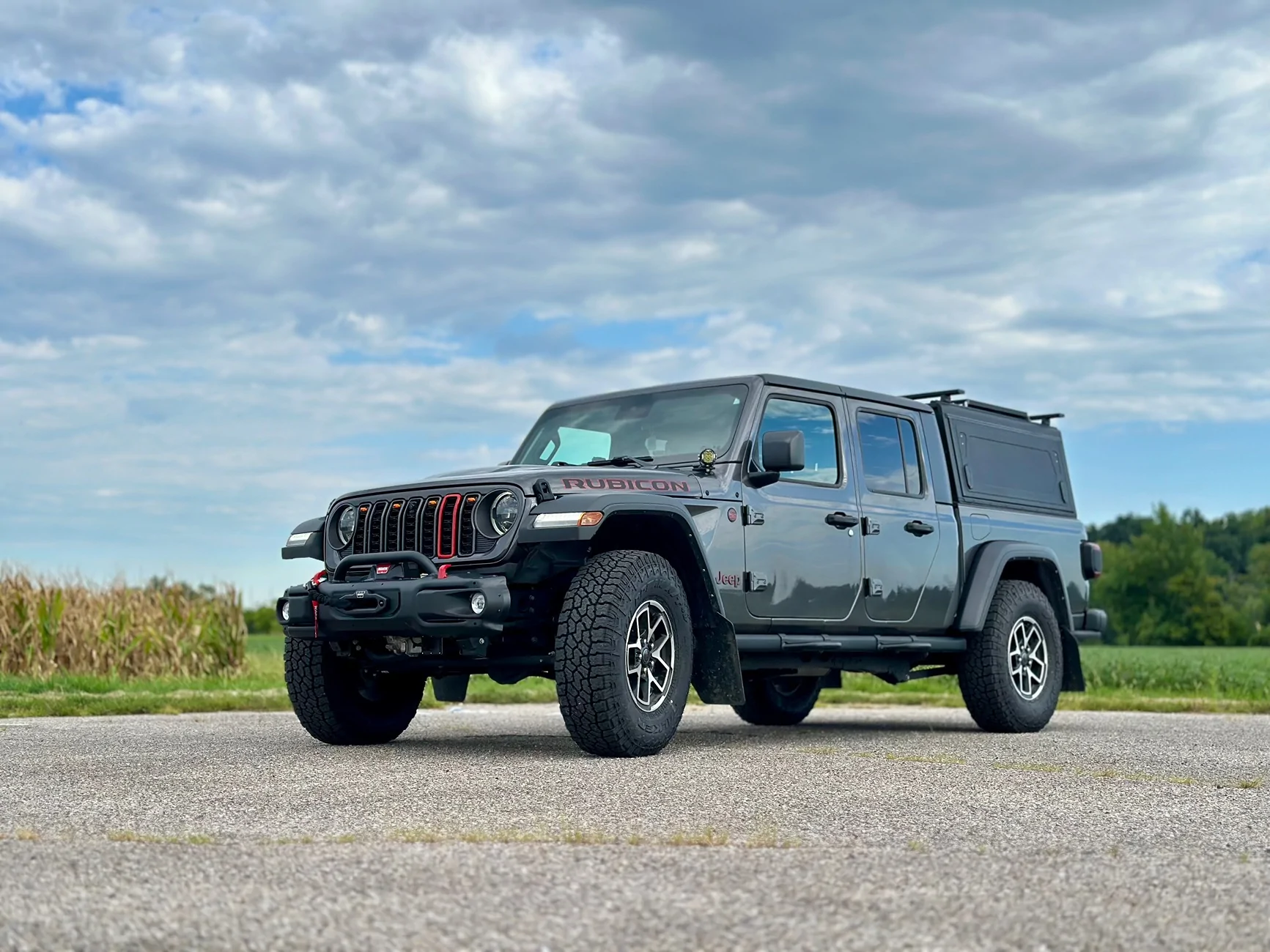

35s will fit on a stock Gladiator Rubicon (just had some 35x11.50R17 installed). There are LOTS of Rubicon “take-off” suspensions on Fb Marketplace around here for about $200. If you don’t intend to go larger, that may be a good option. If you don’t have a swaybar disconnect you probably won’t have problems with flexing into your fenders.
If you just want tire clearance, a spacer lift will probably work. HOWEVER, for moderate off-roading, 33s will get you a LOT of places and no modifications required.
