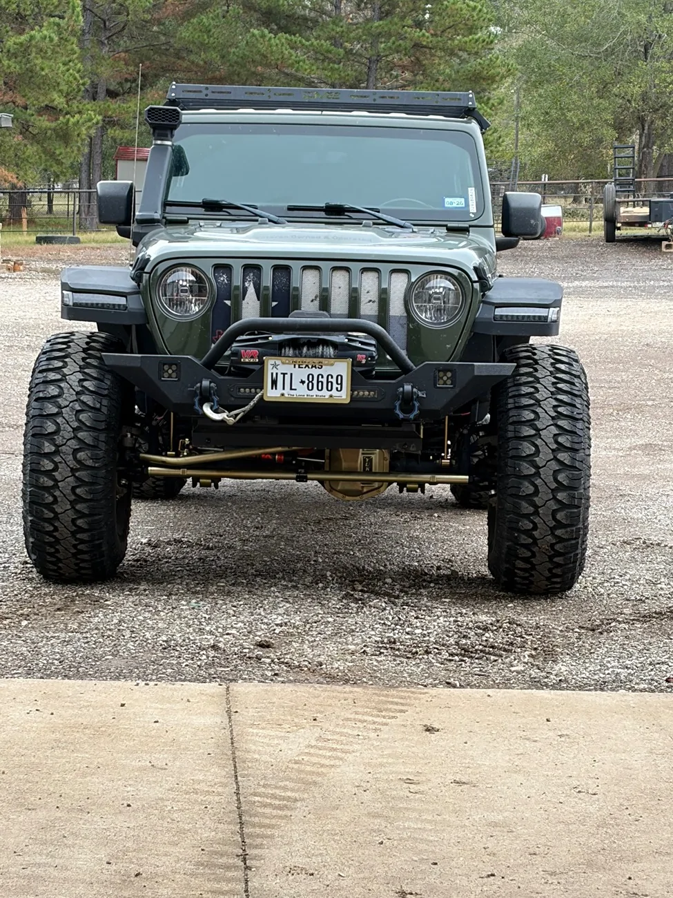

Well. I bought a new bumper & fenders.
lighter. So see if that helps. &. I’m going take roof rack off. To see if helps.

So update. If anyone interested. Got swamped at work. So never took roof rack off.
But. Nothing changed after lighter bumper & fenders
I went to 40’s. &. It went up to 14.2 mpg. Not bad.

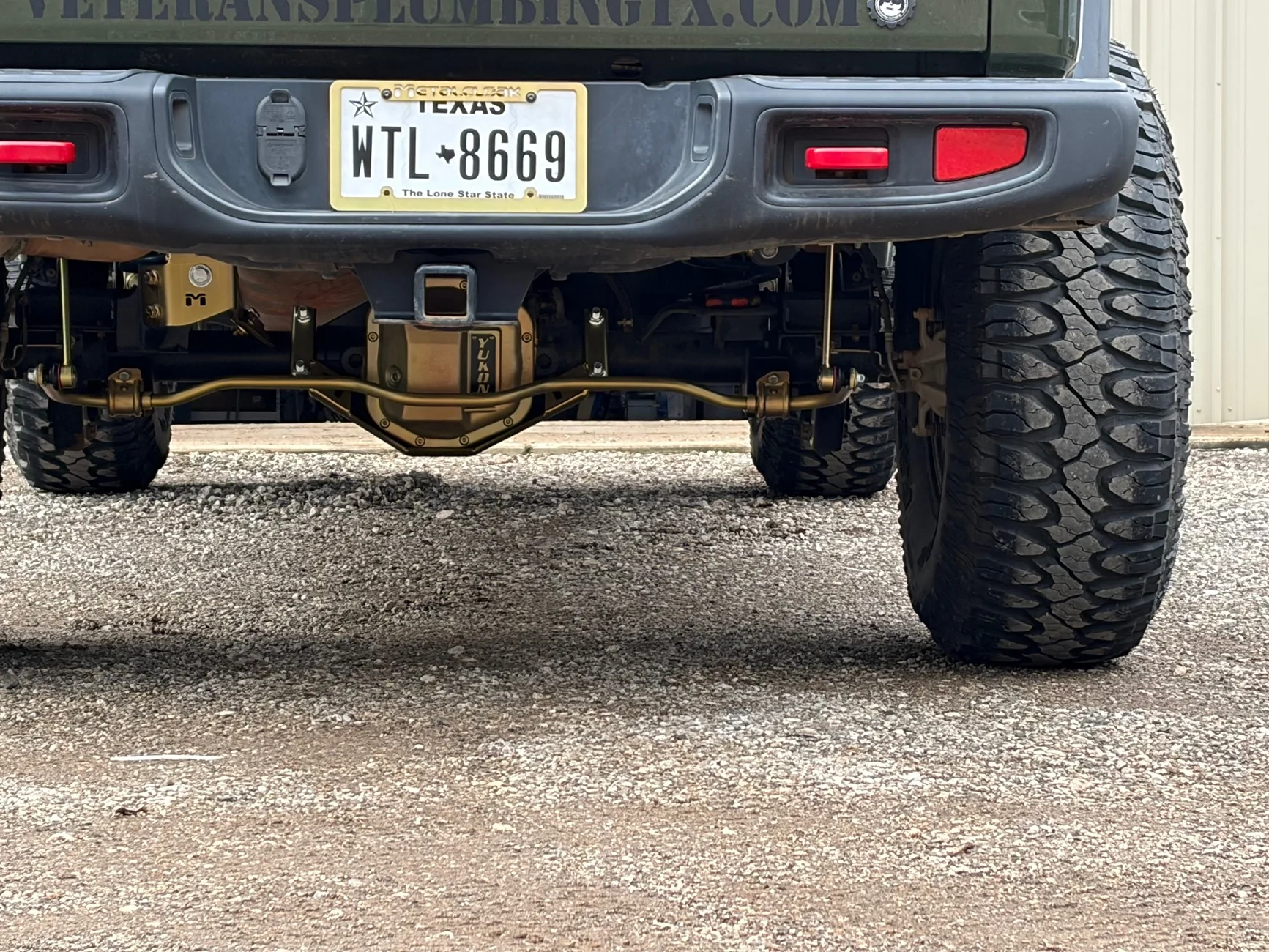

now. I upgraded everything underneath to metal cloak. &. Got rid of spare. Fig help off set the added weight of heavier parts.
now.
I’m avg. 13.8. That sux. But looks cool.
Not great still better than the 12. I was originally getting.

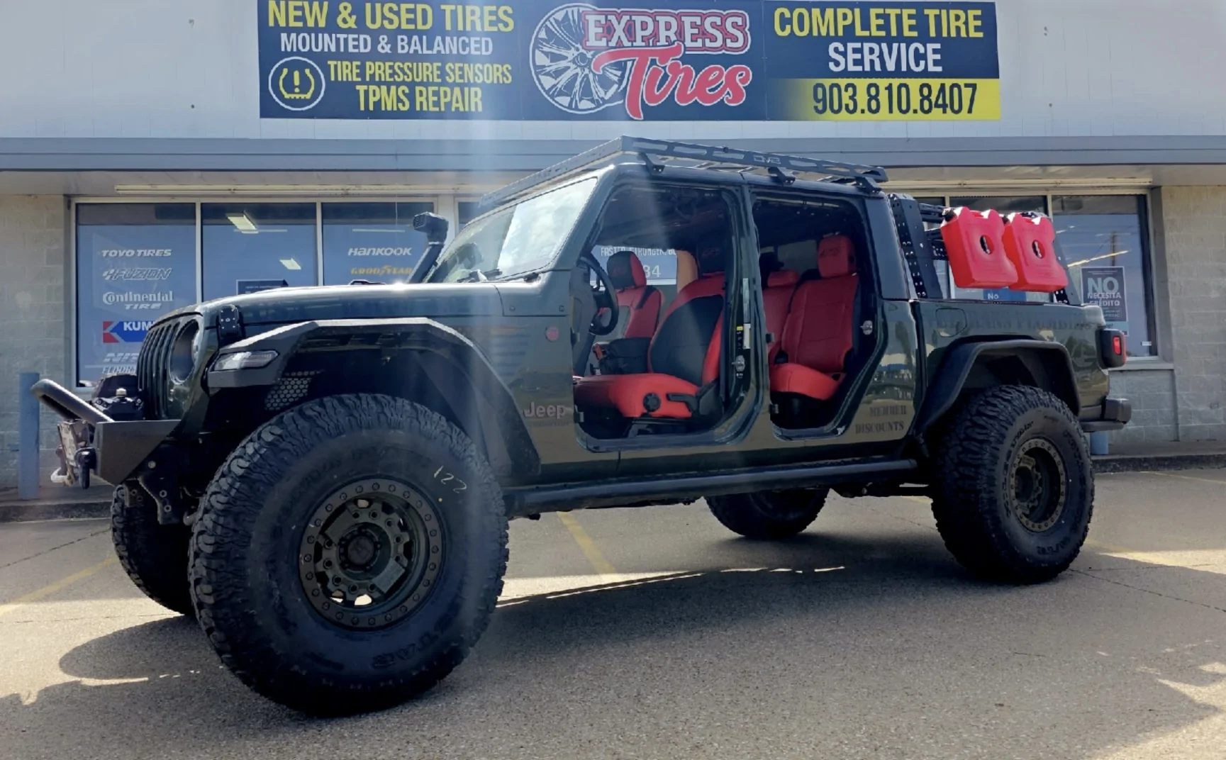

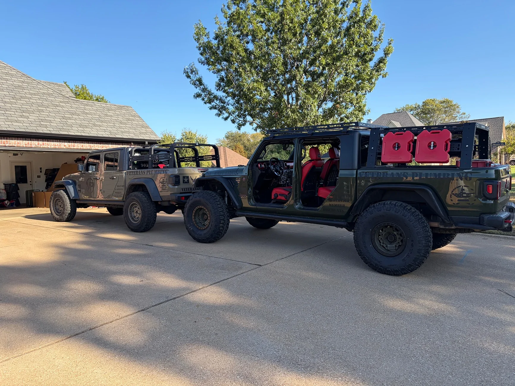

How bout some pics of the four-deez?

Good looking rig neighbor.
