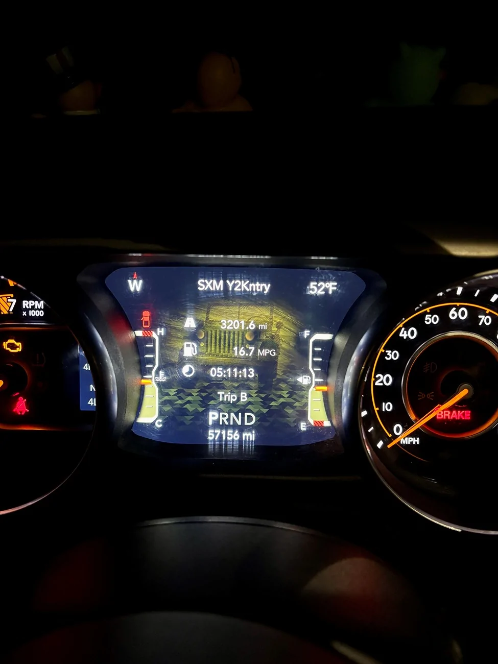

I was told by the dealer they could only calibrate to 35's which is what my dealer did when I went with the 35's when my jeep was brand new (dealer installed Mopar 2" lift and put my 35's on that I brought them). When I went to 37's back at the end ob May, they said no can do as even the JL Recon's only had 35's.
Had to buy a Tazer to calibrate the 37's.
In the 3200 miles I have driven with the 37's on a 3.6L and 4:10's, I'm averaging 16.7mpg.
Very little highway driving.

They’re lying. But that’s what dealers do, so I guess it’s in the training.

Switch from the Midwest to mountains and that will drop to 13.

Alot of times even with Tazer or flashcal the "37" denomination is not what you truly need put in the computer.
On mine for instance runny Mickey 35" MT's and when the flashcal plus did the auto calibrate it set it at 33.25 . Runs out really well and I average 18+ all the time. When setting them and you may well know this already measure the tire on the blacktop compressed with the jeeps weight and insert that as the tire size alot of times it will be less that what ypu think it is.

Yes sir. I’ll redo in new 37’s. Previous owner had set. Something like 36.7

Yup. BFG's are so small compared to what they classify them as. I think mine is set 36..2 or 36.3

They are, but they all act differently depending on pressure. I have my mickeys set at 36.0 and my Speedo is perfect. And they’re way larger than bfgs.

Thats more akin to what the flashcak set my 35's at choosing 33.25 and my speedometer is dead on also . I even GPS 'ed it .
