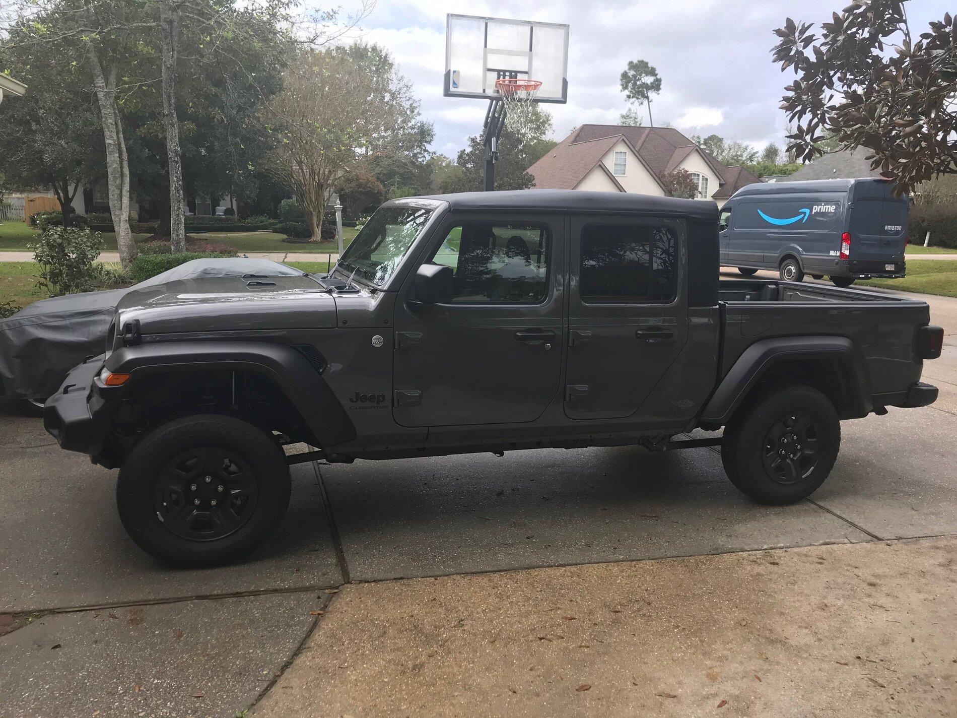

Added the Rough Country 2.5" level kit with the new springs, shocks and sway bar ends today. This kit had new springs not the puck spacers. Went on pretty easy took about 3 hours by myself. All of the hardware seemed reasonable considering the price of the kit was under $300 shipped. The jounce stop spacers are a bit on the cheap side. I will end up making my own out of Nylon or UHMW. Ride seems just a bit stiffer than factory. The track bar now shows about 1/4" offset. will probably buy an adjustable unit like I did for my old TJ. When I lifted it- it was off by over 1". Also ended up with right at 1" of Carolina squat. Will most likely just add the 3/4" spacers to the rear. It may settle some not sure.
Next the Vision 18" Nemesis 111 in black and 305 / 70-18 Yokohama Geolander AT-X
