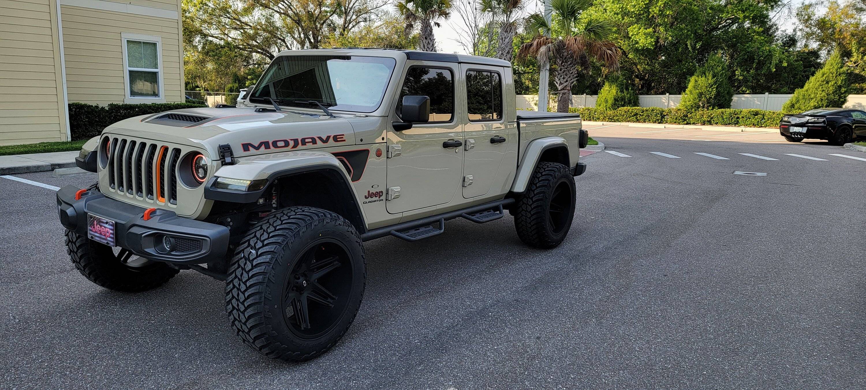

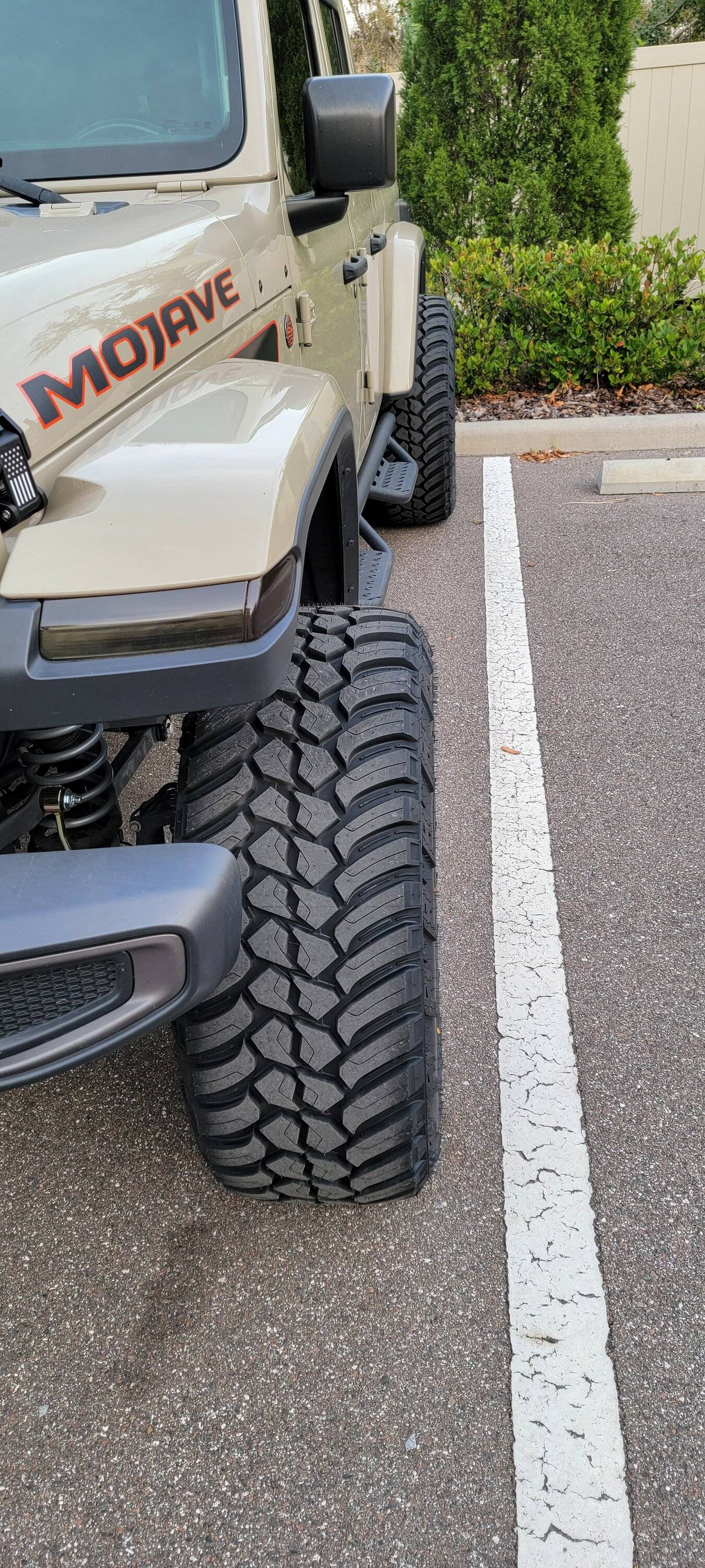

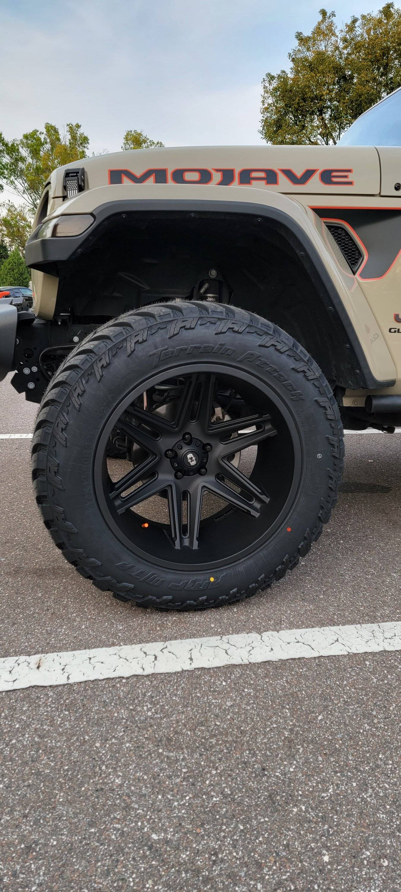

I just installed the 2.5" Skyjacker on my Mojave. No complaints at all about the kit. Easy to install. Clears 37s easily. I also installed Rough Country LCA brackets and adjustable track bar. I only wanted the 1" in rear, I'm not a fan of the factory rake look

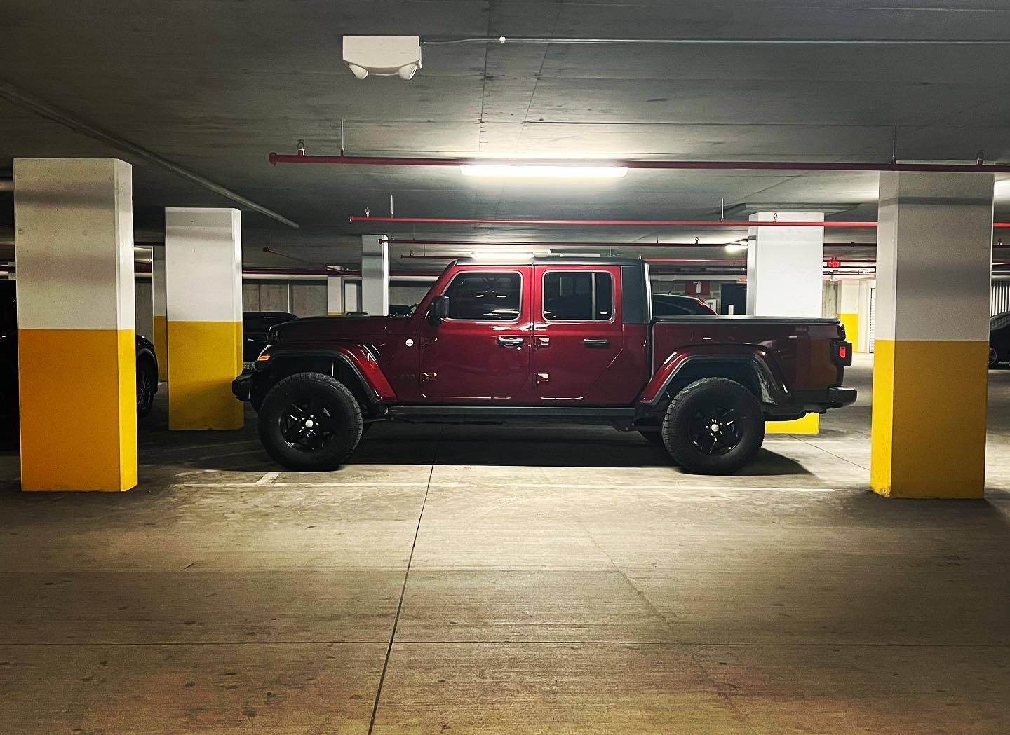

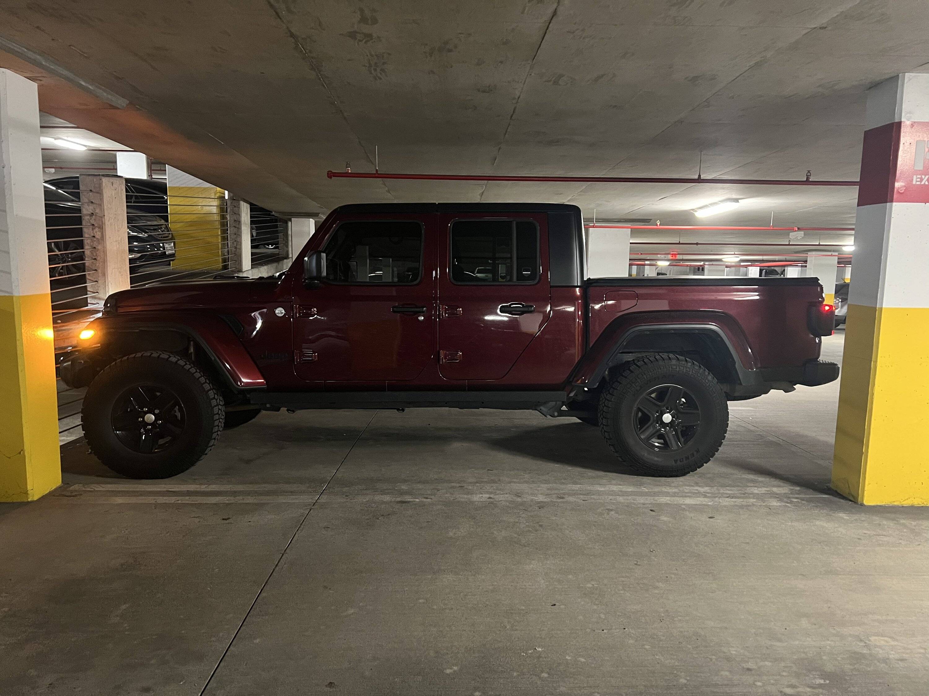

If you go with the spring lift variant of the RC 2.5”, then I recommend getting a bigger rear lift than .75”. Mine has it and is pictured below with the .75” (first picture) and the 1-3/8” Icon spacer (second pic)
RC 2.5” Springs and Daystar .75” rear
Jeep Gladiator Skyjacker vs Rough Country Level 3F5F8FD6-635A-4042-8E81-8749E4BE2071
RC 2.5” Springs and Icon 1-3/8” rear
Jeep Gladiator Skyjacker vs Rough Country Level 1220EC4E-51AF-40C5-8AF6-D9B706EBBD06
If you’re doing front spacers then disregard

The Mojave has a great ride from the factory and I feel like the ride is the same after the lift. The Mojave specific lift goes for $350-375 plus $100 for the RC relocation brackets. Easy to install and well worth it in my opinion.
The pictures posted are without any rear lift. Just haven't had time to install yet

In both pics the tires are 315/70/17 Kenda Klevar AT.

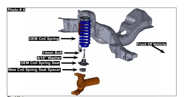

I ran the 2.5" SJ spacer kit up front for a while, and I did because of HOW it was mounted, under the spring, not on top. It did its job and I used the Jeep for Jeep stuff.
It was actually shown under a JL but worked great and was very cost effective. My buddy that owns a Jeep shop, also recommended it if I was going to go that route.
