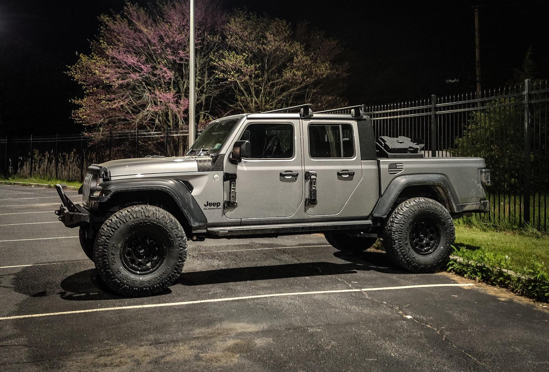

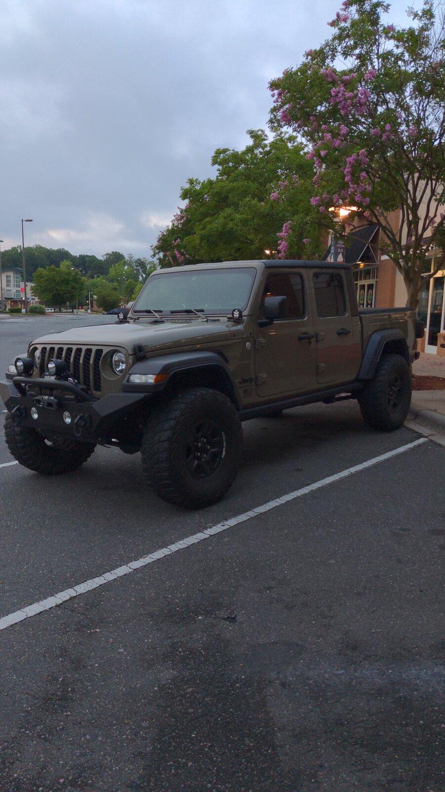

Just a bit of added info….After 2k miles on my RC 3.5 coil lift I put on the geo brackets and am amazed by the difference. The front wheels pushed forward just about 1.25” but it make a tremendous difference in how the JT soaks up the bumps in the road
I will probably install geo brackets, I ordered them and have them laying around somewhere. My toe angle was adjusted but caster is 2.5-3 degrees off spec. I knew it'd be off but its fairly significant. The brackets should help return the caster.
Nice pic!
Have you been on the highway yet? Mine with 3.73 and 35s only sees 8th downhill.
Yeah it seems to hunt for gears on the freeway when going over 65 MPH. I feel like the acceleration is nearly identical to the stock tires though, which is relatively slow lol.
I don't do a lot of highway driving so I'm good there. Most of my local roads are 55mph - it is fine there of course. If I had a long daily commute or went on a lot of road trips, would definitely have to jump on the regear train.
