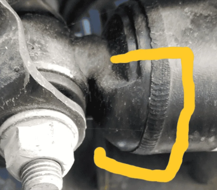

The shop states that the factory steering stabilizer is directional and has a sump or oil intake built into the casing and was installed upside down and causing it to suck nitrogen instead of shock oil, thus giving the stabilizer dead spots as it travels through motion, and it became aerated and the symptoms (wobble) presented during their test drive after installing the new steel steering box and breaking and replacing the clock spring. And they said they did do an update after installing the new gear box.
The Wrangler people, and shops, say once installed upside-down, it needs to be replaced.
There was even a recall for JLs a few years ago due to the issue - the resolution was a new stabilizer installed correctly but even then, some shops messed up and still did it wrong.
Jeep Gladiator New steering box, wobble at 45 plus 1707679499421
In any case, the stabilizer is a mask of other issues......... not a solution.
12,237
32,583
I'm going to eyeball my stabilizer.
Just looked at mine. Yep, it has that spot. Plus there is a decal by that end. On it , it has Front of Vehicle with an arrow pointing to the front. And Cup Side with an arrow pointing to the side.
