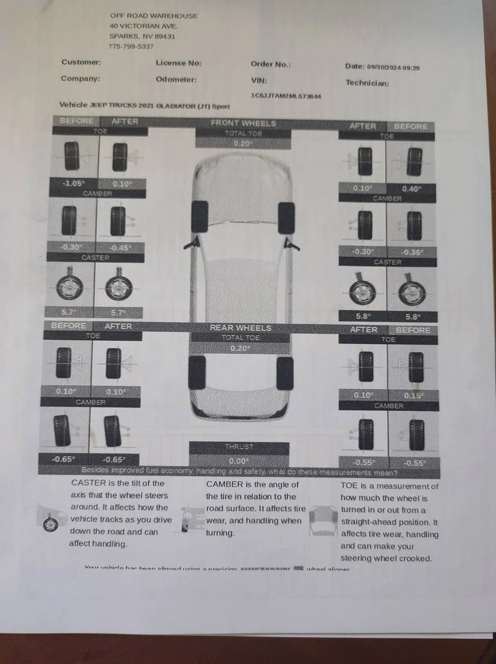

I thought about that too. But mine didn't show any signs of looseness. Went steering upgrade. Easier to install then have it aligned. Mine has been perfect so far. My specs last alignment
Jeep Gladiator Steering Wobble Mystery IMG_20240930_142816959
