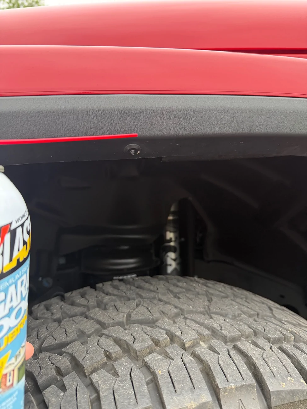

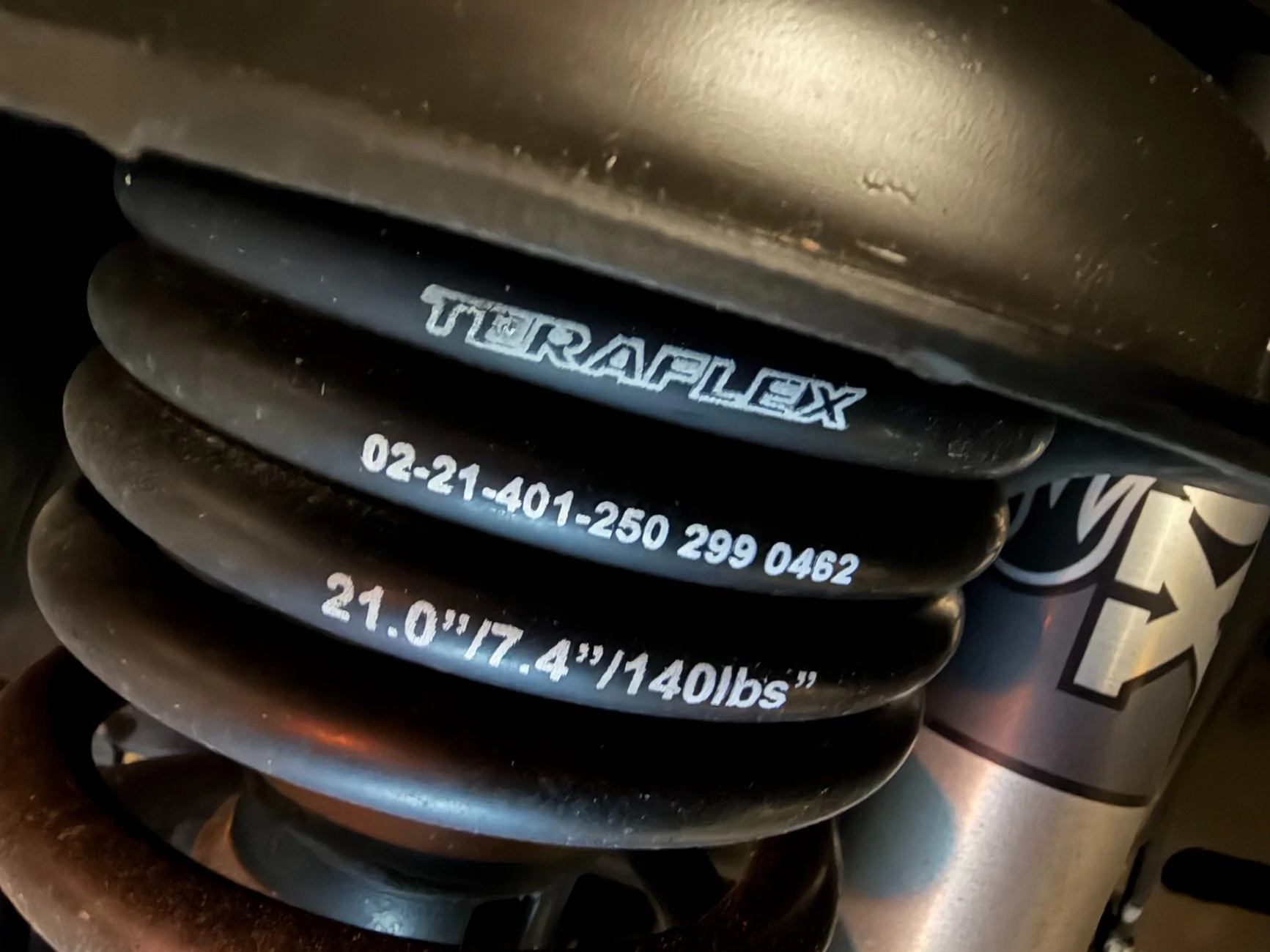

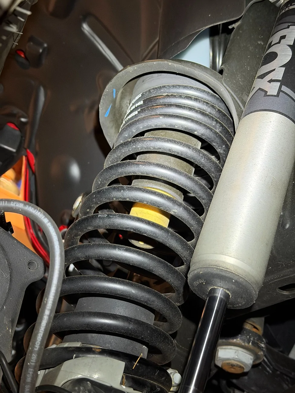

Front Spring: Is the donut on top of the spring a factory item? (I'm trying to figure out if it's something cheap to add height)

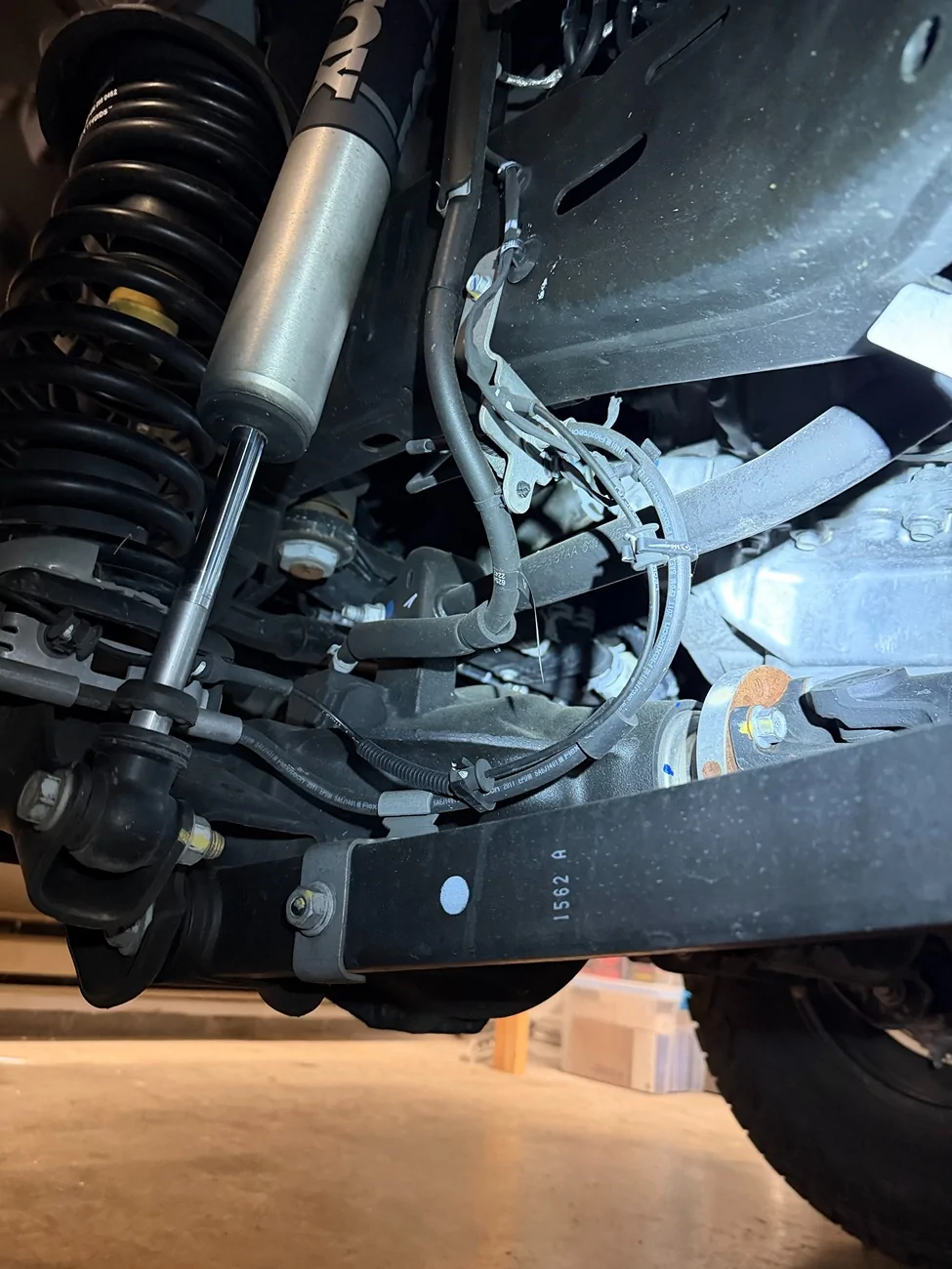

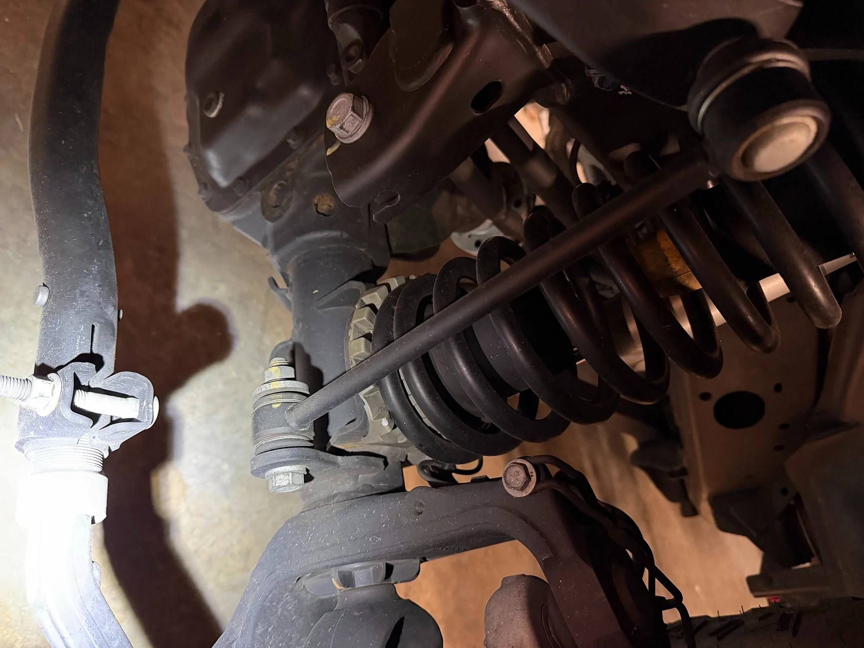

Front control arms
Lower is mopar/stock. Are the factory uppers round?

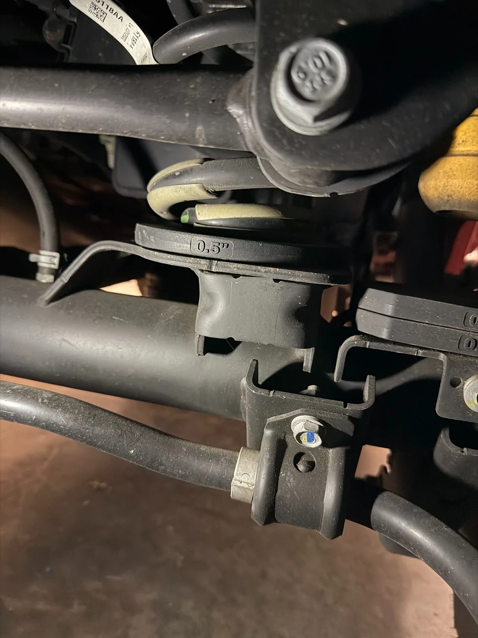

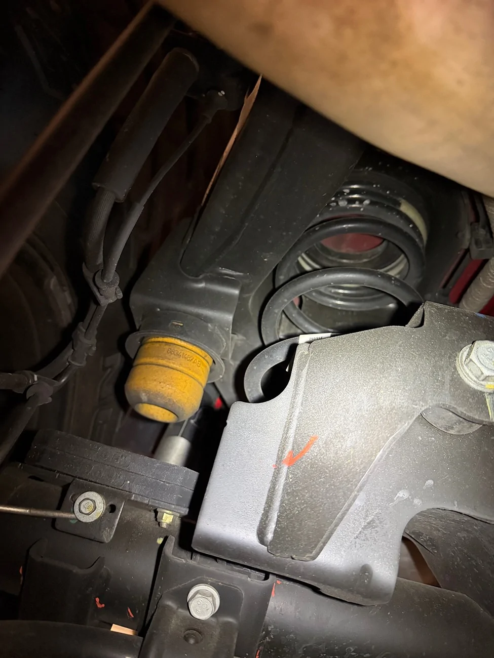

Factory rear springs on a half inch spacer:
Jeep Gladiator New to me Gladiator; Help me understand what I've got. 26-04-26 18-19-11 2805
It looks like there's (part of?) a Teraflex 3.5 inch lift, and they kept the rear springs to keep it sitting level. Which looks cool for pictures but isn't practical if you're carrying around some weight or a trailer.

Hard to know without measuring the lower front control arm if it is stock or the Mopar longer arm.

Anyway, that looks like a hodge-podge lift. A spacer up front along with an aftermarket spring, and a stock spring with a smaller spacer in back. But the concerning thing I saw was the pretty decent sized bumpstop extensions up front. I wonder how long the shocks are.

Is that a spacer on top of the front spring? I like the front height and want to plan accordingly for potentially a new set of springs.
It certainly looks like it in the photos.
And then inside the spring at the bottom is a bumpstop extension.
Of course, that looks to be a spring spacer on the top but since that is not a stock height spring it gets more complicated. But that looks like a 3.5" lift spring with a decent size spacer added on. I assume it sits pretty high. Is there a spacer at the top of the rear spring?

Doesn't look like there's anything on top of the rear spring, but not sure. It is sitting on a half inch spacer on the bottom.

Those are not coil spacers in the front.
You have dual rate springs.
Edit: Sorry, I misunderstood your question. The donut you see above the front springs appears to be a factory coil isolator.
Underpants
Apr 26, 2026
Indiana
2022 Gladiator Overland
Awesome. Thank you. That's very helpful.
