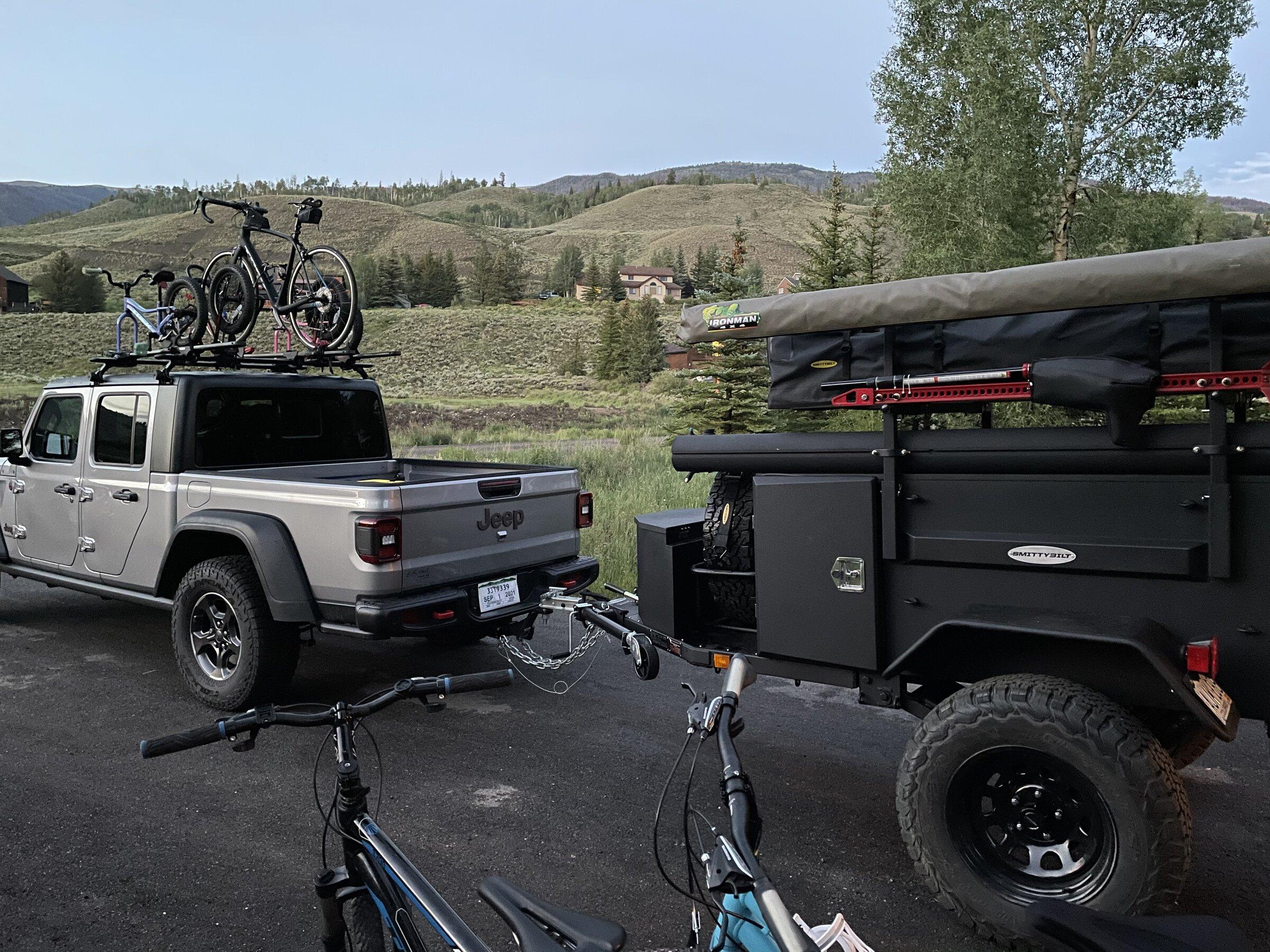

Finally found a picture I could zoom into. It’s in storage until spring. BFG Baja Squadron A/T. 33x12.5x17. Rated for 80psi. Running them at 50psi per trailer manufacturer specs. They’re Jeep tires. The trailer will actually take 37’s with no clearance issues, including it’s spare carrier, and I may put 3 matching tires and wheels on it, so I end up with two spares for it and the JT. Hubs are 5 on 5 to match Jeeps.

Okay that’s cool.
Was thinking you were running ST trailer tires that are rated for 65mph max.

Hell no. :) Really old picture, but shows the tires.

Very nice set up.
Thanks. It’s been really fun. Bought the trailer before the JT, but the JT makes it way better. We can go places we never could with the Cherokee TH. We’ve changed a lot as well. Bikes typically are now on the back of the trailer to eliminate height. Jack is no longer on the trailer, so it’s with us when detached. And topper on JT let’s us bring more stuff and the dog.
