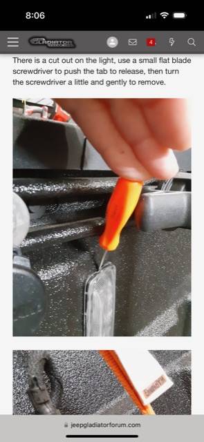

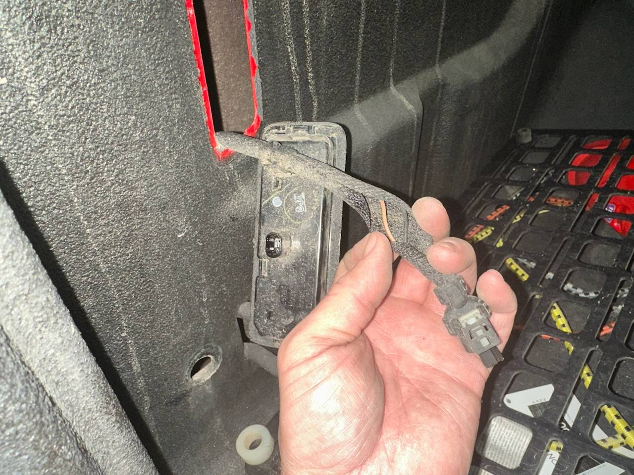

They have a foam gasket around them and push tabs top and bottom. I found this pic showing someone pushing in the tab to release the light.
Jeep Gladiator Nilight LED Bed Light Strip Install F1A72266-1556-4D08-A502-9CBB5EA5932B

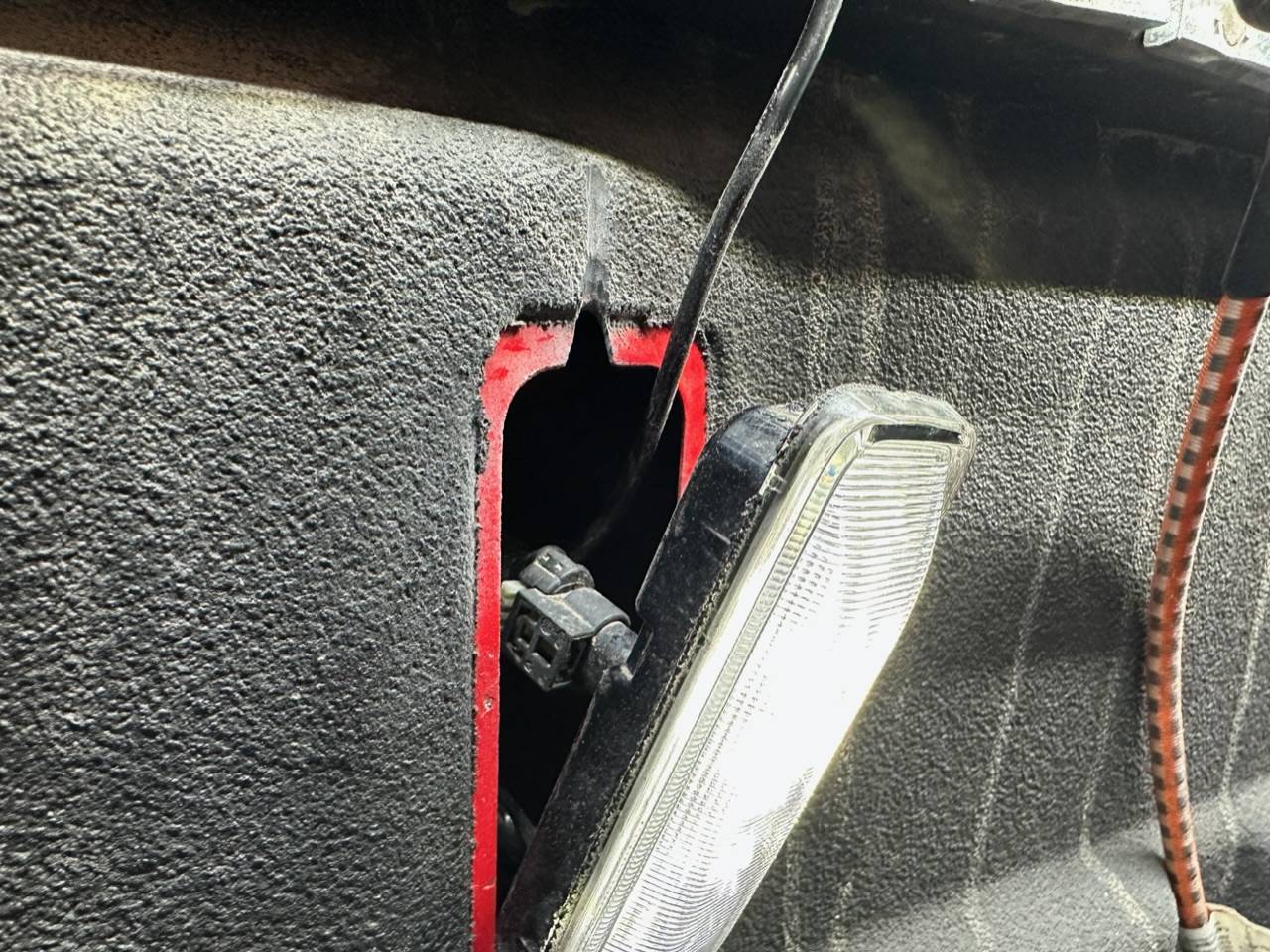

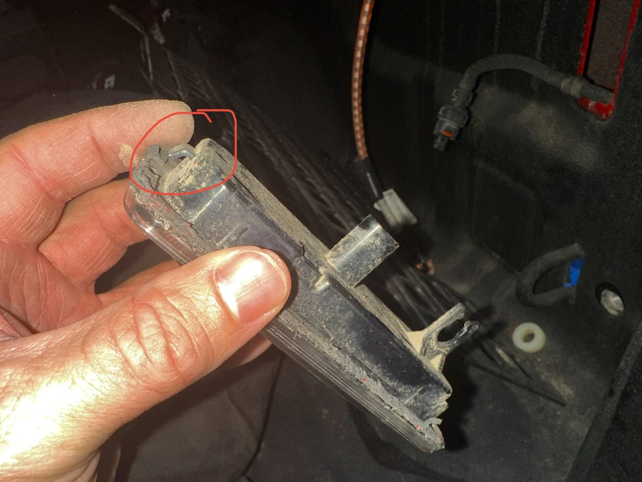

After dicking around for an hour struggling and worrying about breaking the lights I finally just busted ‘em out and broke the top tab on. I don’t know how people get these out without breaking the tabs.
Jeep Gladiator Nilight LED Bed Light Strip Install EF6E8D81-D007-4DF5-9A2B-5A7C88DD0D04
Once they were out I spliced in the power wires for the bed light kit. Passenger side + beige, passenger side + red.

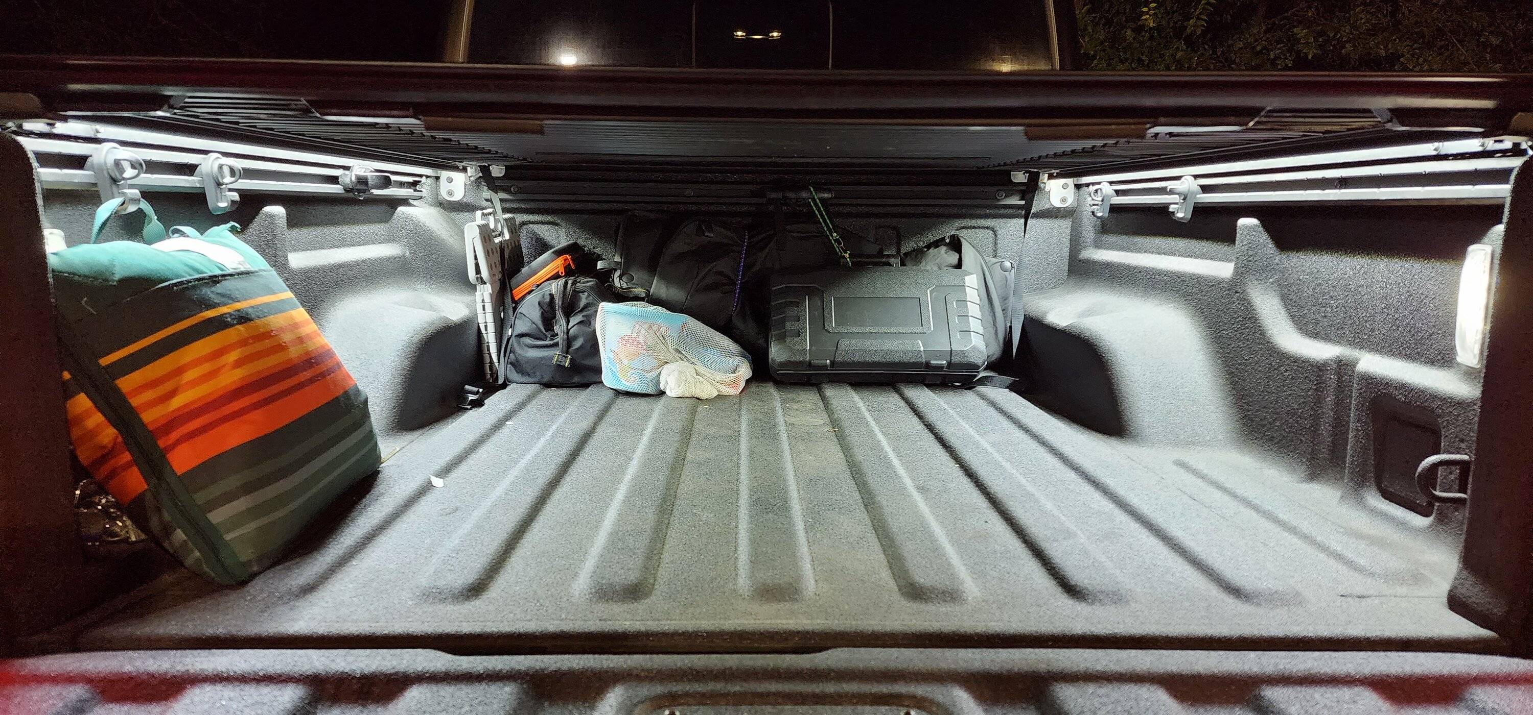

Then I used black RTV to glue/seal the lights back on.
Jeep Gladiator Nilight LED Bed Light Strip Install 39093D35-2DD7-41CE-A115-C7C14D633A00
Jeep Gladiator Nilight LED Bed Light Strip Install 6836073D-D764-42FE-AB49-88060AD7E1B5
Jeep Gladiator Nilight LED Bed Light Strip Install 6AF9DFF0-C0EA-4690-ABDE-0E61BBBDB3AC
Voila! Another 7 hour project that should’ve taken 30mins. :CWL:

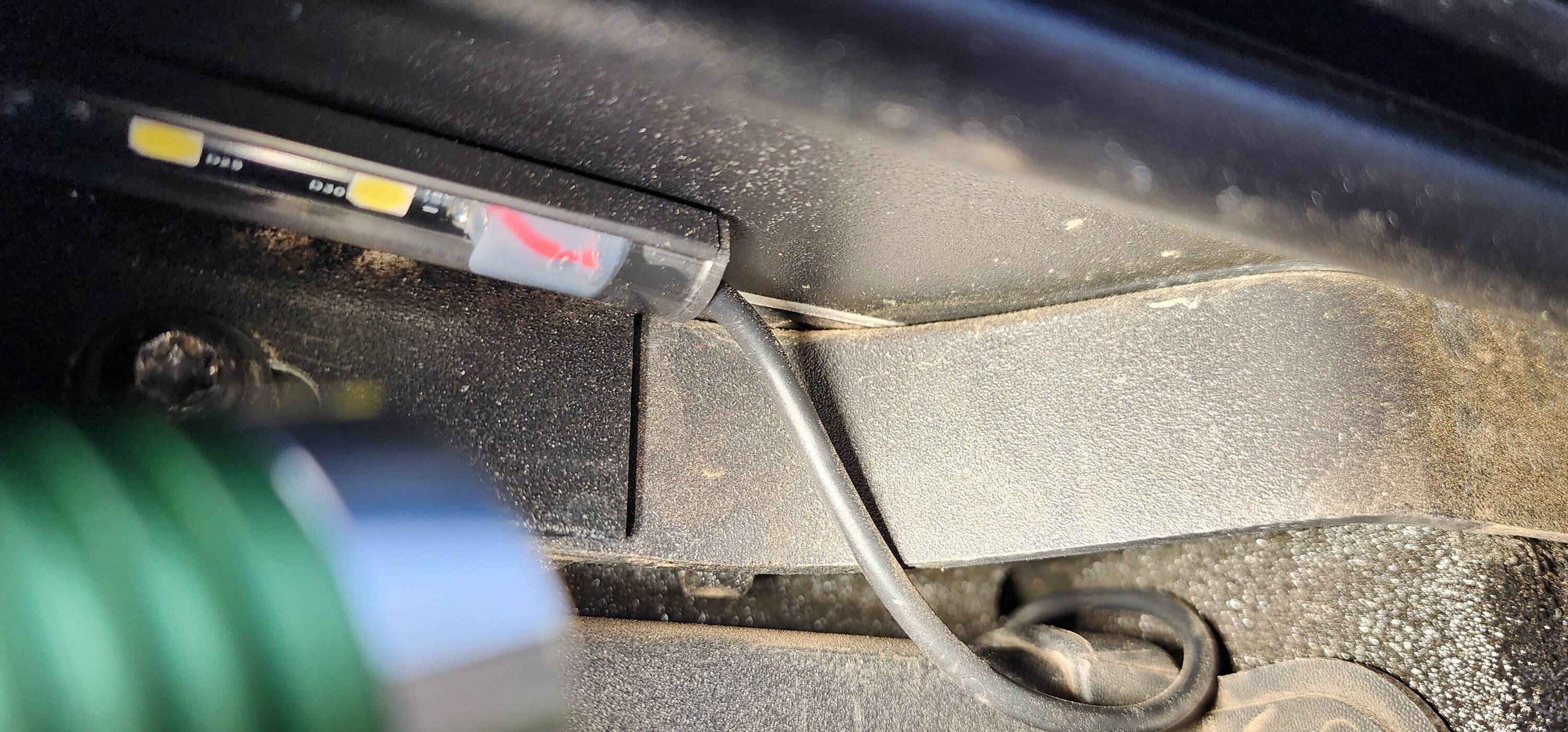

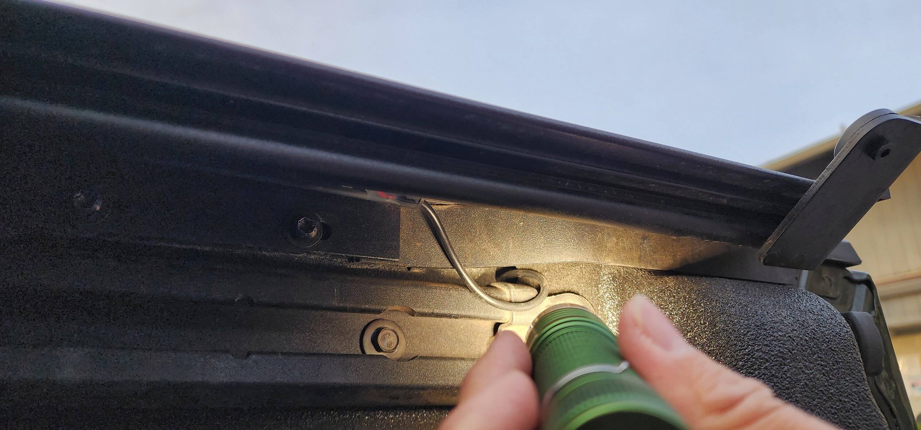

@arskemp where did you run the wires for your lights?

Hopefully these photos are clear enough. I'm using a small hole in the upper corner of the bed. It's been a while, but I'm pretty sure I had to cut the head off the connector and then resolder/shrink wrap it back on after pulling the wire through. Did the same on both sides.
Jeep Gladiator Nilight LED Bed Light Strip Install 20230202_164610-01
Jeep Gladiator Nilight LED Bed Light Strip Install 20230202_164646-01

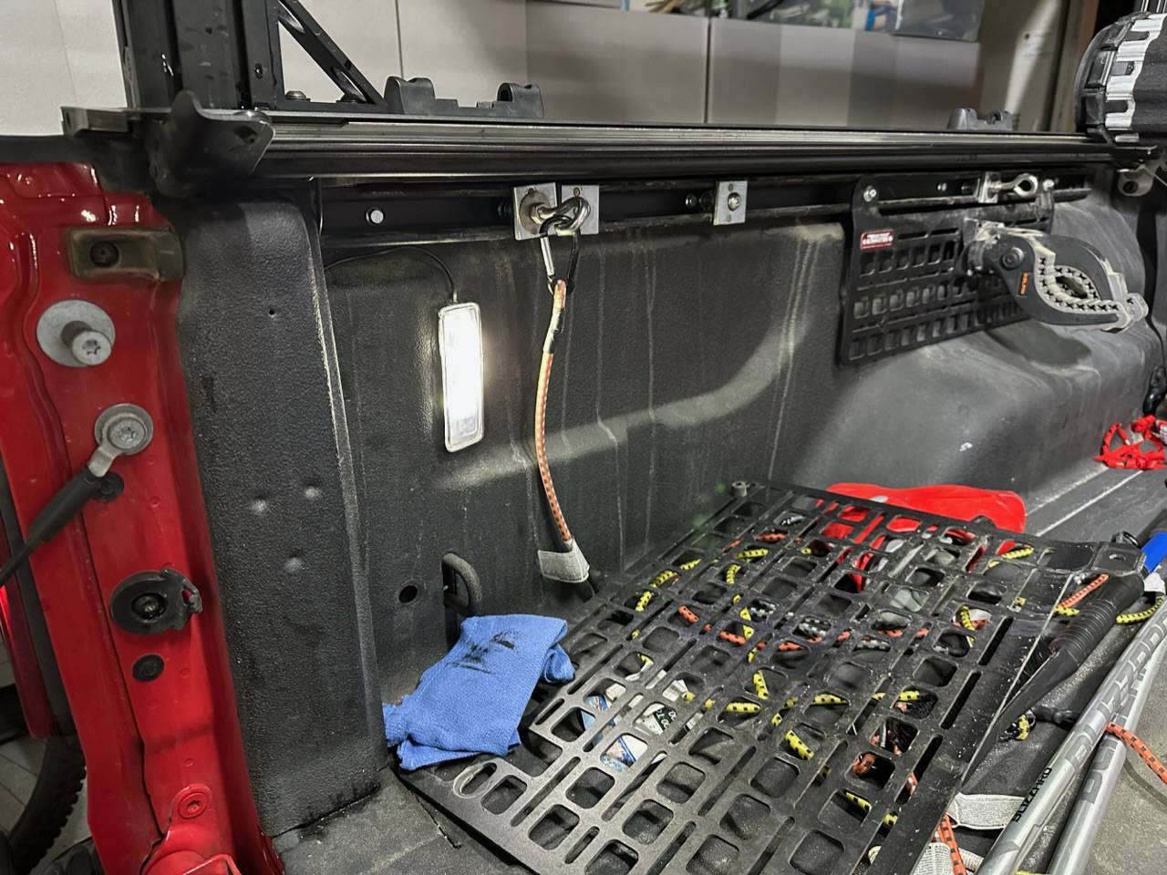

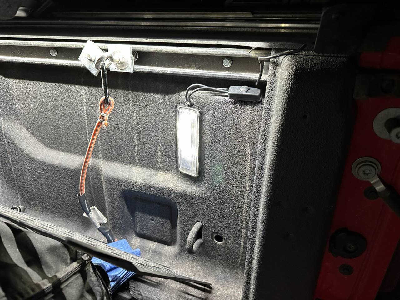

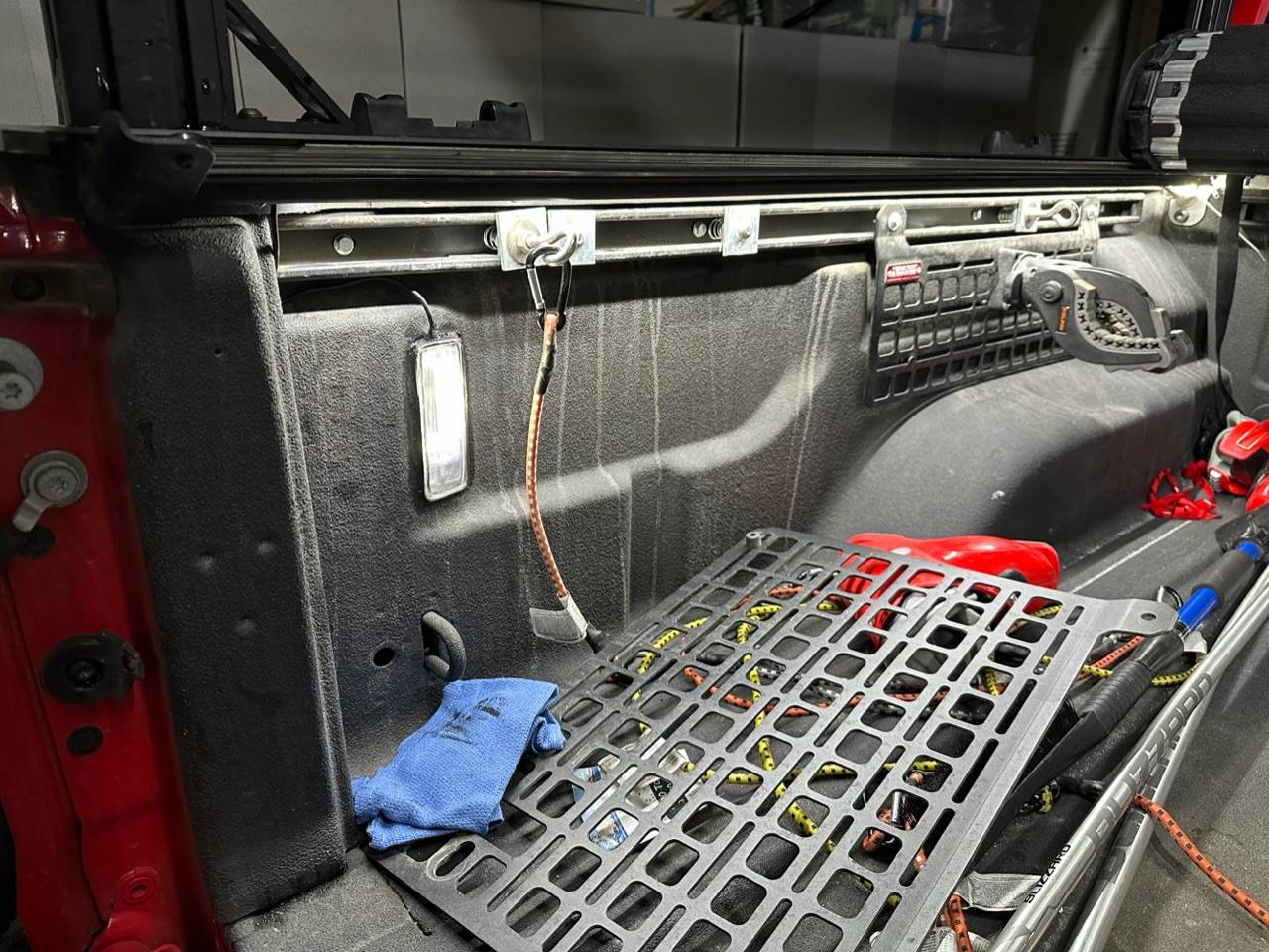

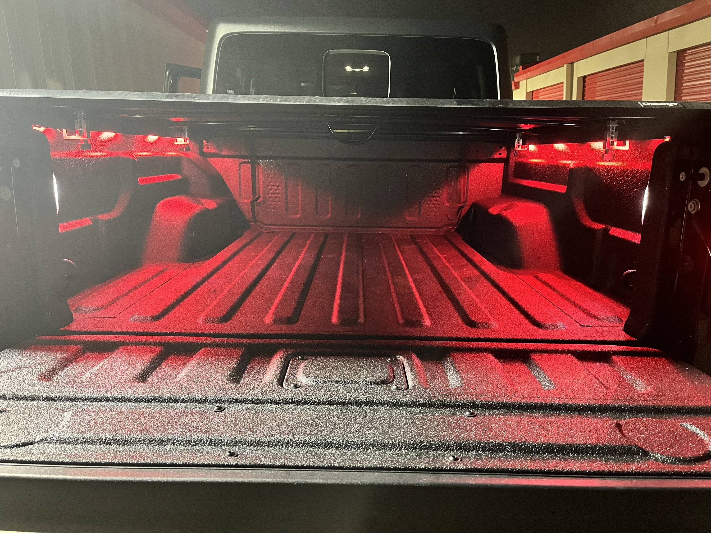

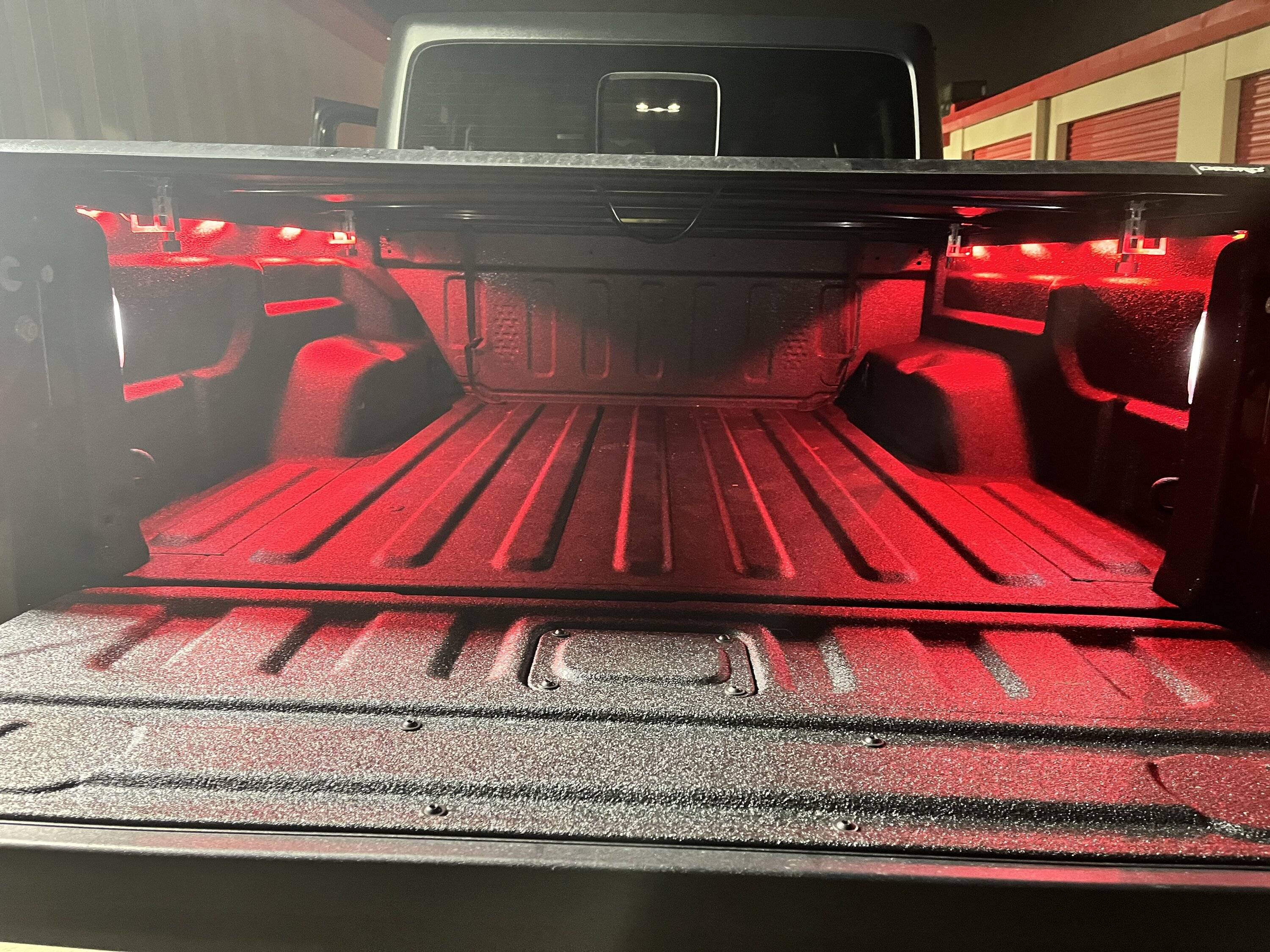

I just did mine last night. Took 30 mins to do it. Like the initial pic shows, I used a small flat head screwdriver to pick it and slightly turned it to remove the light fixture. It came out perfectly. Then I tapped into the existing light wires and here is the end result. It is easier than I thought.
Jeep Gladiator Nilight LED Bed Light Strip Install IMG_5667
Jeep Gladiator Nilight LED Bed Light Strip Install IMG_5666

haha yes, for sure. I know you said yours was tough to get it out but once i felt the slight click of the little tab, it came out smoothly. Thanks for your input.

If you pry from the bottom and push the entire light up it will also come out without breaking the top tab. I did this and added a strip of white LEDs on either side I am using for a set of custom tail lights. I put the LEDs on the underside of my strut channel (diy trail rail), this make a big difference when you have a retractable bed cover.
