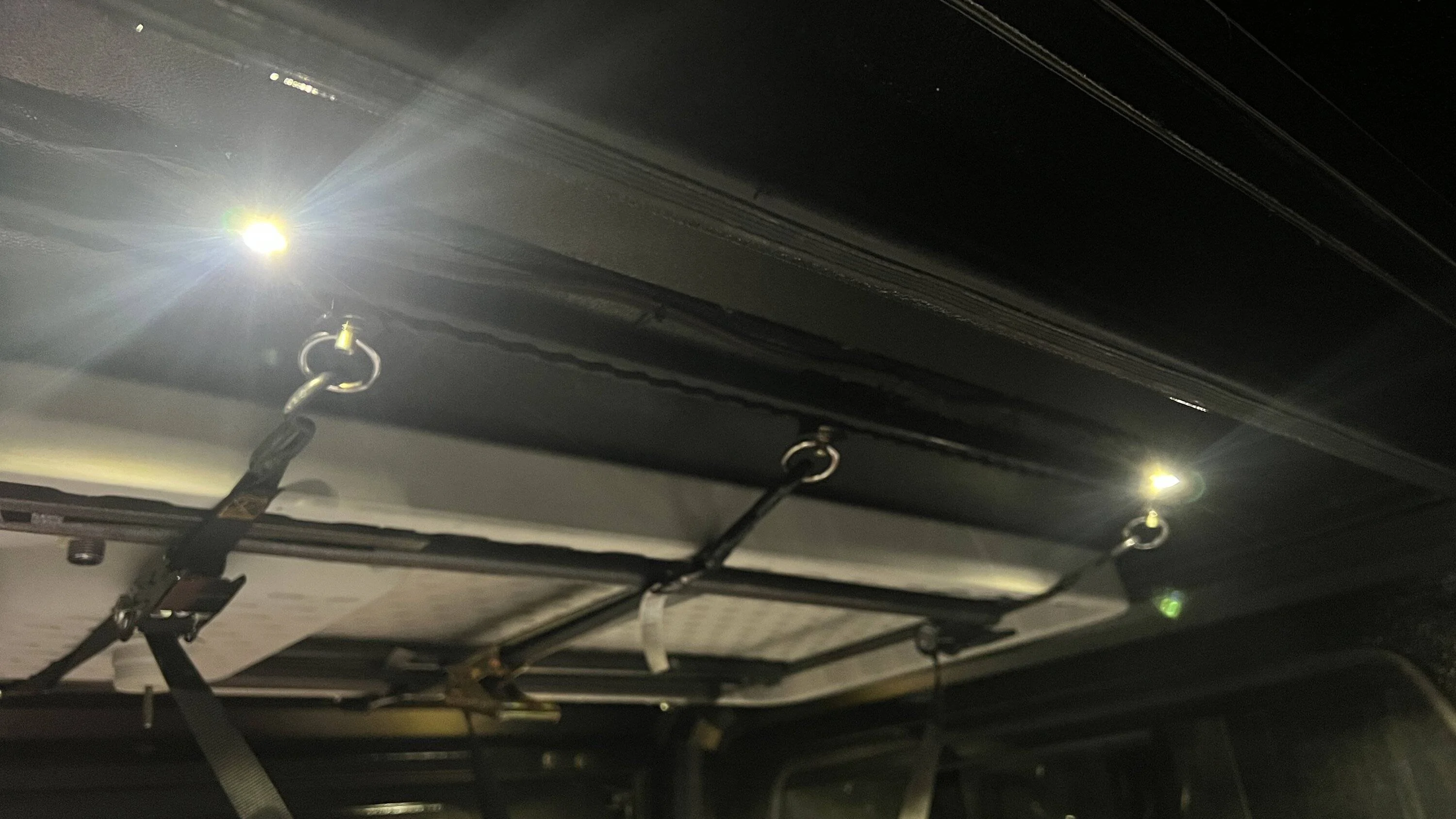

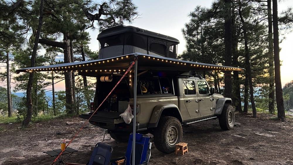

This is my hard tonneau solution.
https://www.jeepgladiatorforum.com/forum/threads/enhanced-bed-lighting-project.76496/
I’m about to start phase 2 of this with external lighting controlled by a Garmin Power Switch. I’ve also got led strips on the awning. I power all of it off of a second house battery but LED strips draw very little power and you can easily run them off if the starting battery.

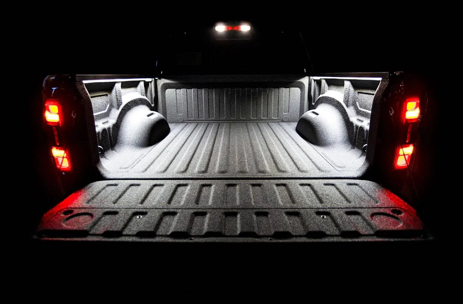

Before I did all of that involved nonsense I just ran @ORACLElights LED strips under the trail rail. These work regardless of whether you have an open bed, hard or soft tonneau or a cap. I still have these installed.
https://www.oraclelights.com/products/oracle-truck-bed-led-cargo-light-60-pair-w-switch

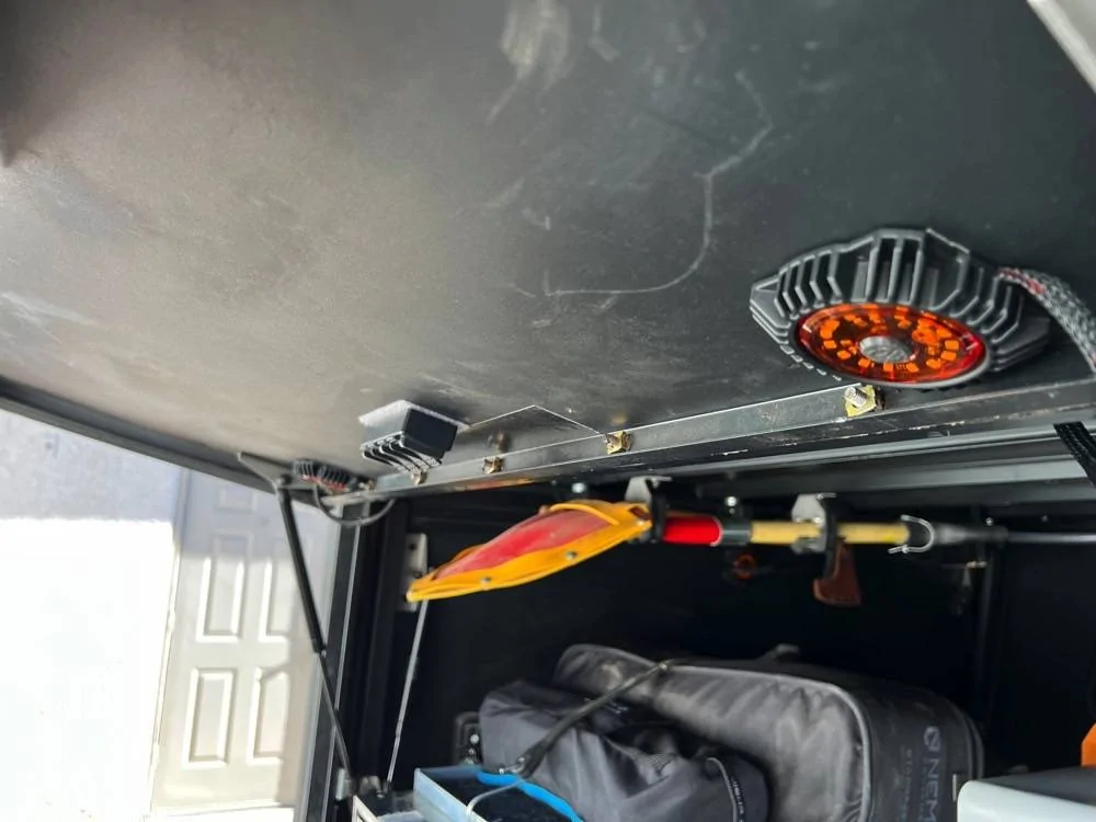

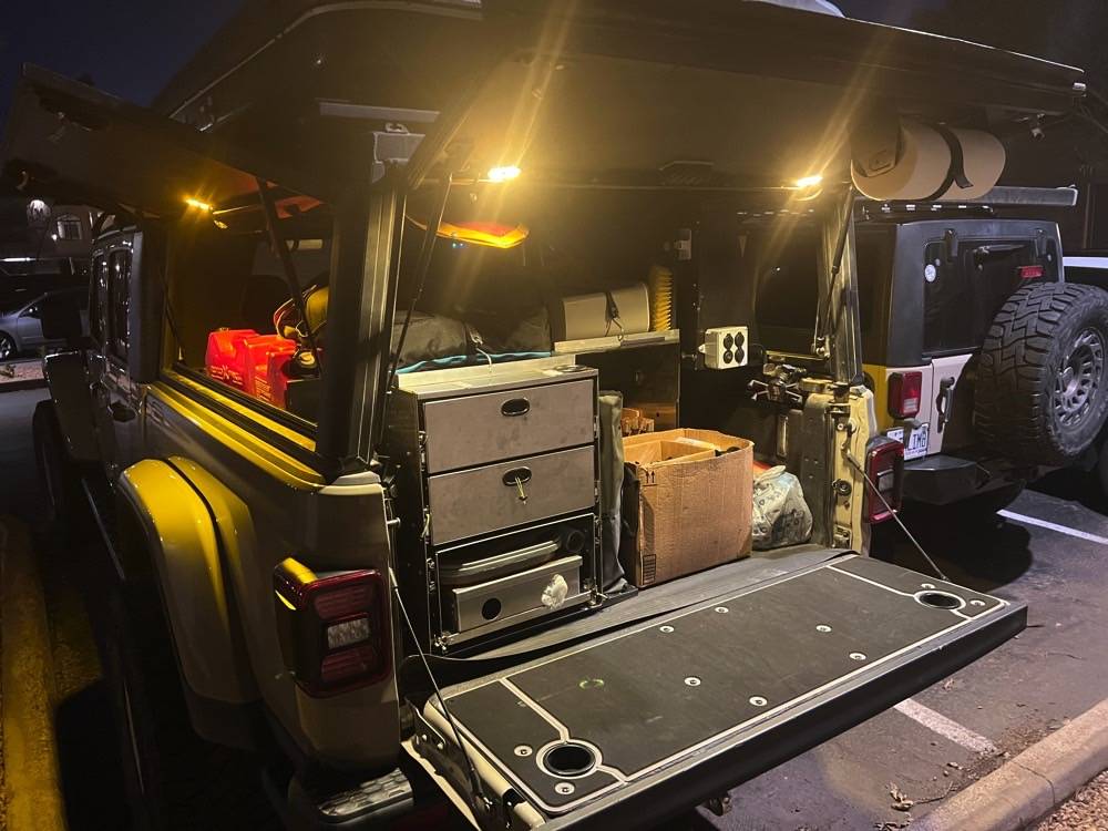

I used BajaDesigns rock lights. 4 of them. Lots of light, and very low power draw. If one goes out, only one needs to be replaced, not and entire LED strip.

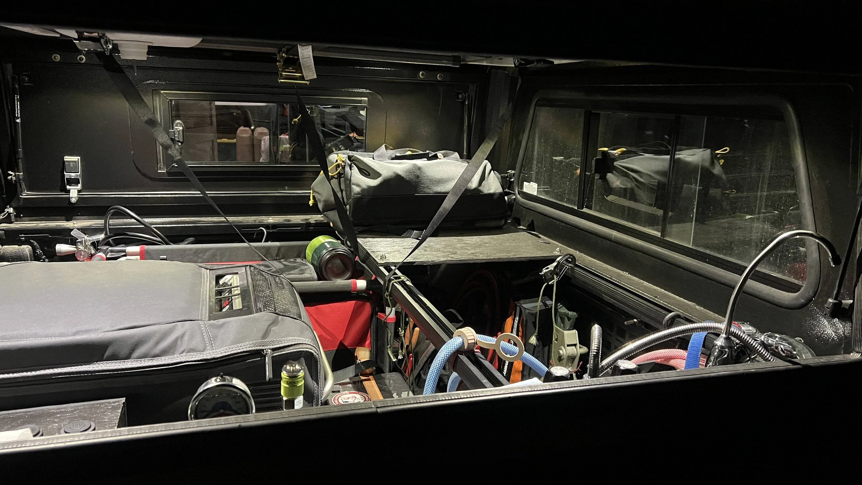

That's why I was asking for clarification on what he is looking for, because there is a lot of different bed lighting for different purposes:
Amber KC Cyclone V2's to minimize bug attraction over white lights

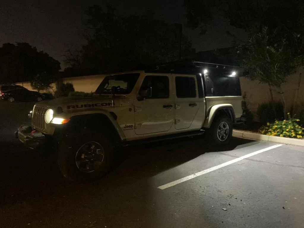

KC Series 2 for scene lights

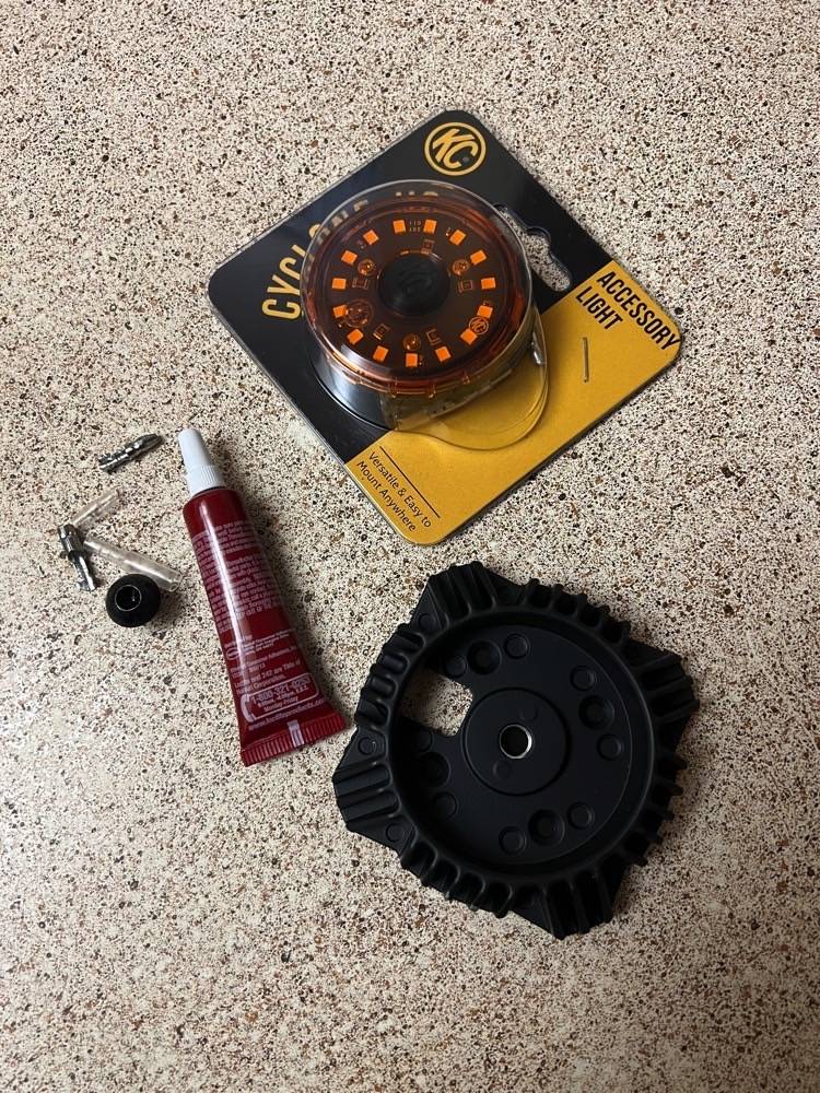

I have the Cyclones everywhere on my Jeeps; 8 rock lights on all 3 Jeeps, 2 under hood lights on all 3 Jeeps and then the canopy lights on the JTR. I've been really happy with them. Here's how I did them on the canopy doors:
1) the basic parts used. I love the surface mount that they sell for the lights in this application

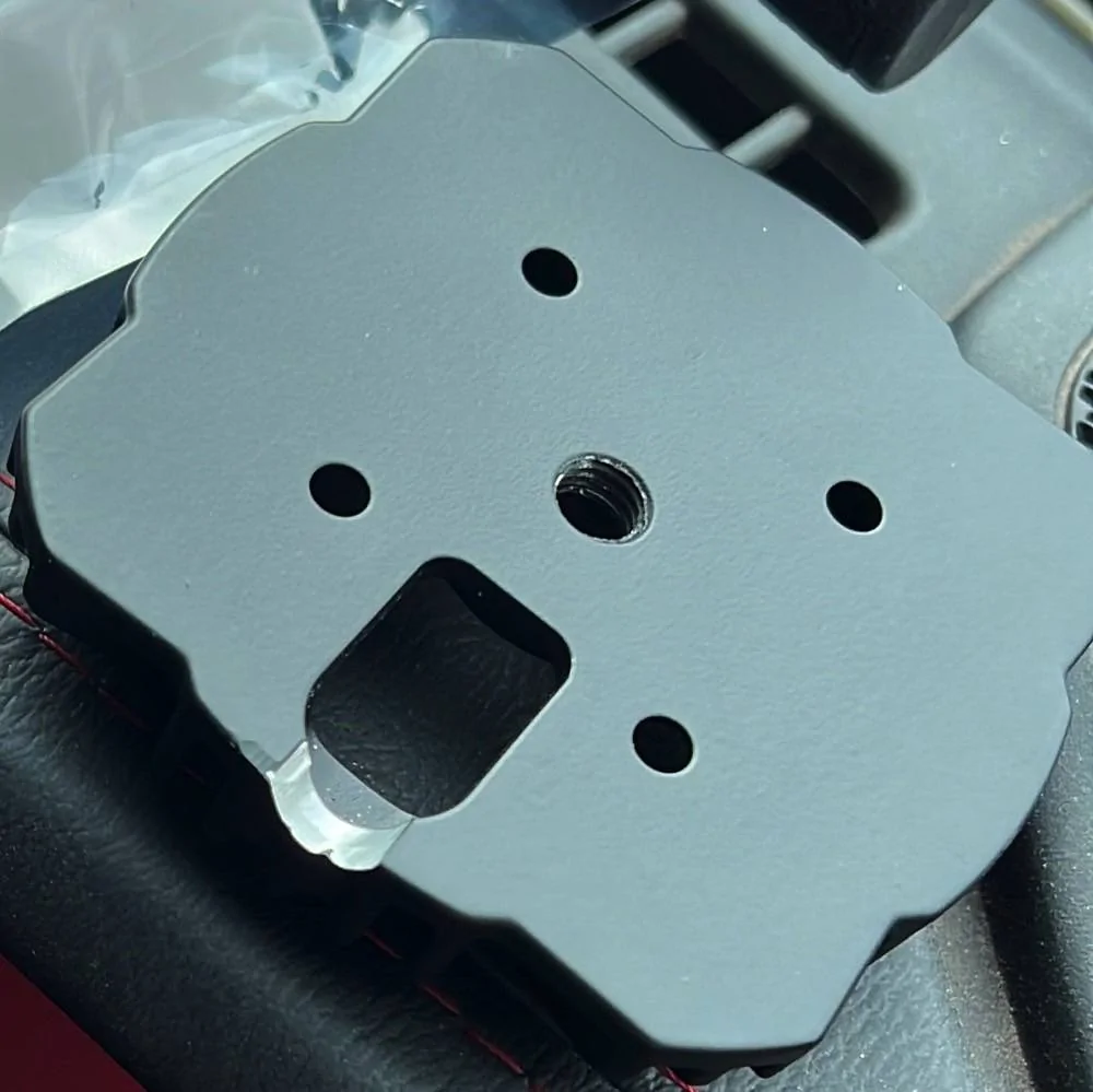

2) The only down side to the mount is that it is design to have the wires penetrate the surface it is mounted to which doesn't really work on the canopy doors; but a little Dremel work made them just right:

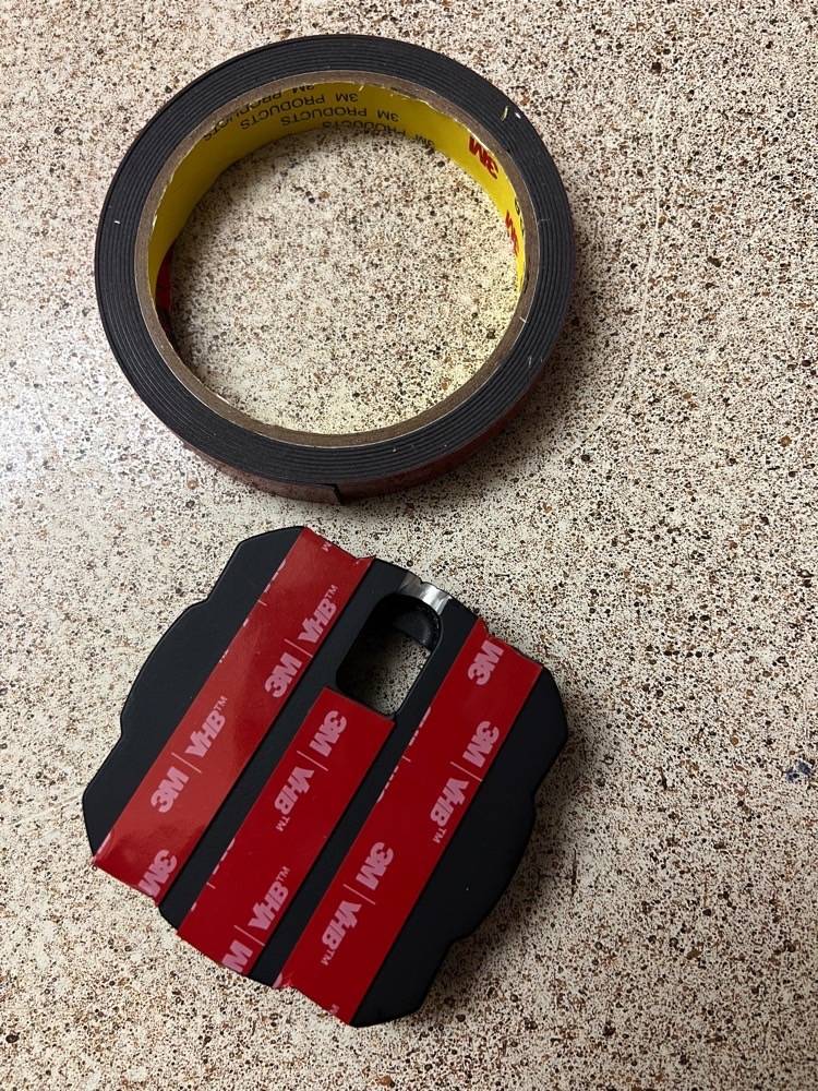

3) A little 3M VHB tape:
