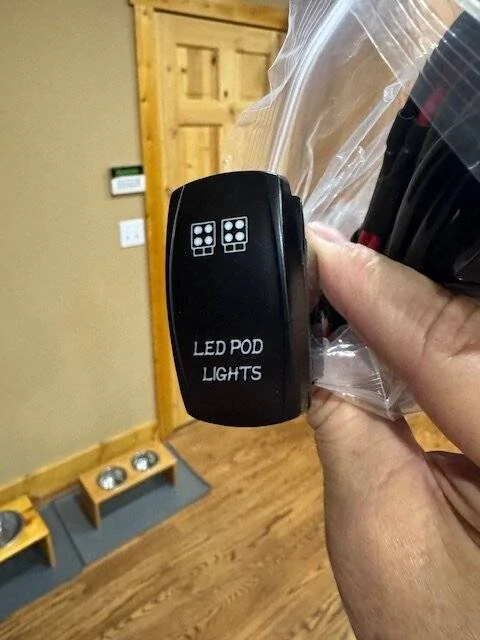

I am going to install a set of nilight pod lights this weekend and am trying to find out where to mount the switch. I’m looking for any ideas. I plan on getting a voswitch sometime next year but there are other items I need to get first. Any suggestions would be appreciated. I don’t really want to cut into the dash and have thought about making a small bracket to mount the switch to but not sure where I could put it.. Also, whats the best way to get the wiring to the dash from the ine compartment?. I figured there are smarter people on here than me that would have some good ideas.
Jeep Gladiator Where to mount Nilight pod light switch IMG_8865

I think you're going to play hell finding a place to mount that type of switch. You need a flush mount spst like this switch on Amazon With this type of switch you can just use double-sided sticky tape and put it anywhere, like the little shelf under your steering column. There's nothing special about the switch you have so ditch it and save it for some other project. If you want a lighted switch (3 wires) then something like this
If you open the hood and look to the right and a bit down from the brake booster, you'll see a plastic plug in the firewall. This is your entry into the cabin. Twist and pull to remove it and drill a hole for your wiring. Cut a slot from the center out to slip in your wiring without having to drill a big hole to pass any connectors.

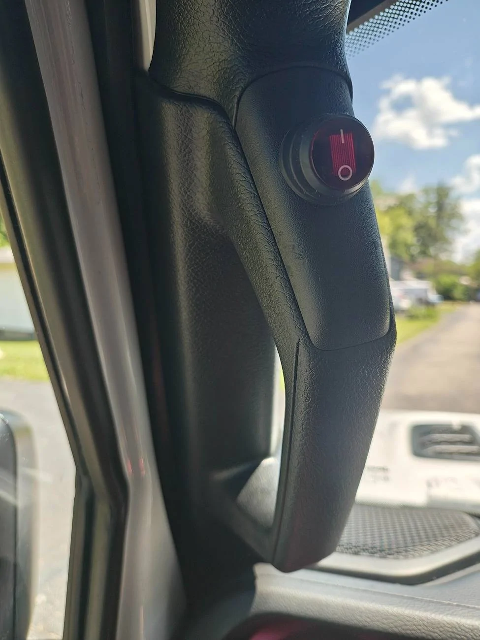

Jeep Gladiator Where to mount Nilight pod light switch grab-bar switch

Your Mojave has factory switches with wiring already under the hood. It may be easier and cleaner to use one of those.
