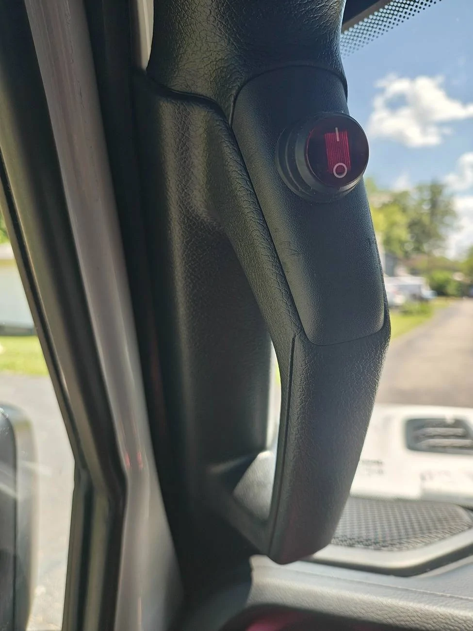

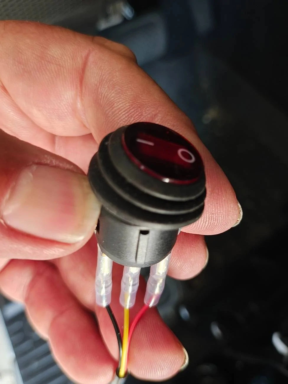

Have you ever wondered where you're going to mount a lightbar switch if you don't have the auxiliary switches under the radio and don't want to get involved with taking the whole dashboard apart? I was watching a video on how to install a VOSwitch (Installing a VOSwitch on a Jeep JL by DEFIANT JEEP) when it hit me. I don't need to buy a separate switch or drill a mounting hole in my dash, I just need to mount my factory light bar switch in the same place as you would a VOSwitch on the top of my grab-bar. There is plenty of room to mount a switch in the top cap/cover (or bottom cover) that conceals the 10mm bolts holding the grab bar on. Run the lightbar wiring through the access hole/cover in the firewall then take off the grab-bar. I ran the light-bar wiring up through and behind the dash, coming out in an open corner that's behind the grab bar. (FYI - At the 22 minute mark of the video they show you a neat little trick on how to pull up the wiring under the dash.) I used a "Flexible Grabber Claw Pick Up Reacher Tool" with 4 claws that I snaked down that hole until I could reach my lightbar wiring behind the dash, grabbed the wiring and pulled it up. Then, using a paddle bit I Drilled a 3/4" hole in the top grab-bar cap to mount the switch and an access hole behind it to run the wires inside to the switch. Hooked up the wiring and put the grab-bar back on. (Also, I figured it would be cheaper to replace a grab-bar cap if I screwed it up.)

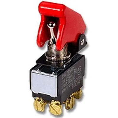

Looks good. Thought of something similar. I like aerospace guarded switches.
