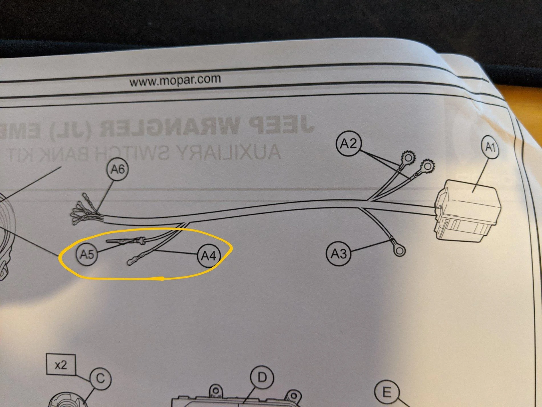

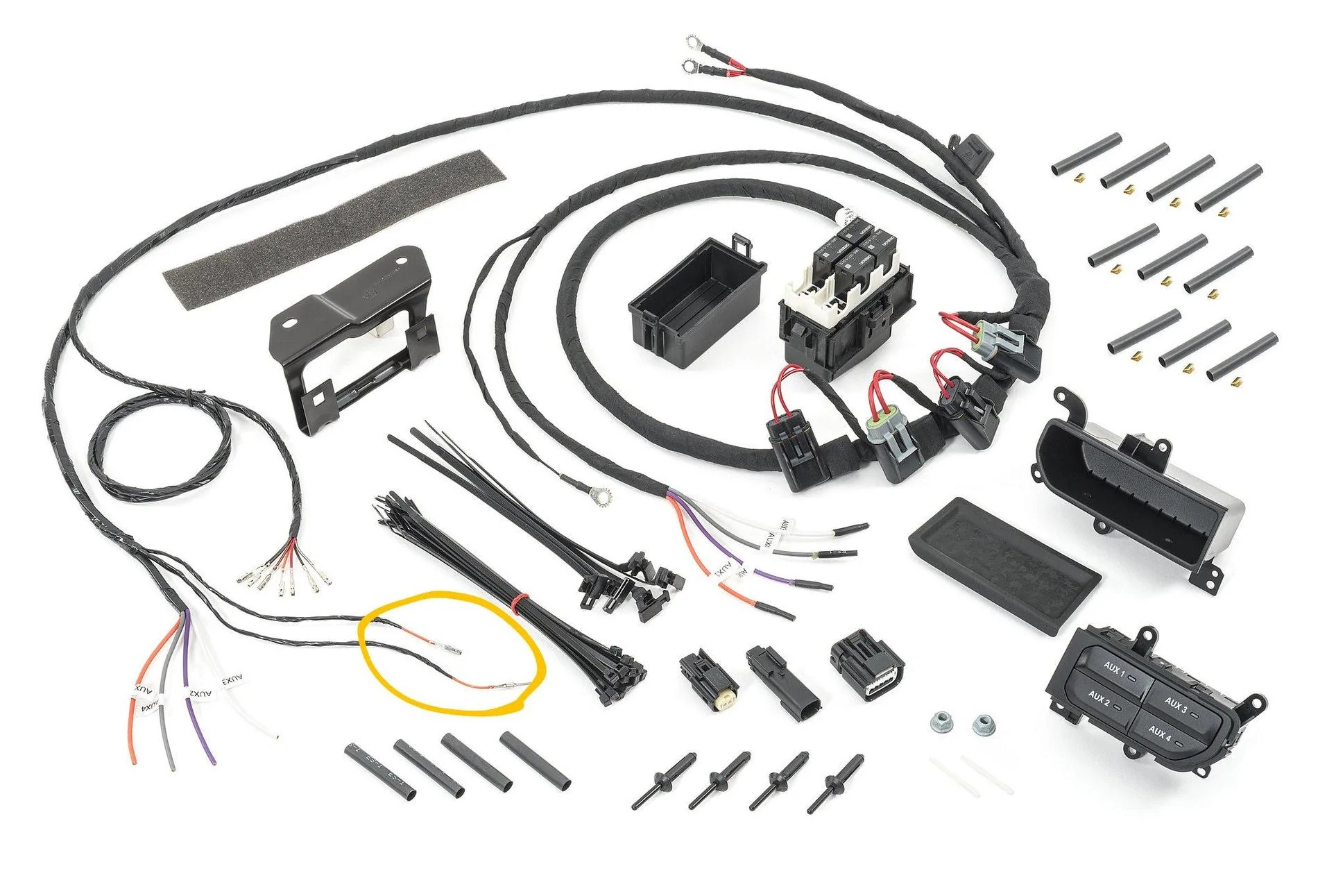

So today I went and got the Dealer installed Aux Switches, was not aware that they only come with 4 interior wires and do not have the BATT and ACC wires like the factory installed Aux Switch Group, wonder why the difference?

I think the extra wires are part of a different main wiring harness the vehicle gets if the aux kit is a factory option.

From what I have seen they are all part of the same wire loom/harness that come from the factory. But when you see pictures of Factory Aux Group and Dealer Installed Wire harnesses, there are definitely 2 additional wires, I was hoping for the extra wires, but either way adding the switches is worth it in my opinion.
I'm still perplexed though Jeep advertises the switch group with the two additional wires, but when you have a dealer install it you don't get them. So hypothetically if a factory installed Switch group wiring harness had to be replaced would it be different than the one the dealers order to install? (MOPAR Part #82215798AD)

The extra wires you see in some online images/instructions are used to communicate with the vehicle and plug into a harness in the passenger footwell, they're not additional batt/acc wires.
At least, I'm assuming you're referring to these?
