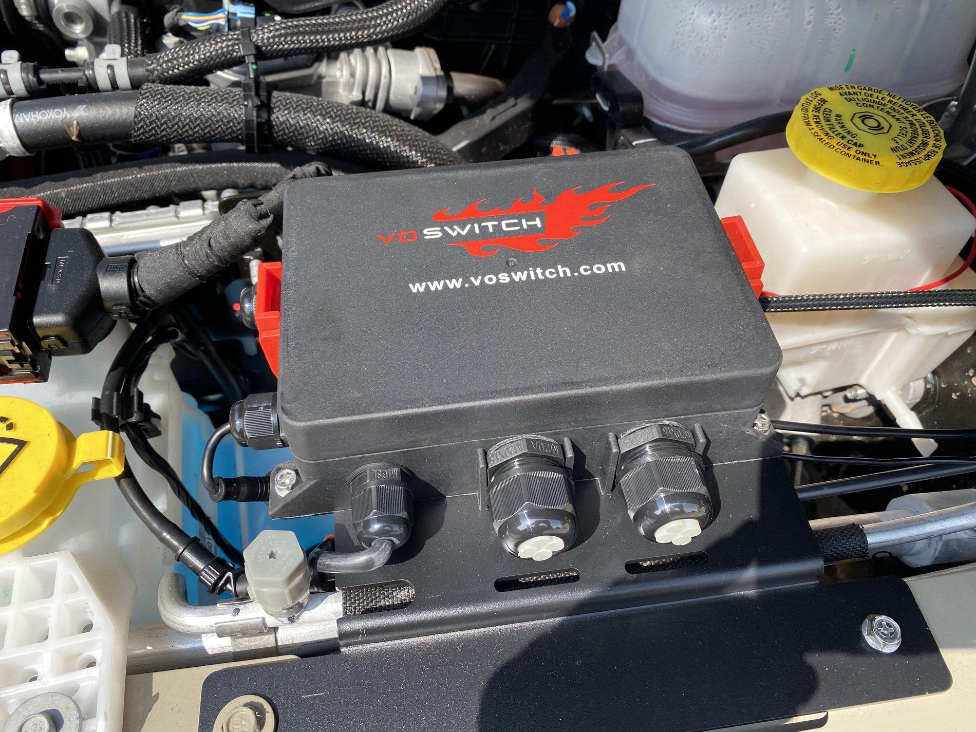

Get the VOSWITCH from Amazon instead. It’s only 250 and you get two more added switches.

@93civej1 its the VOSwitch. It doesn’t have to be calibrated by any programmers.

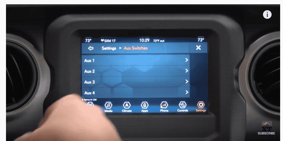

the only benefit of having it integrated to the radio (mopar aux switch) is you can set up functions on the screen.
I too have the VOSwitch and all you need is to attach the positive to battery and ground to chassis. The ignition is optional.

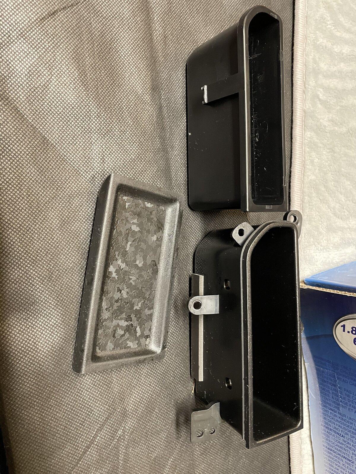

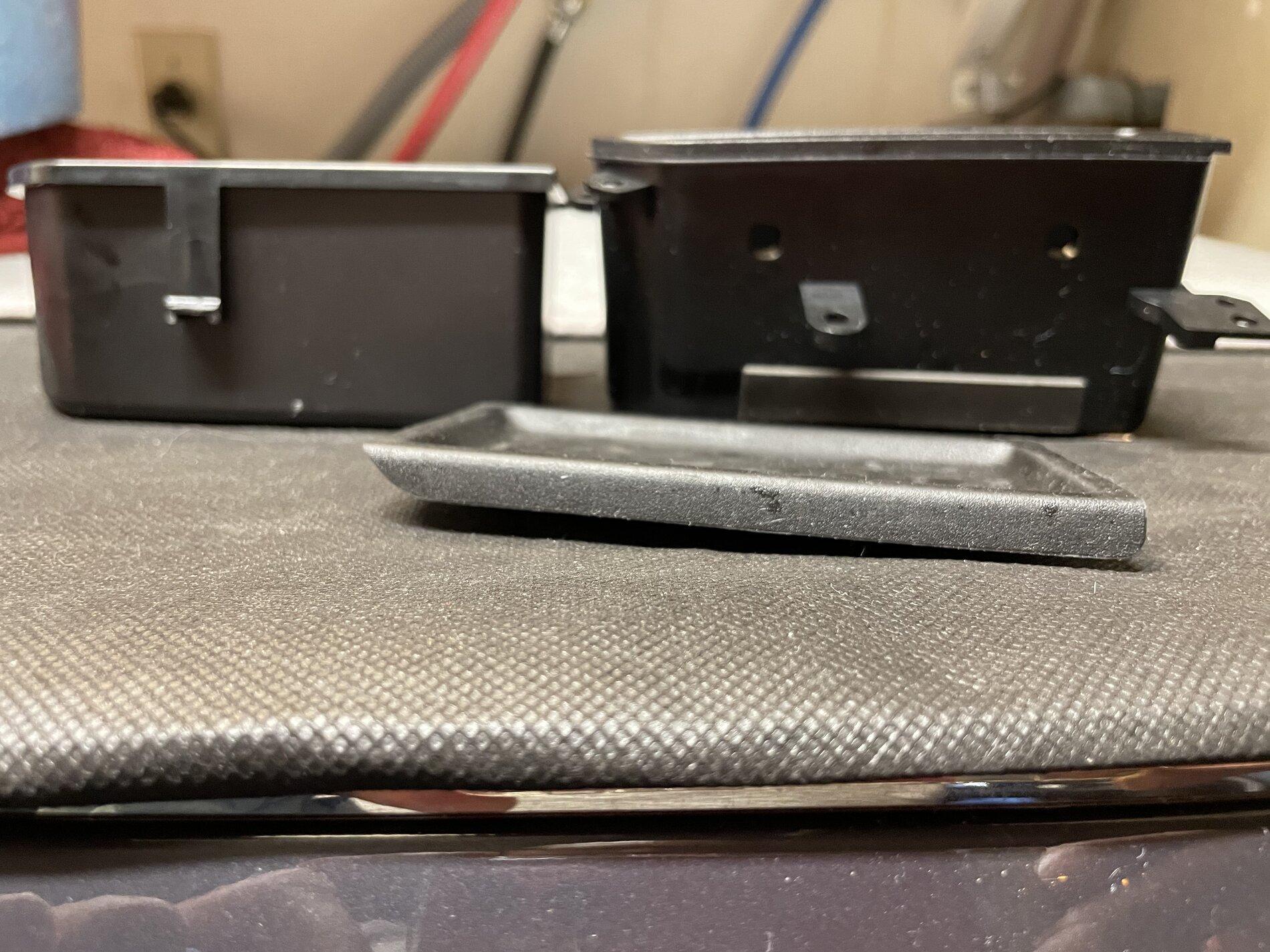

I’m also using the mopar tray as my VOSwitch tray came broken...they did send me a new one but I got the mopar for cheap. I prefer the mopar as it’s slightly deeper and mounting points are thicker.

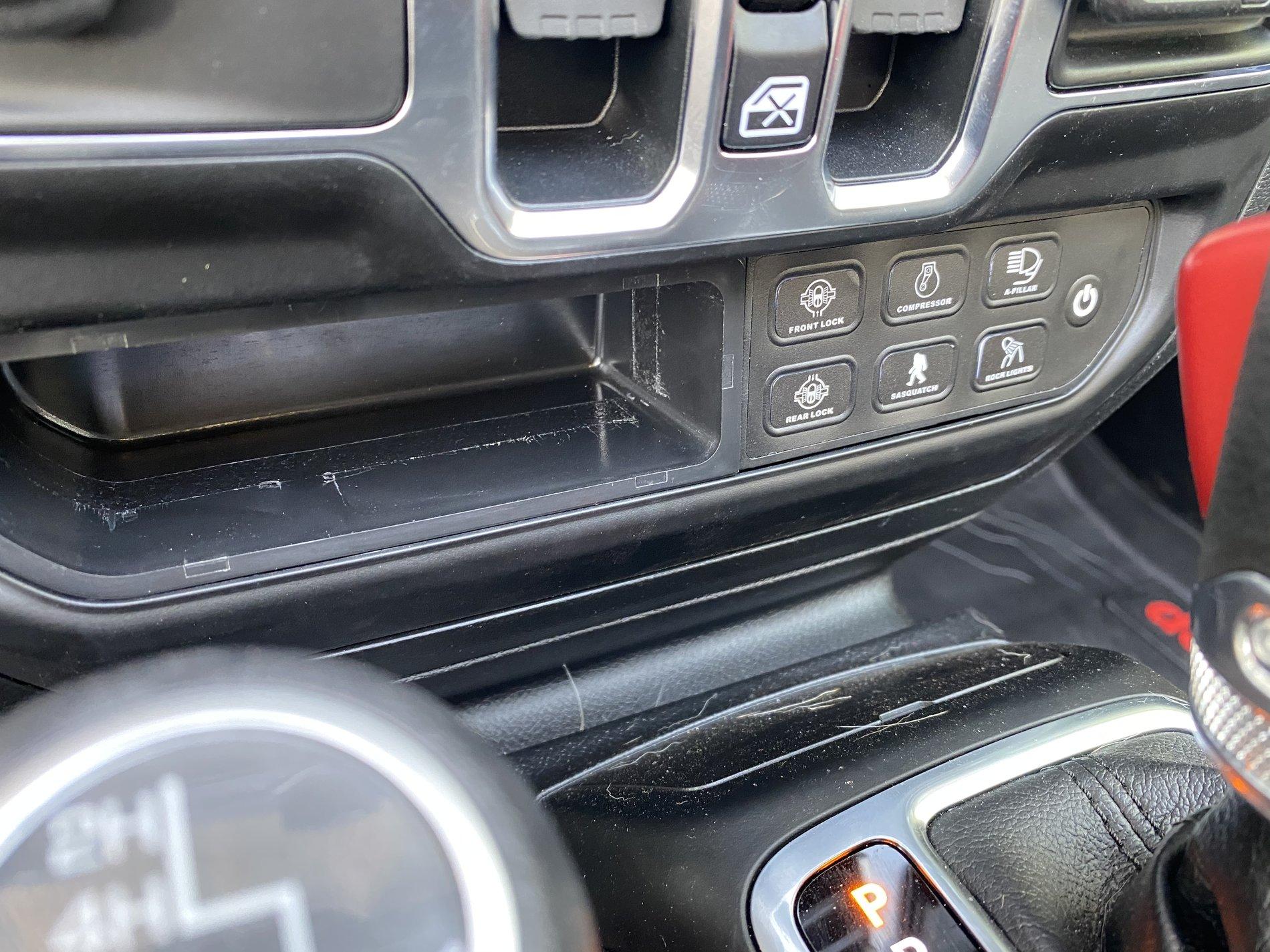

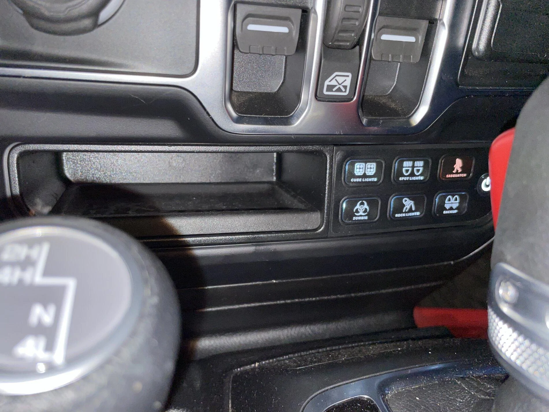

Can someone confirm whether the factory-installed Aux Switches dim to match the rest of the dashboard?
I can.
I had a 2021 JTR with factory installed auxiliary switch and it came with the BATT and ACC wires in the interior harness.
I now have a 2021 JTDR that did NOT come with the auxiliary switch from the factory. I just finished installing it today. The MOPAR auxiliary switch kit harness has no interior BATT or ACC wires in its harness.
