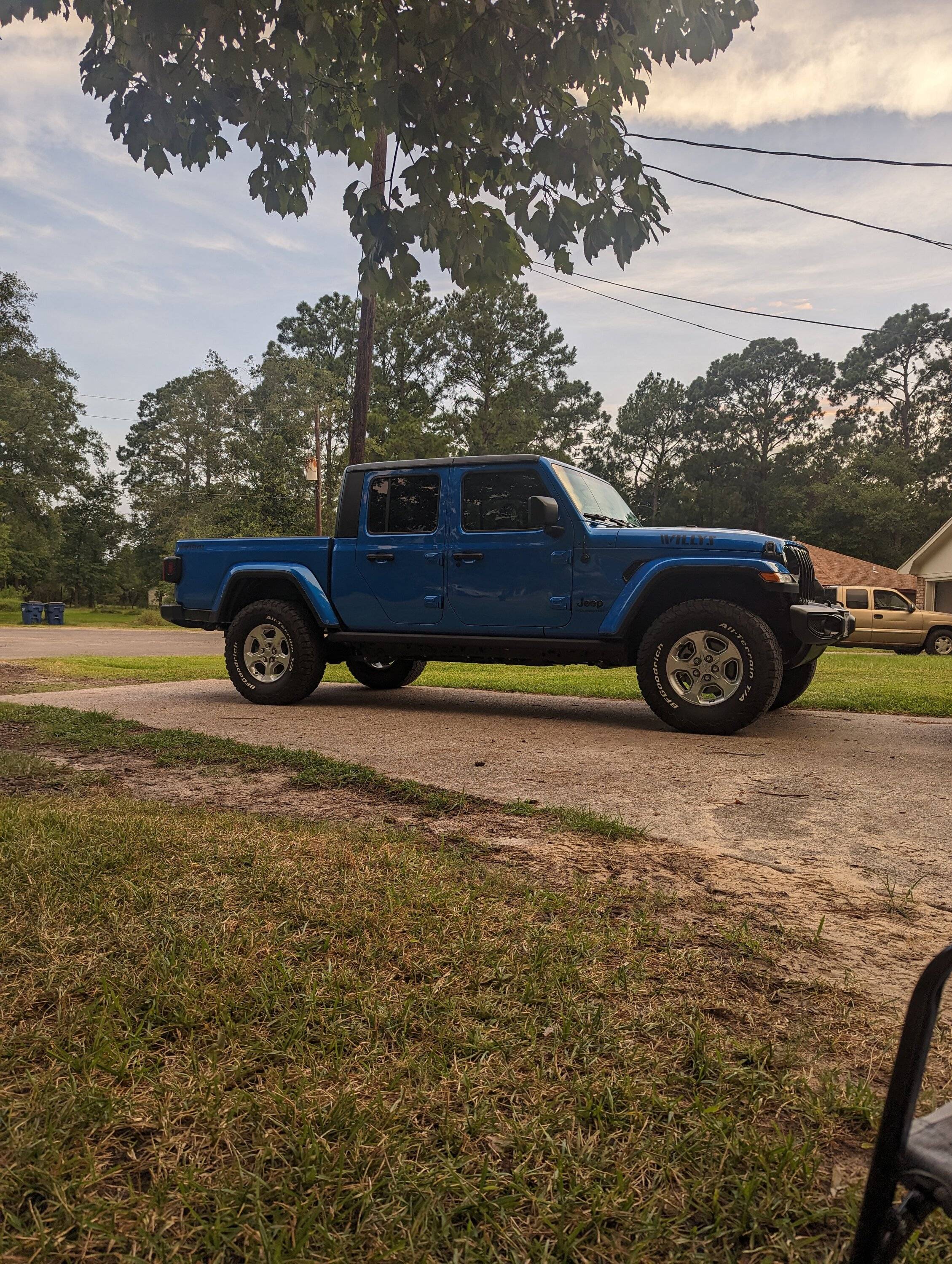

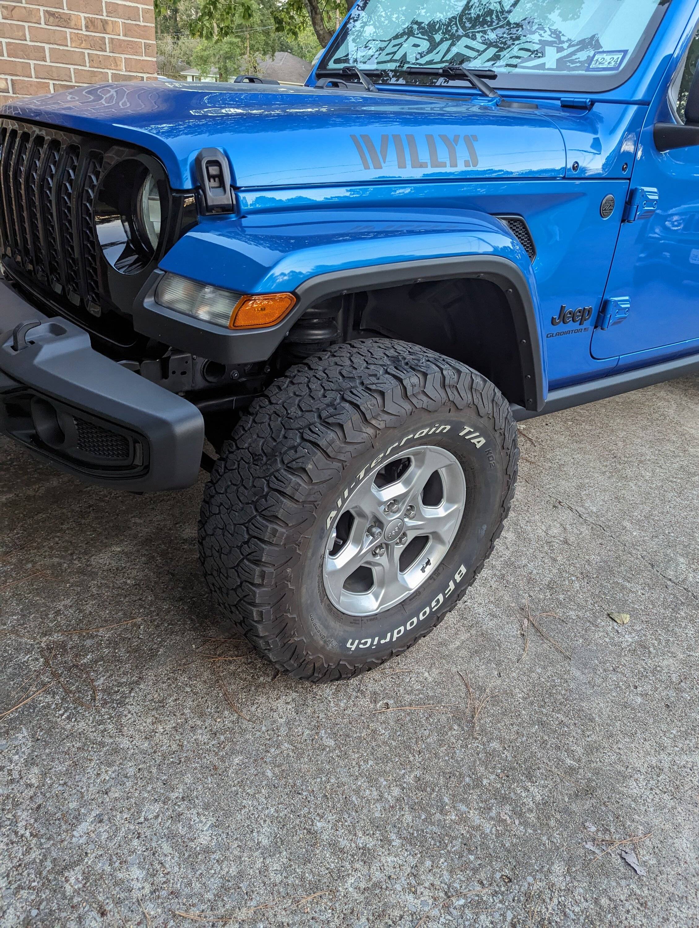

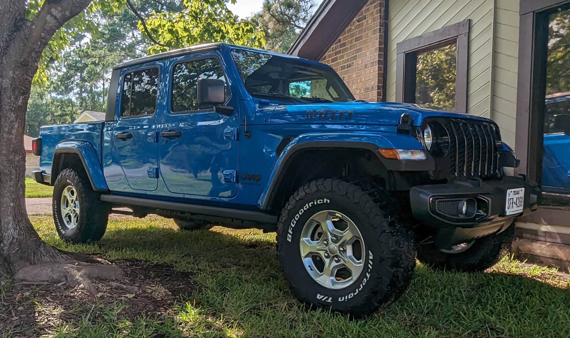

35x12.5x 17 on stock Freedom Edition wheels. They rubbed at full turn on the lower control arms. Not during normal driving. Added 1.5 wheel spacers and no rubbing at all. First 2 pics are without spacers. Last one is with. Willys with narrow axles.
Jeep Gladiator Sport S NON Max Tow - 35's on stock wheels PXL_20230801_010803729
Jeep Gladiator Sport S NON Max Tow - 35's on stock wheels PXL_20230731_220341391~2
Jeep Gladiator Sport S NON Max Tow - 35's on stock wheels PXL_20230814_005039242

Looks good!

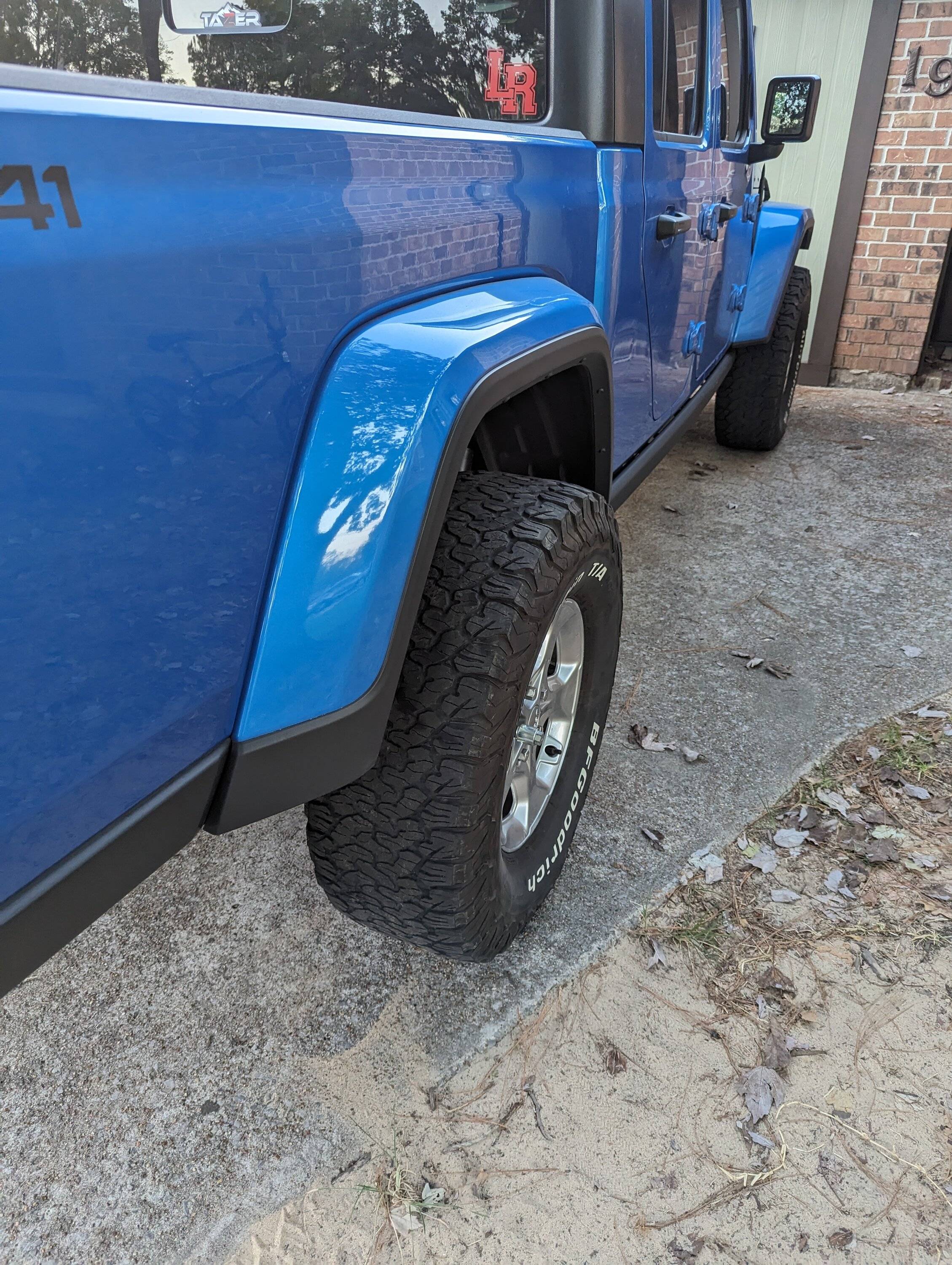

I put 35 12.50 17s on stock Rubicon wheels on the wife’s Sport with Max Tow yesterday. I had bought a set of 1.5” spacers but didn’t install them. No rub with the wider axles. Debating on going ahead and installing the spacers to see what it looks like.

Looks good!
I like the look of a little tire poke.
