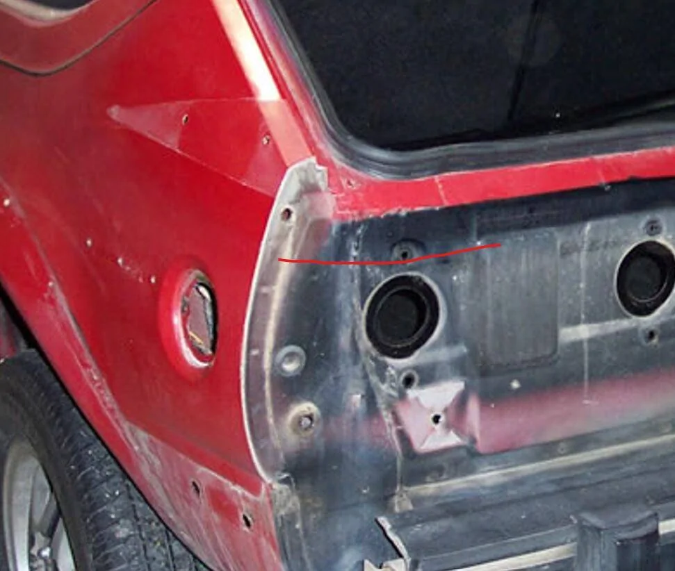

The lead seams took 20-30 years to show signs of corrosion if the paint was in good shape.
I've never seen it, not if the paint was good. It takes moisture for the steel to corrode due to galvanic reaction. So a sealed joint should really never corrode.
Lead is like solder in that way, it seals the steel and if sealed by the paint, and not allowed to be wet, lead seams should last forever. And frankly, of all of the classics and antiques I've dealt with, they actually have - no damage at all.
There was no corrosion on the body of my Eagle other than where the CA sun baked the paint off.
The horizontal surfaces were nasty - paint was gone. But really, it was considered "rust-free".
I would not accept cracked seams on anything under 20 years old. It just should not happen.

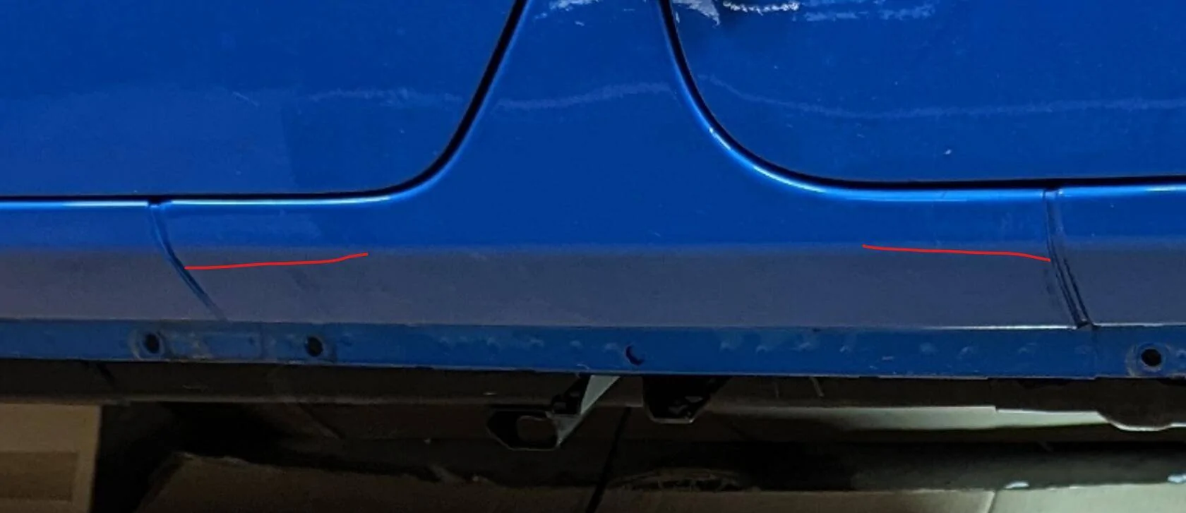

Maybe having the 3M clear wrap on the bottom is a good option to seal it off plus it’s a bit of a rock chip guard. I had this done to mine.
Yes, unless that cracks under the wrap, then the wrap holds moisture in and can make it worse if it cracks.
That should not have cracked. Unless a wrap forms perfectly to the entire surface, including down into those recesses where the sealer is, it isn't going to do much good.
I don't worry about rock chips with the steps on mine.

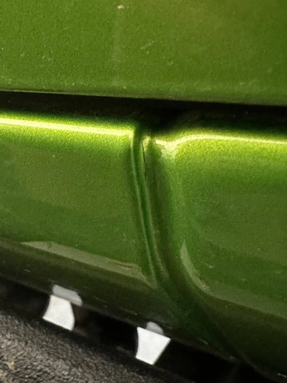

I would just apply some touch paint. Save the hassle and your times.
Thats honestly what im leaning toward. I honestly dont know how they would fix that area without a respray. Id rather just fill in the gaps where its in an area thats not super noticeable anyway. Just so far ive been less than happy with the 2025 compared to the 2020. The only thing ive liked more is the color i have and the update screen size.

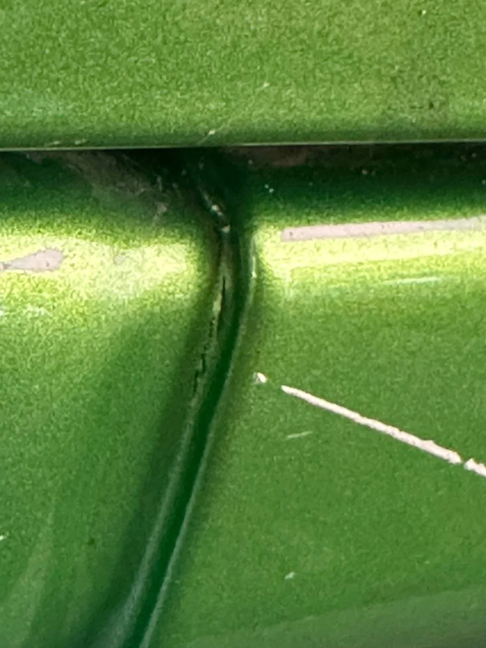

On older trucks I'd worry about moisture collecting, but I guess that's less of an issue with aluminum.
Not really- this isn't anodized stuff.
Your truck, but I'd be all over them. These have warranties, and just putting touch-up paint over cracked paint............ visit my shop and look at some of the stuff I've worked on where someone "touched up"........ and a few years later, the back side rotted away from under the paint repairs.
I guess it depends on if you plan on keeping it very long. If not - go for it, but if you want to keep it, it's at least some risk.

I've got a crack there on the passenger side of my '22 Gobi. Didn't notice it until my last wheeling trip where I had it all twisted up. Might have been there before. Maybe the chassis flex was the last bit that pushed it over. Either way I crushed the rocker into the body on the other side so I'll just touch it up.
I've already decided no more winters for the girl.
