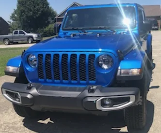

Has anyone successfully converted a halogen Sport S (non max tow) to LED headlights and fender DRLs? Is there a link to a thread that already exists of this happening? Also, I've seen mopar is selling the OEM headlights, but where can you buy the fender drl/turn signals?
You'll need new fenders, lights, and harness leads because you don't have the DRL plug. IMO I'd just do the headlights (buy the kit, not individual and it's cheaper) and an Oracle LED bulb for the turn signals if you want to keep it remotely affordable.
That may not be completely true. I think if you have a Sport S with the painted fenders, you have the DRLs already installed.
