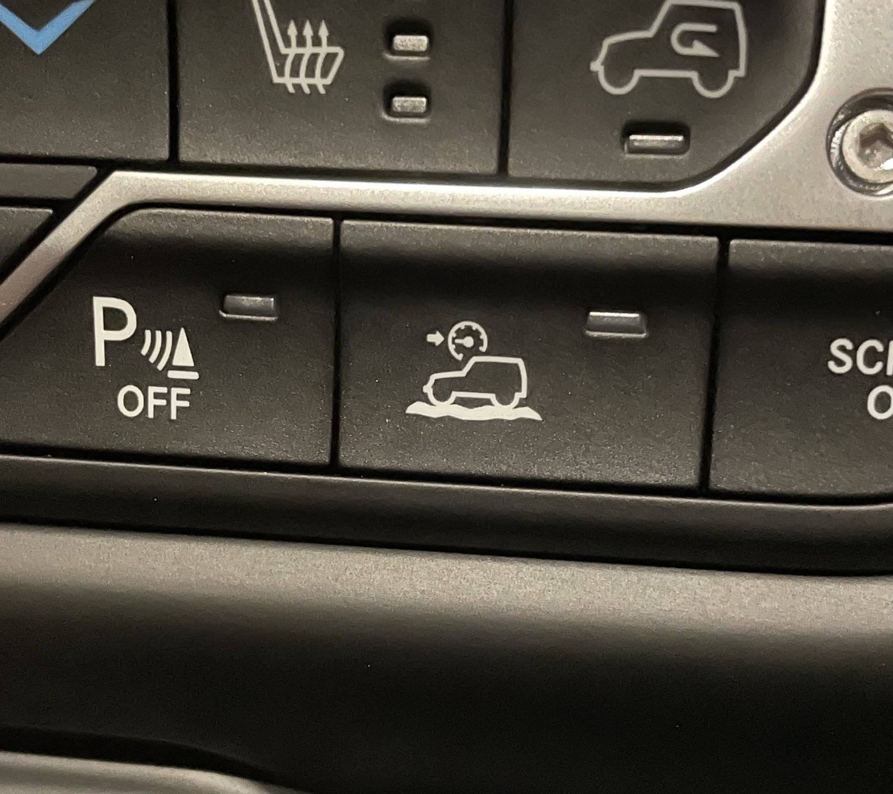

Sounds like you were using Selec Speed Control perhaps by accident? It's this button right here:
Jeep Gladiator Off Road Plus Noisy dc177887-27be-4160-ad0c-4d941a3221df-jpe
You shift over into manual and then set the speed anywhere from 0.6-5mph. (Shows near the top of the middle of the instrument cluster.) The idea is you can use it when you need steady inputs when going up or down an obstacle. Part of that is that it can control each wheel brake and that's the noise you are probably hearing. I've used it a handful of times, really handy downhill but can get jerky sometimes using it going up. Very nice to focus on steering and not have to worry about power management.
Offroad + changes throttle response mainly along with some traction changes. It won't make any sounds.

Thanks all.
I was using the selec speed, so I suppose it’s normal for the mode I was in.
