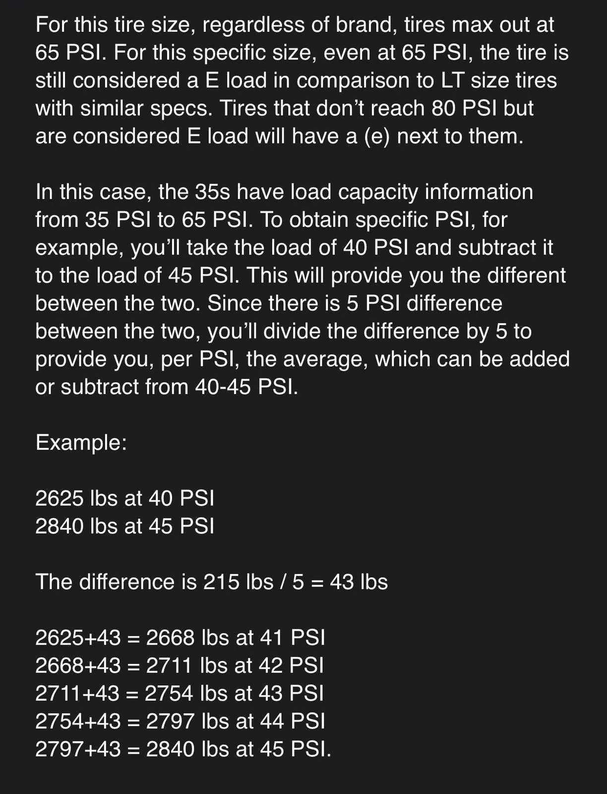

I'll be upgrading to 35x12.50x17 Falken MT01 tires, E-load. I'm thinking of going down to 20psi when I wheel. Their website has the following info for the size
Tire Size Usage Load Range C Load Range D Load Range E
35 40 45 50 55 60 65 70 75 80
35x12.50R17LT Single2405 (C) 2625 28403000
(D)
3065 3130 3195
(E)
LT255/75R17Single1870205522302405 (C)
Edit: see Falken’s response below
Edit: I deleted exactly what Falken's response confirmed.
For my 255s, there is a 175-185 loss in load per 5psi. So at 25psi I would be at 1600lbs per tire, which is 6400lbs. At 20psi I am at 5600lbs on the 4 tires. I don't think I ever got below 22psi so still good.
For the 37s there seems to be a drastic drop in load capacity at 45psi, dropping 215-220lbs per 5psi. So at 25psi I should be at 1965lbs per tire, at 20psi I'm at 1745lbs per tire, and at 15psi I'm at 1525lbs per tire. So 15psi is as low I could go, on the road, that is. Someone explained it as posted below

I was completely wrong on how to calculate the that. From Falken

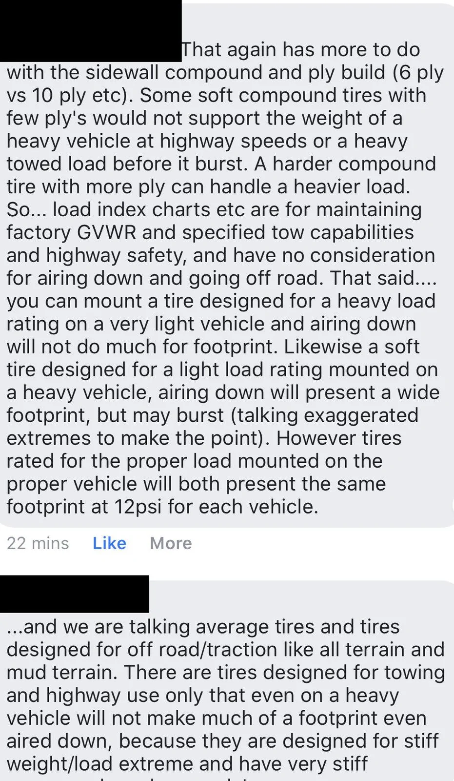

Seems like a good explanation. Essentially load considerations go out the window when slow off roading ?

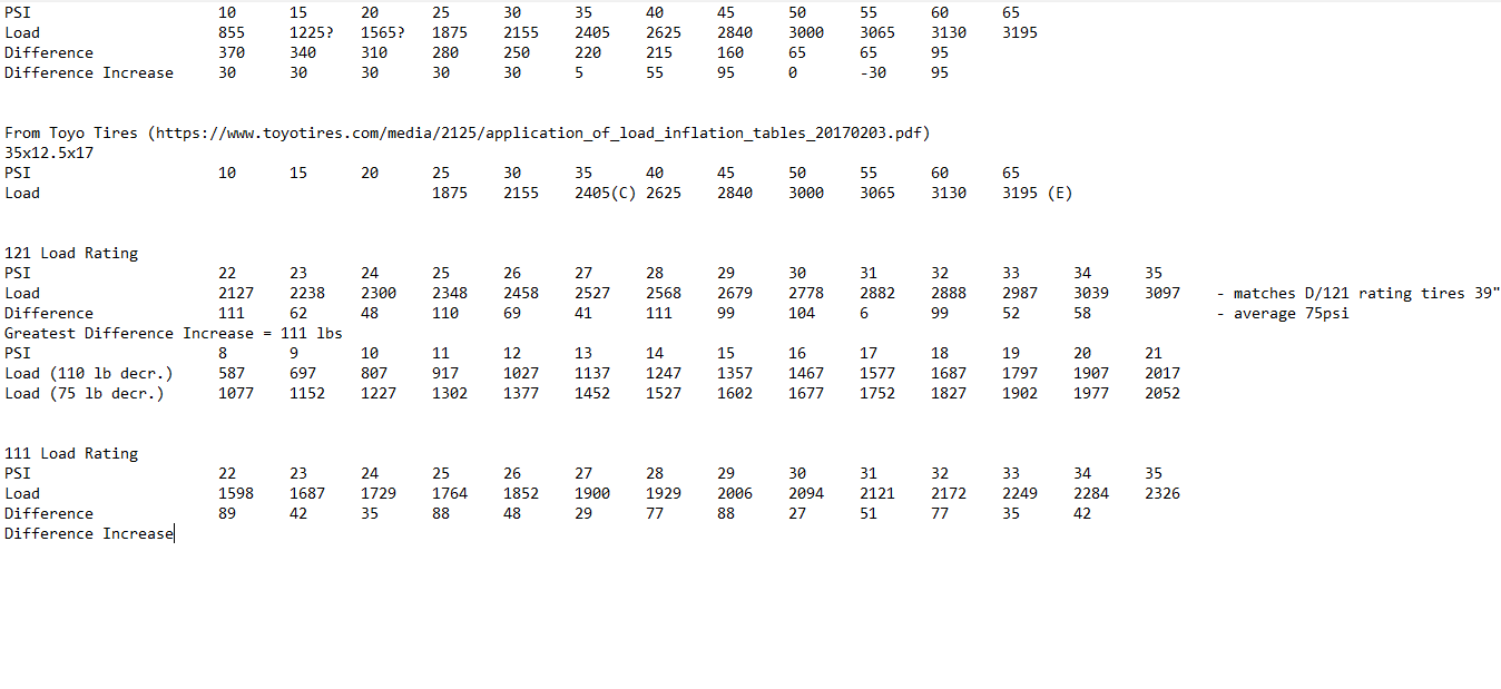

Just for more reference I came up with the following for my upcoming Falken MT01 35x12.5x17 tires
Blank spots means no data was provided. "?" by the number means my estimate.
My conclusion for my own purposes: I can go as low as 15psi and still maintain my vehicle's weight with gear and occupants while off-roading, highways speeds I generally gain 3psi so it will go up to around 20.
