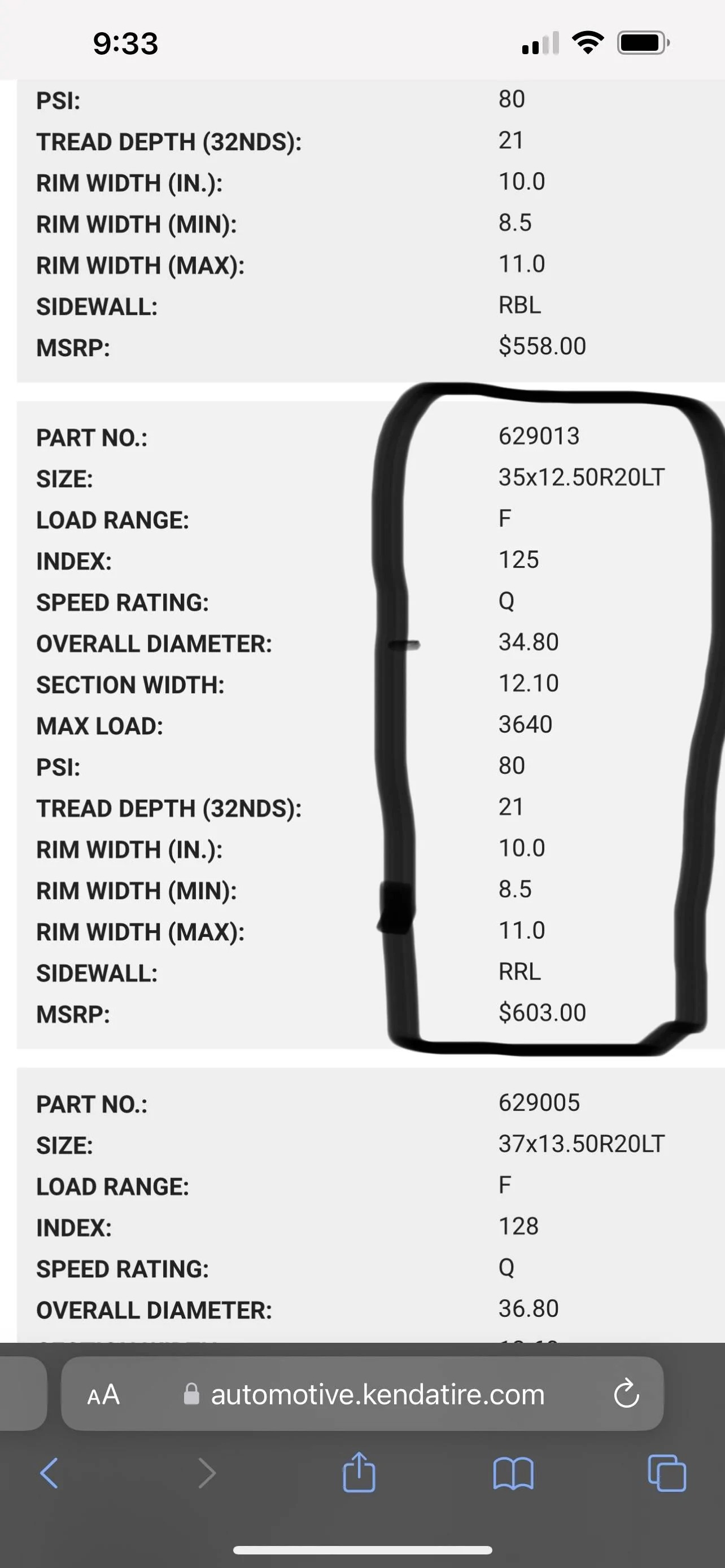

Anyone have a link to these charts that discuss PSI at various weights?

yeah I thought about that immediately after posting. I'm sure a lot depends on individual tire manufacturers also. Mickey suggests to just call them - which I probably will do once getting new shoes. I had thought there might be a general chart somewhere but theres too many variables.

Curious I don’t want to sound crazy but do you count the weight of the truck itself or just the payload ?

Weight of the truck PLUS payload. Tire weight ratings are TOTAL weight. But remember to divide the front/rear axle weight in half. Best practice is to load up and head to a scale and see what each axle weight is. Then use that chart.

I called and talked to a customer engineer type with General who asked the size of the tire, the weight of my truck and so on - and told me a range for my truck. And so far, so good. Nice ride, even wear, good traction.
